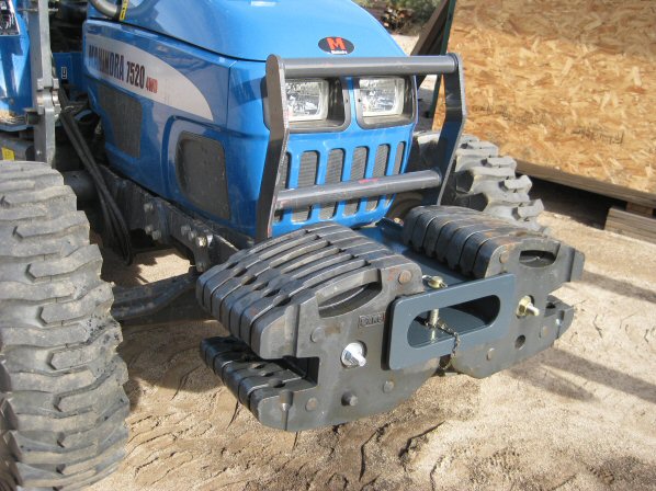

I've been running all 4 tires filled on my 75hp tractor for 9 years and on my 32hp tractor for 8 years. No bad effects of any kind that I have noticed.
If this was truly a concern, how is it that most of us have loaders on our tractors and no one talks about all the additional wear from that extra weight or as you guys have mentioned, front end weights? I personally also doubled the front end weight capacity on my tractor and it is still by far less weight than what the loader is, although some of the loader weight is transferred to the rear of the tractor.;)

Brian, that is a serious weight bracket on that 75 hp!!! Is that aftermarket? Are those 100 lb. ea.?

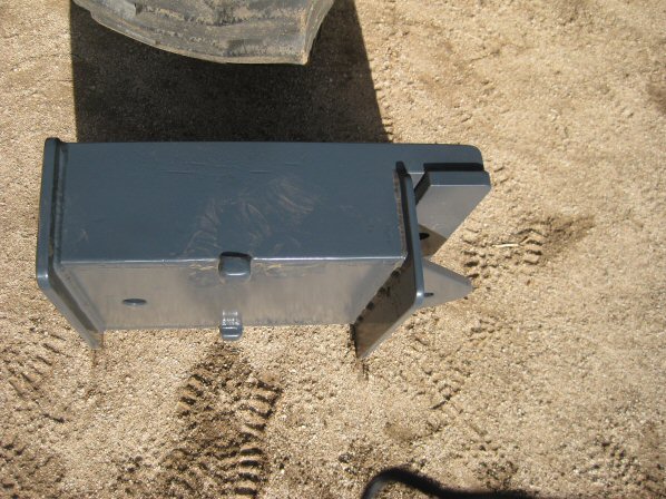

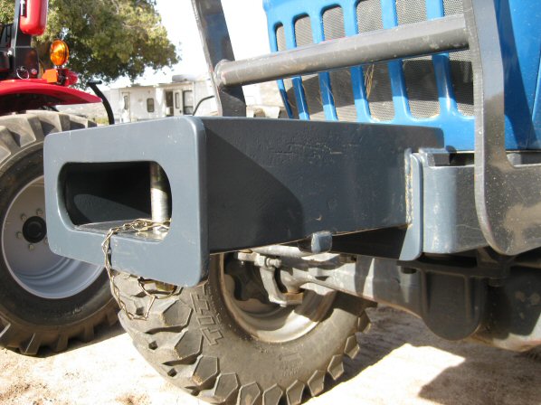

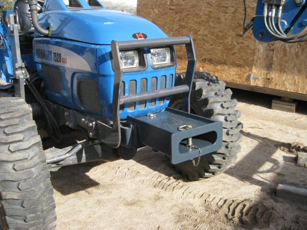

No, I built the weight bracket, weighs around 100+lbs and will hold double the recommended amount of weights. Bracket just hangs on the OEM bracket, drop a pin in and it is locked in place. Install the weights in the same manner as when OEM, install the pin and everything is locked in place. Very simple and easy.
Honestly, I don't even remember what each weight weighs, less than 100lbs though. I know that I sure do prefer to do my field work (disking) without the loader on there. Tractor acts and handles like a sports car without that loader. :cool:
