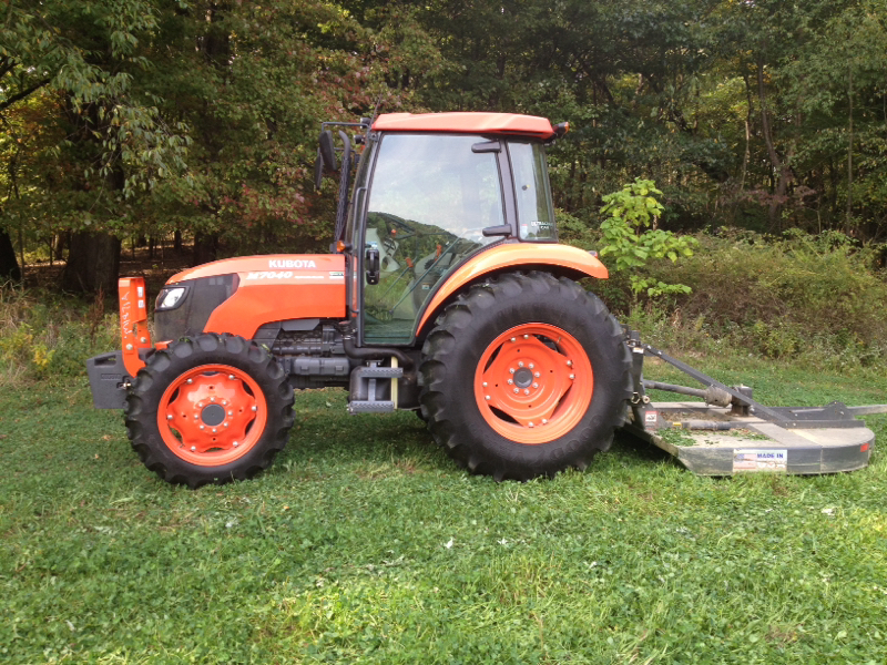

I've put about 11 hours in it so far. 7 pulling a no-till drill and 4 mowing. I continue to be impressed with this machine. With the rear tires set out to 78.5" it handles side slopes very well. No shortage of power...pulled the 2000 lb drill up a mountain in high range, 1st gear. The cab is roomy and comfortable but could use more places to put things. But, I figured out fairly quickly that my L5740 HSTC is a better choice for mowing. It's like a cat vs. a brama bull.

By the way, I also wanted to mention that I had to travel 2.5 miles on the highway to get to the mowing job and I did not experience any irregular handling or problems turning and stopping due to the front tire ballast.

That mower looks very small behind the big machine. Enjoy.
