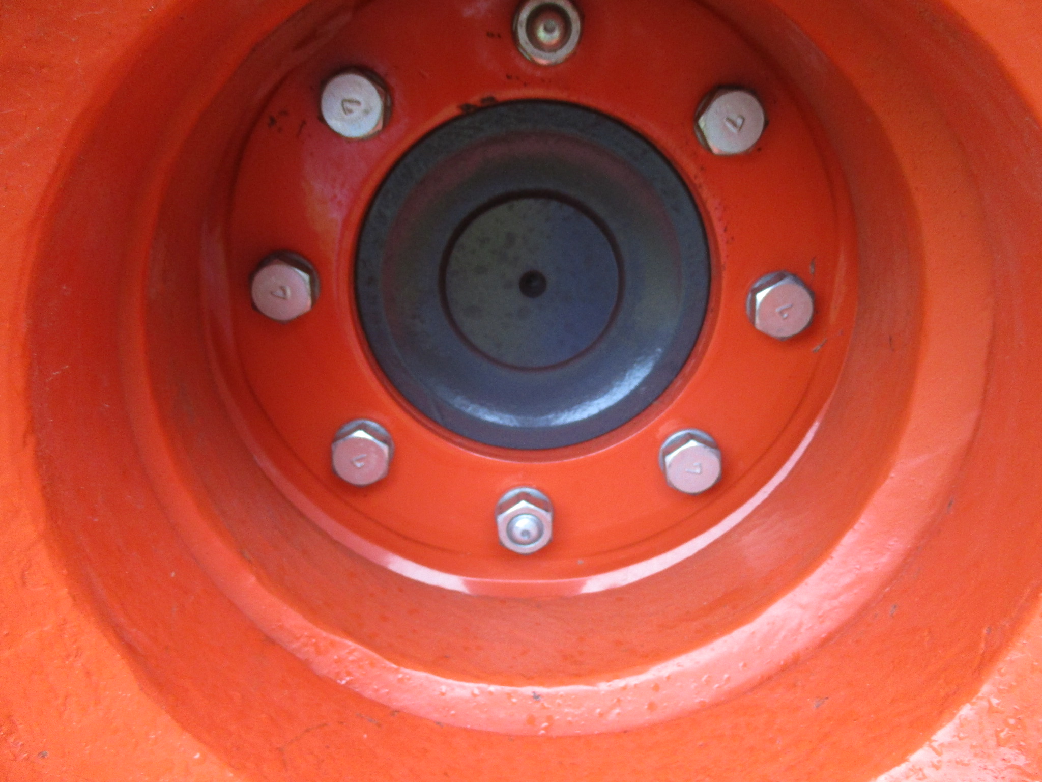

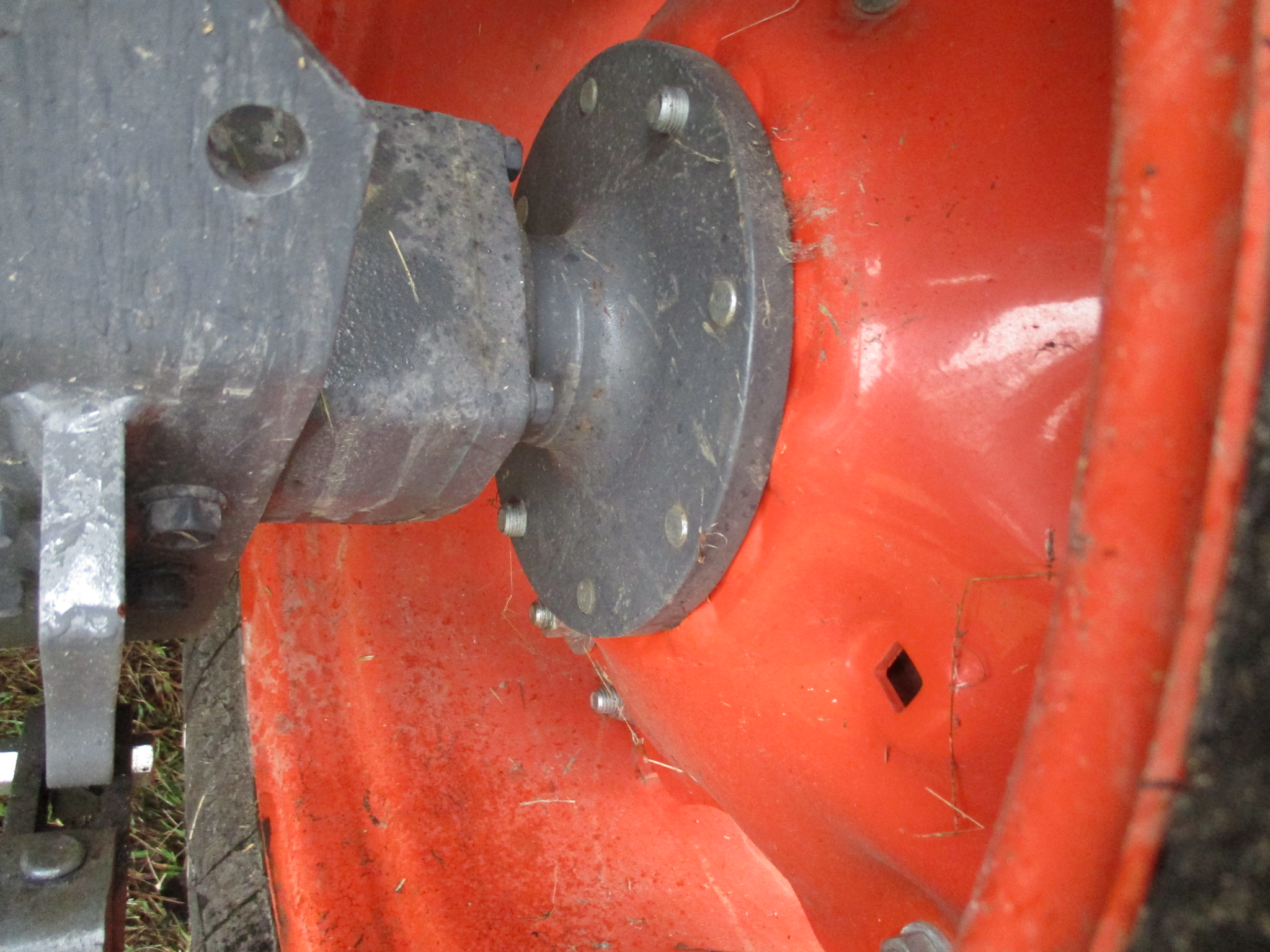

   / Kubota M9960 Rides Rough Please Help #54
How are your wheels set up width wise? I have a JD 5520 that I felt was bouncing me out of the seat. The wheels were set to the narrowest setting when delivered. I widened both front and rears by about 6" and the ride improved dramatically. Might be worth a try.
   / Kubota M9960 Rides Rough Please Help #55
Good point that is often overlooked. Lost track of how many Utility tractors I see with wheels all the way in. Really aggravates the ride.
   / Kubota M9960 Rides Rough Please Help #56
hmmmm, now that's going to make me look at mine this morning as i hike in the rain to the barn. I never saw much extra axle in there...

The L owners can verify this, but, I believe your rear wheels are two piece? Meaning the pieces can be separated and rearranged to change the width of your footprint.
The larger M series are designed with as many as six different width configurations on the rear and front.
Manufacturers almost always ship tractors in the narrowest configuration for obvious reasons. My local Kubota dealer sells them all that way unless the buyer requests a change. Rarely is that requested, and, around here most buyers never make a change.
It was one of the first things I did to my M9540. I work in steep terrain a lot.

While most Ag tire wheels are adjustable for width. It's a toss up whether R4 wheels will be adjustable.
   / Kubota M9960 Rides Rough Please Help #59
Yep, most times R4 wheels are not. Guess I didn't ask, but just assumed the OP's wheels are adjustable since he's in a larger Utility chassis rather than a CUT chassis.
   / Kubota M9960 Rides Rough Please Help #60
I don't think there is any adjustability here.
