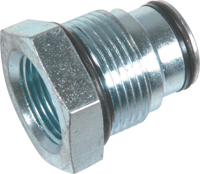

The PB port usually has a adapter fitting or a hex screw. I believe your PB has an adapter. If you remove it, it should look like this.
Open center valves usually have a relief valve, and the IN port is usually close to the relief valve.
Sometimes you can use air to ID the ports.
Sometimes you also have two IN ports and two tank/return ports.
