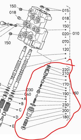

Out of the 4 LA1002 FEL variations only 2 are for model M6800 tractors. Both loader valves I looked at had relief valves listed on the valve component pages. Photo of RV is later FEL serial number. What's the serial number of loader in question?

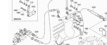

I was replying about a LA1002 loader not a TL421 such as jasong123 has. IMHO Kubota parts schematics are the most difficult schematics I've ever tried to look at. I did not see a shut off valve on the FEL(LA1002) control valve for a M6800 but I'll look again. UPDATE: I still can't locate a shutoff valve for a LA1002 FEL valve. Were you looking at Kubota parts or somewhere else? Here's a schematic for the hyd block for attaching LA1002 on a M6800

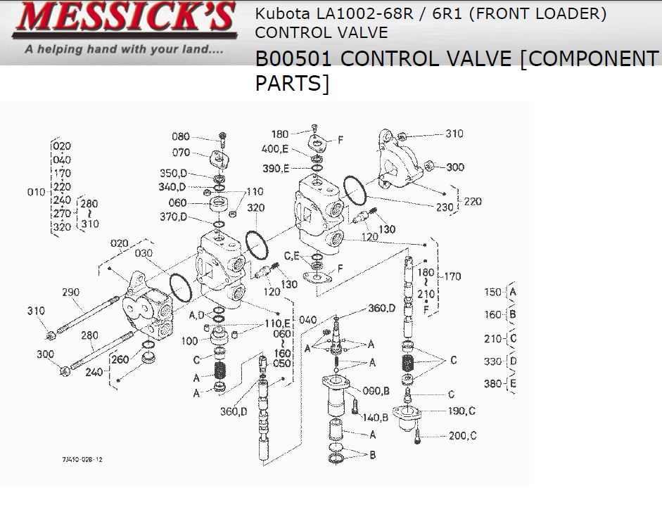

Look up loader LA 1002 -68R/6R1 control valve
Definitely a shut off valve.
Item 130
   / Kubota mixup ?? on Pump Line hose and Power Beyond Line hose installation to loader #35
OK but 120 that 130 is included into states it's a load check valve on the page I viewed. To make any good judgments one needs the FEL serial number.

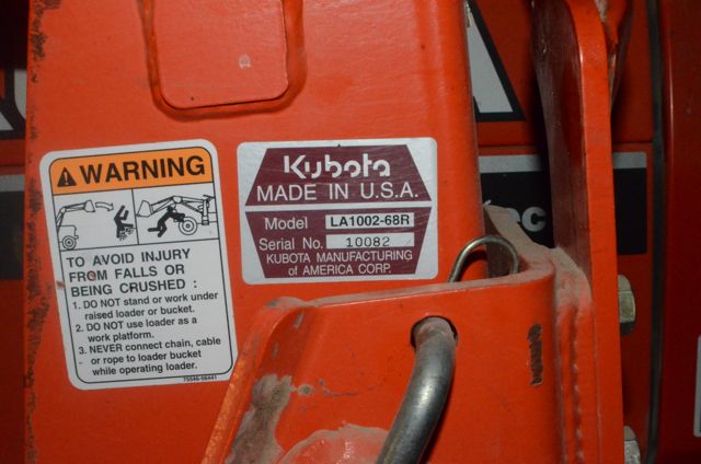

Here is the p/n and s/n of the Loader on my M6800 tractor. LA1002-68R S/N 10082

I looked at the PDF for your loader, and it does not have a relief valve, but does have a shut off valve.
Item 130 in the PDF for the LA 1002 68R

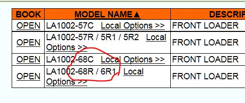

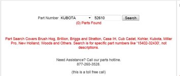

According to Messicks 52610 isn't the complete part number. Most Kubota part numbers have 10 or more digits. Can you post the PDF that you're viewing? What type closed center system have you seen with a shut off valve and a power beyond plug as I can't think of any JD's I been around with those items??
Thanks,Jim

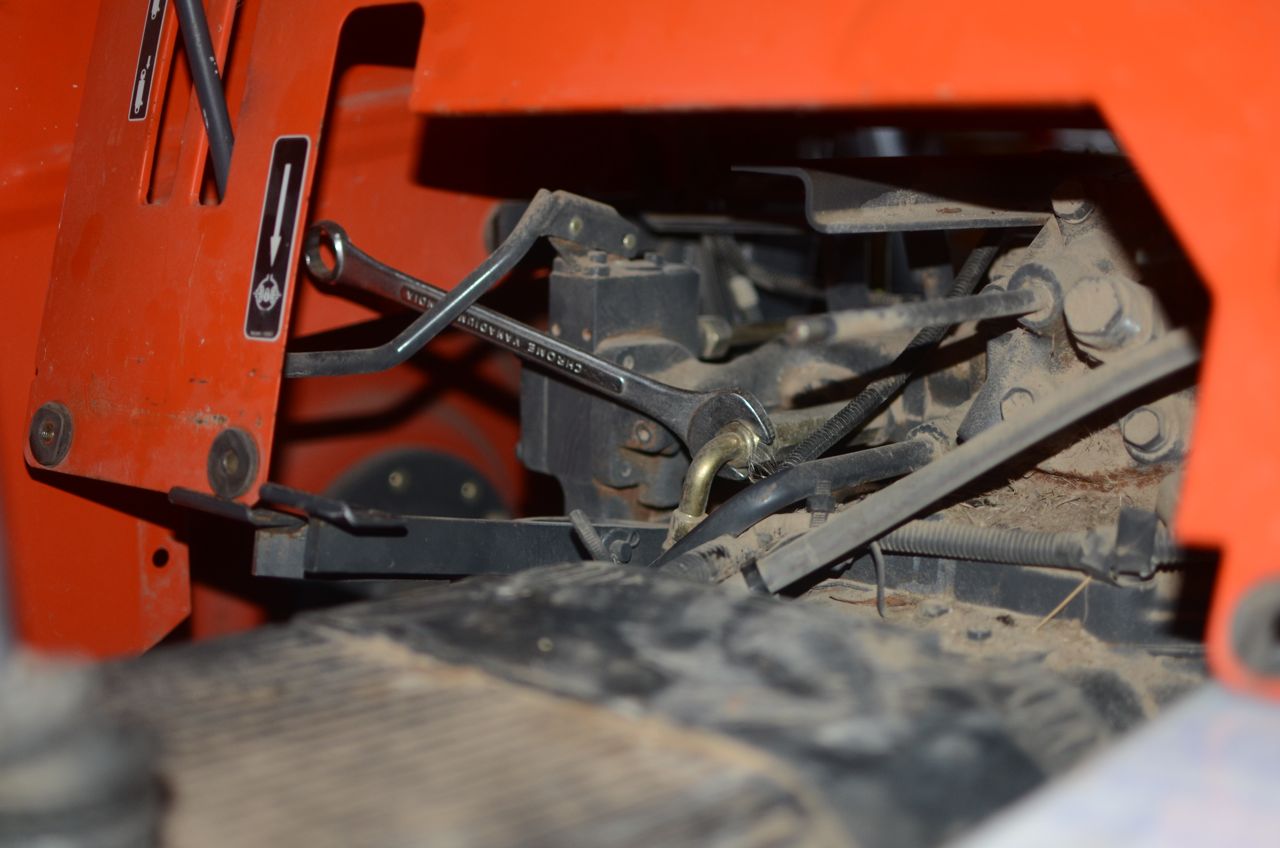

Sorry, JJ. I didn't remember you ever asking for the loader number and s/n. I did look it up on Messicks and it is confusing, but if you know to go to the B001606 version, then they call the entire assembly that shows in my first picture "a hydraulic block" (the one with the wrench on it).
The picture on Messicks e-mail does show all three hoses and where they go, but does not identify them as power/beyond, pressure, or return. I believe I have all three hoses connected correctly now. I do know a little about hydraulics, having designed and installed a rotary hydraulic actuator that was used on test aircraft to flutter surfaces to determine the aircraft stability.
It was more difficult than it should have been to simply determine if the hoses were connected properly even though the Kubota documentation was obviously incorrect.
I am still unsure of what should have happened if the pump hose to the loader and the power beyond hose were reversed as shown in the Kubota installation manual. For me, it just didn't work that way.
Thanks again to all who contributed to this thread.

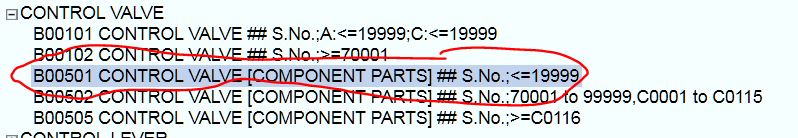

According to FEL serial number(LA1002-68R S/N 10082) outlined in red the valve in photo is the correct valve with no shut off valve listed.
