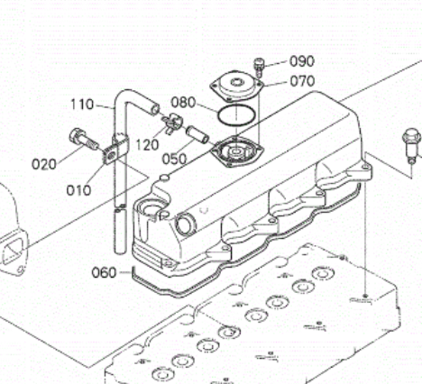

Kubota mx5000 low hours 200,all of a sudden blows the oil cap off after a few minutes of running, thinking maybe crankcase breather not working but can't find it, can anyone help!

If it has one, they will generally be attached at the valve cover at a high point. It may steel or rubber or a combination of the two and routed in a downward location. These are a prime mud dauber habitat on unused/infrequently used tractors.
On newer engines, there may be a PCV valve and hose routed from the valve cover and connected to the intake after the filter. Excess crankcase pressure might indicate a clogged PCV valve or pinched (collapsed) hose.

With only 200 hrs of use I'd be checking breather tube & breather to determine that they're not clogged.

Engine or transmission? Common rail or mechanically injected? That will determine which crankcase breather arrangement you have. Far as the gearbox goes, the breather hose is on top of the gearbox in front of the 3 point upper arm rockshaft.

Thanks for your imput,in the diagram it looks like a pvc valve in the hose coming of the valve cover, is that correct?
   / kubota mx5000 blows oil cap off #9
Yes and no. If the motor is Pre Tier 4, all there is, is the hose with nothing in it, it vents to atmosphere. If the engine is Post 4 which is common rail, the hose is routed to a PCV valve and then to the DPF.
On a Pre 4 engine, there is nothing inside the valve cover to clog up and not allow the blowby vapor to exit via the hose. Had my valve cover off recently to adjust the valve train.

Mine is a 2005 would it be post 4?
