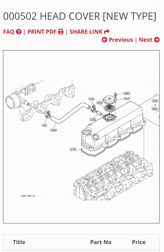

If your hose runs to the intake than this should be your setup. Number 50 should be your valve. Parts list shows a couple superceded numbers.

If that was my setup, I'd remove the PCV valve entirely and route the hose down the side of the engine and be done with it.. and block off the fitting in the air intake. Sure sounds like a gummed up PCV valve to me.

Mine has a hose coming out of the valve cover and into the intake manifold, but I don't see a PCV valve
