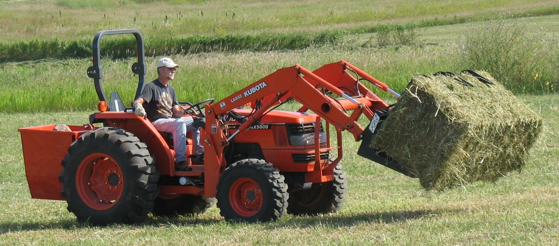

Are you getting a FEL with the tractor? Get the ballast box so you can counter weight all the work you do with the FEL. My MX5000 did a great job with 800 lb large square bales.

I have an MX5100 but I'm selling it (upgraded to a M7040 to make large round bales). The 5100 will move round bales just fine, but make sure you've got at least 500lbs + of ballast on the rear otherwise you'll be bouncing around. Ballast boxes/barrels are easy to make (under $50), don't bother buying an actual ballast box from the dealer, it's a waste of money.
