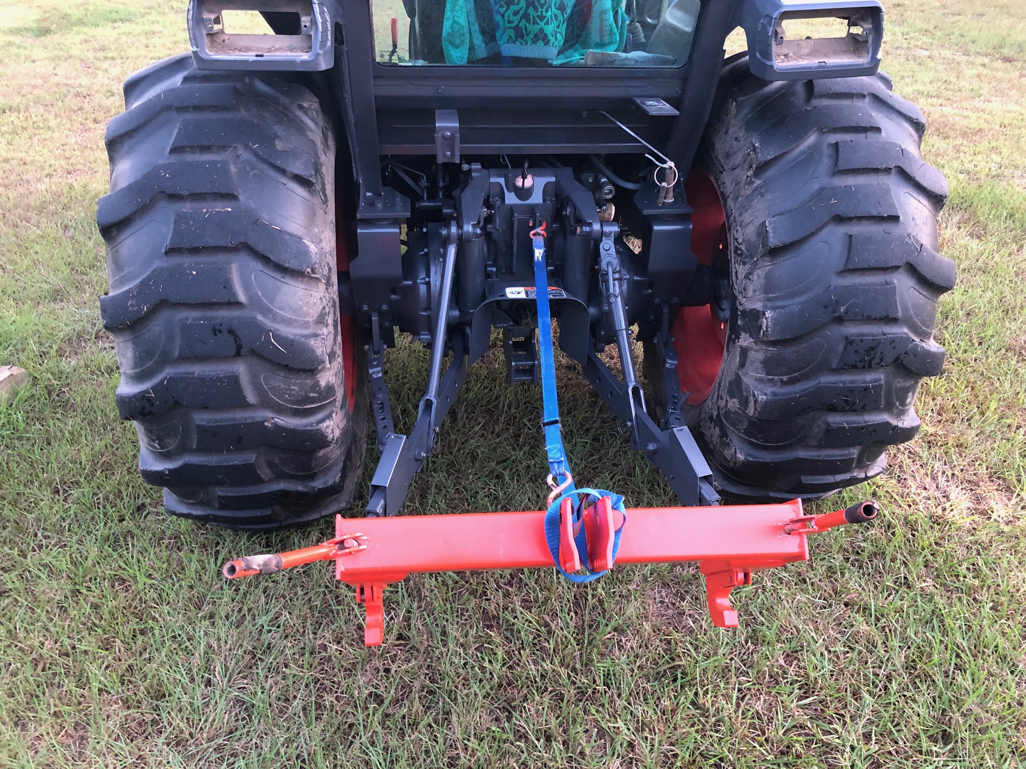

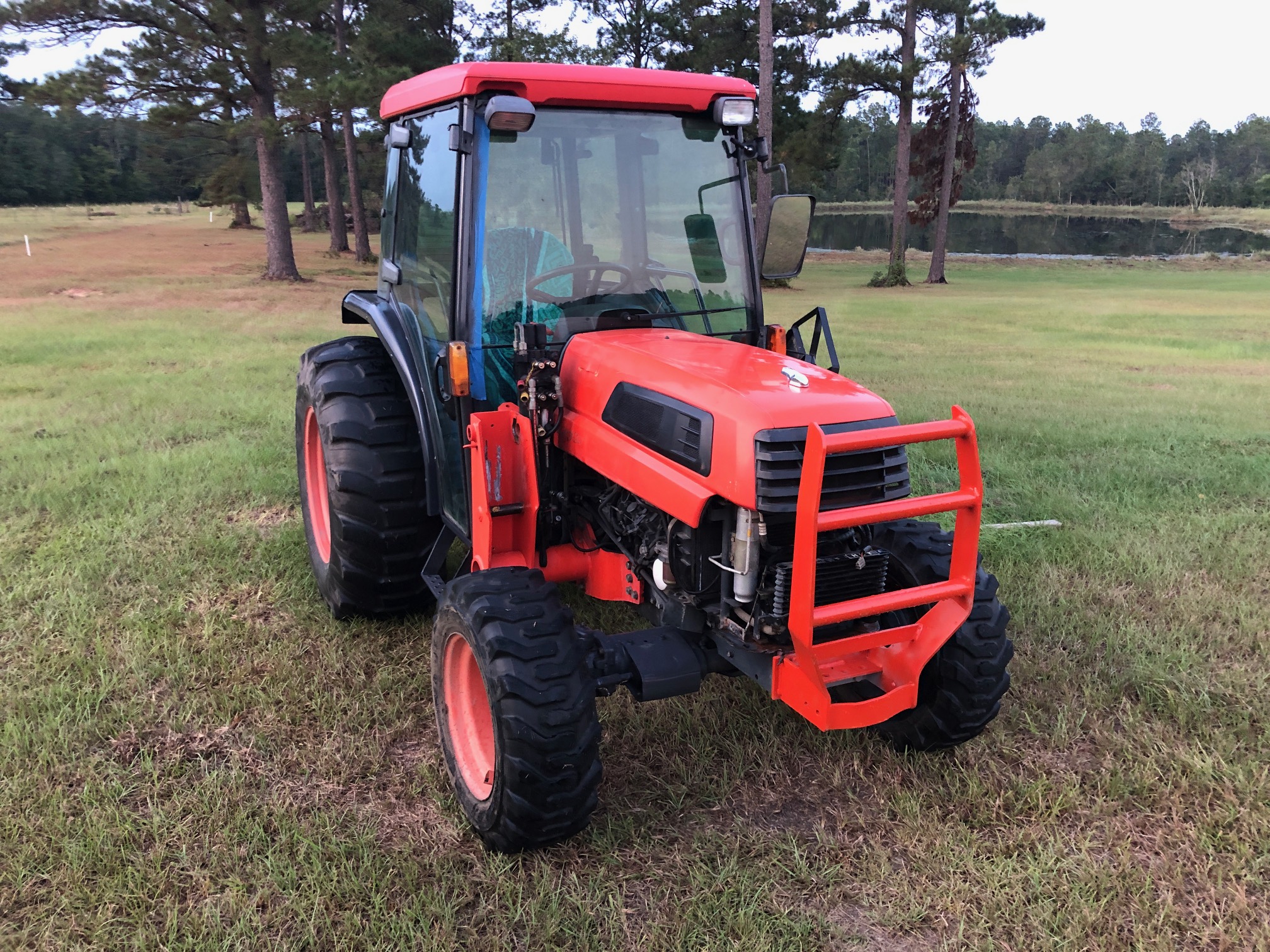

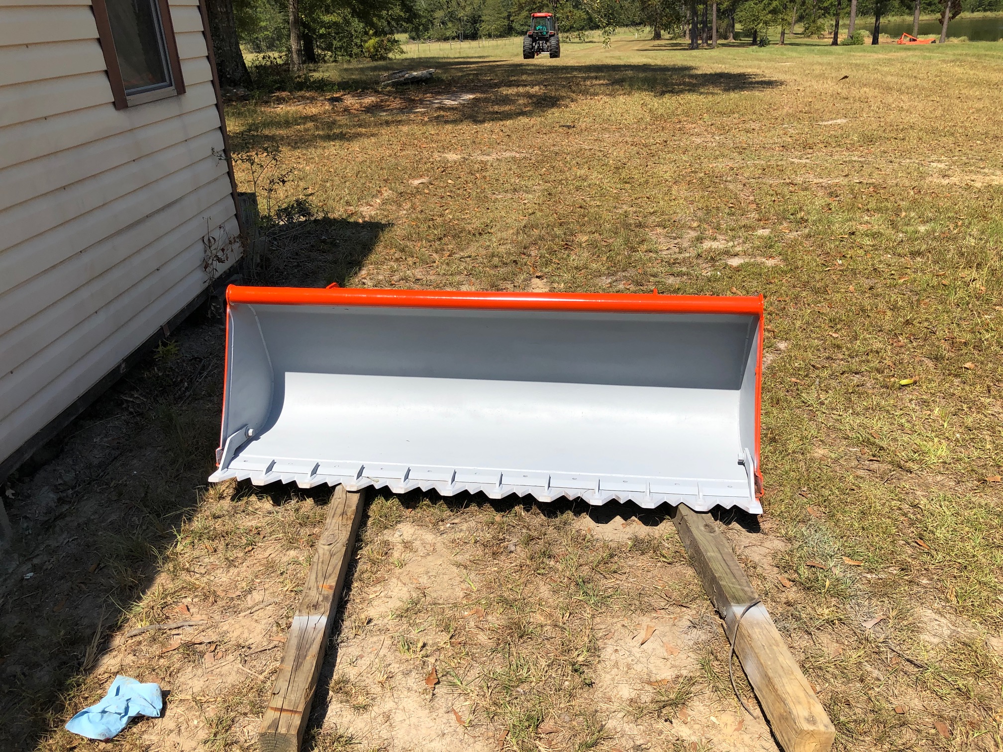

Any one try the TSC Magic kubota orange paint? I got a gallon to try on both of my pieces of equipment. I have usualy sprayed rustoleum oil based through my purple HF hvlp gun and wanted to try a different brand.
Im looking more for a preservation finish rather than a show room quality. How ever i have sprayed a few metal cabinets that came out very nice.
