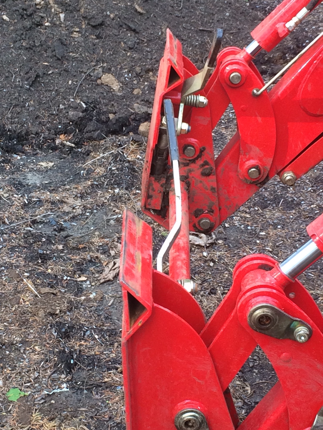

It is difficult to get the FEL QA pins to fit properly in the slots at the bottom of the QA frame on the back of the Construction Attachments 4N1 bucket we bought with our Kubota MX5800. We get the pins to fit by bouncing the bucket up and down some with the FEL. The FEL QA works fine with our other attachments for the FEL (forks and grapple). The FEL QA frame is not out of alignment. It appears that the slots at the top of the QA frame on the back of the bucket are a little smaller and therefore tighter than the corresponding slots on the other attachments. Bouncing the bucket some causes the fittings on the top of the FEL QA frame to fit snugly all the way up into the slots on the back of the bucket. The weight of the bucket alone is not sufficient to get the snug fit at the top of the QA that is required for the pins to fit into their slots.
   / Kubota Quick attach bucket/forks problem #13
No...that torque tube is designed to give up and twist before you do more serious damage to the loader. It happens when you catch the corner of the bucket as an example on a root and lift up. In my case I caught the quick attach handle on a limb using a grapple, lifted, grapple came loose on one side only and twisted the torque tube.
It's the torque tube that ties the two loader arms together. I put up with it got it aligned better by pushing against a tree on the plate on the arms without an attachment on. Eventually tired of the problem. Cut the torque tube, repositioned so the plates where square, welded back and problem gone.
A twisted QA torque tube is not serious damage, it's a minor tweak.
The dealer is wrong about the hydraulics. The cylinders are plumbed together and and free to move separately if removed from the loader.
I have experienced this with a B2650 and now my L3910. Yep, if you let one of those levers lift and let one side pop off and don't notice and continue putting pressure on the FEL attachmnet then it will twist that metal tube between the two SSQA attachment plates and then they will not be on the same plane/angle and reattaching the FEL implement will be extremely difficult to impossible. I returned my Kubotas to Barlows who straightened the "tube" and back to quick attach. Steve Barlow told me to quit operating the FEL with one side not connected :) :) .I told him Kubota needed a stronger tube and he told me they would not be able to straighten a stronger tube and would have to replace it so more cost to reair when someone like me bends it. :) :) :) It is an issue to be aware of especially if you have a grapple where limbs and "stuff" can come thru and lift that lever so be aware and keep an eye on the lever and both attaching points and STOP if it come loose and reconnect both attachment plates.
I don't weld so cutting and welding back isn't an option for me.
   / Kubota Quick attach bucket/forks problem #14
Dealer wants you to drain oil so he can sell you some more oil BUT that won't repair problem. Definitely the torque tube(timing rod) between the bucket/forks QA mounting pads is loose or twisted allowing 1 cyl rod to extend further than other rod. Placing long cyl rod QA pad against a tree to even up rods is a good idea
   / Kubota Quick attach bucket/forks problem #15
Pushing the QA against something to straighten it might work, but I'm betting it will be difficult to get them exactly even.
Easiest/fastest IMO would be to cut the tube, put the bucket on to align the QA plates. Re weld the tube
   / Kubota Quick attach bucket/forks problem #16
I bent my loader when I didn't have the bucket racheted down on one side. It was impossible to lock down anything on the plate. I took it to the dealer and they twisted it back into alignment better than it ever was (and the reason the bucket wasn't properly locked down the first time). I asked how they did it and the service manager said they chained the ''low' corner to a stout post and used the loader hydraulics to bend it back.
   / Kubota Quick attach bucket/forks problem #17
Here is a good thread on one that was bent pretty bad, but you can really see what is wrong in these pics.
http://www.tractorbynet.com/forums/parts-repairs/356289-crud-what-did-i-break.html IMG_0219.JPG
   / Kubota Quick attach bucket/forks problem #19
All but a certainty that the QA device is twisted. The dealer comment about the hydraulics is based in ignorance.
RickB is exactly correct. The hydraulic comments by the dealer are just that -- ignorance. I had the same issue with a MF2660 larger tractor using a DL250 loader with an skid-steer adapter from the factory. I use a 4-in-1 bucket that weighs a little over 1000lbs. Can't see the lips from the drivers seat. So if you catch the lip of the bucket on one side, fail to catch it on the other side and then lift the bucket and go off trying to do things you bend the connector shaft between the left and right halves of the loader adapter. This is VERY common. In my case the connector cross bar was so badly twisted I simply replaced it. In your case I would EITHER straighten the connector bar or replace it. For heavens sake don't go doing exploratory welding !
