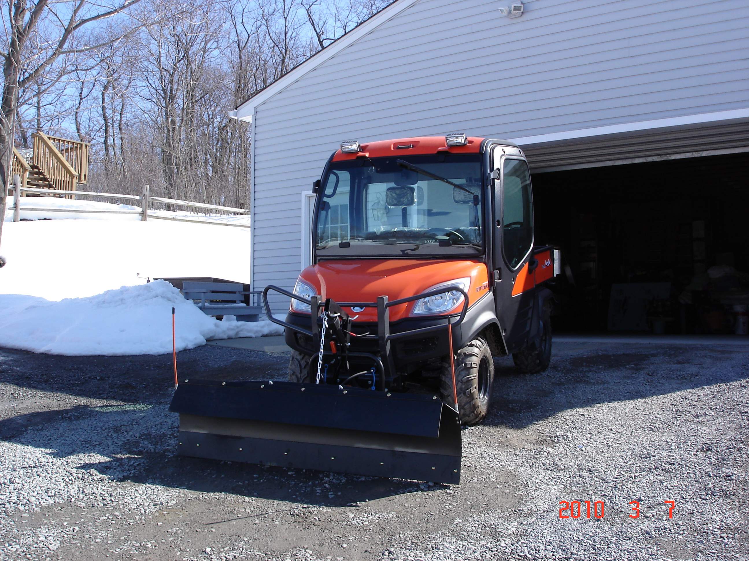

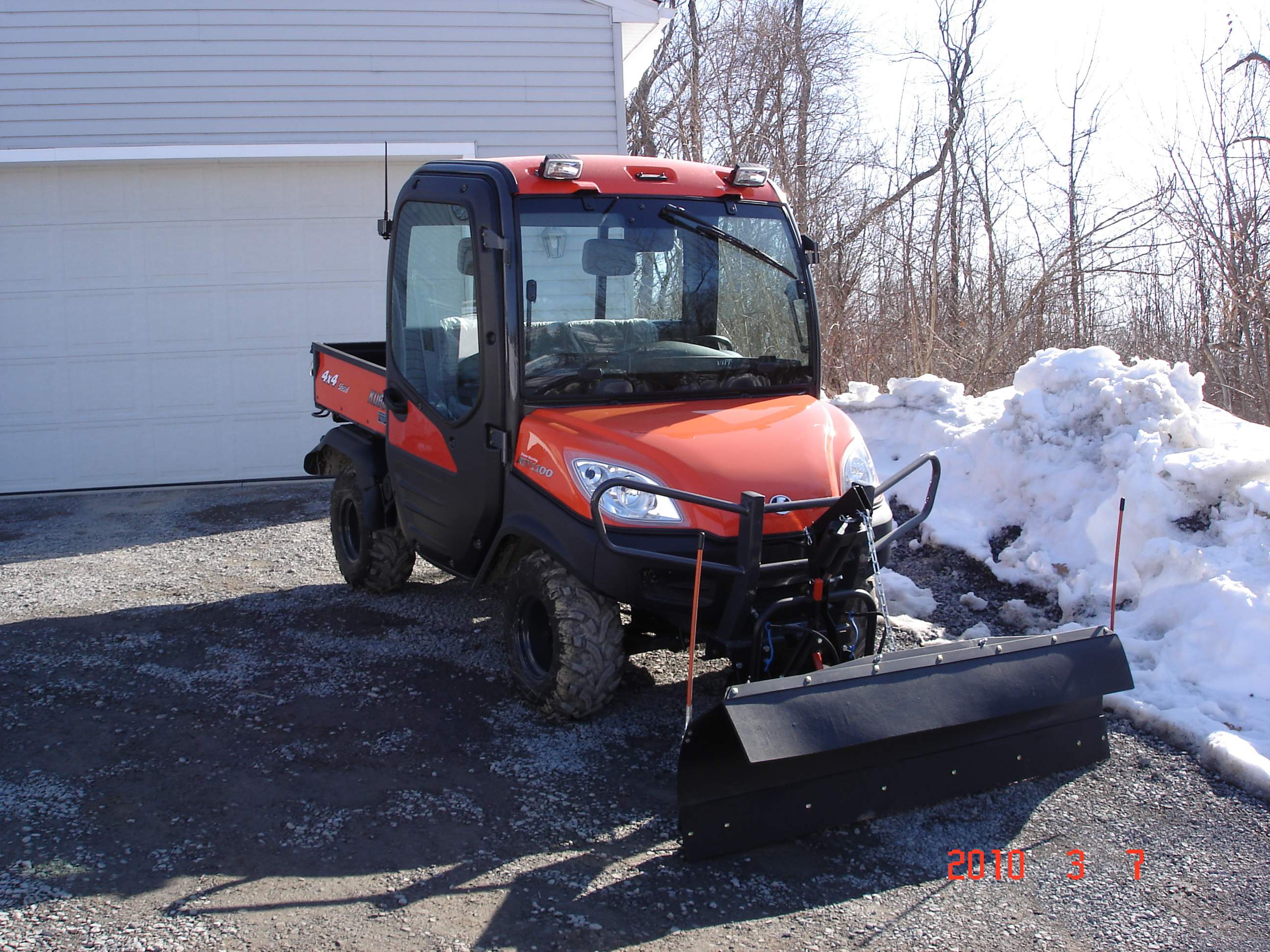

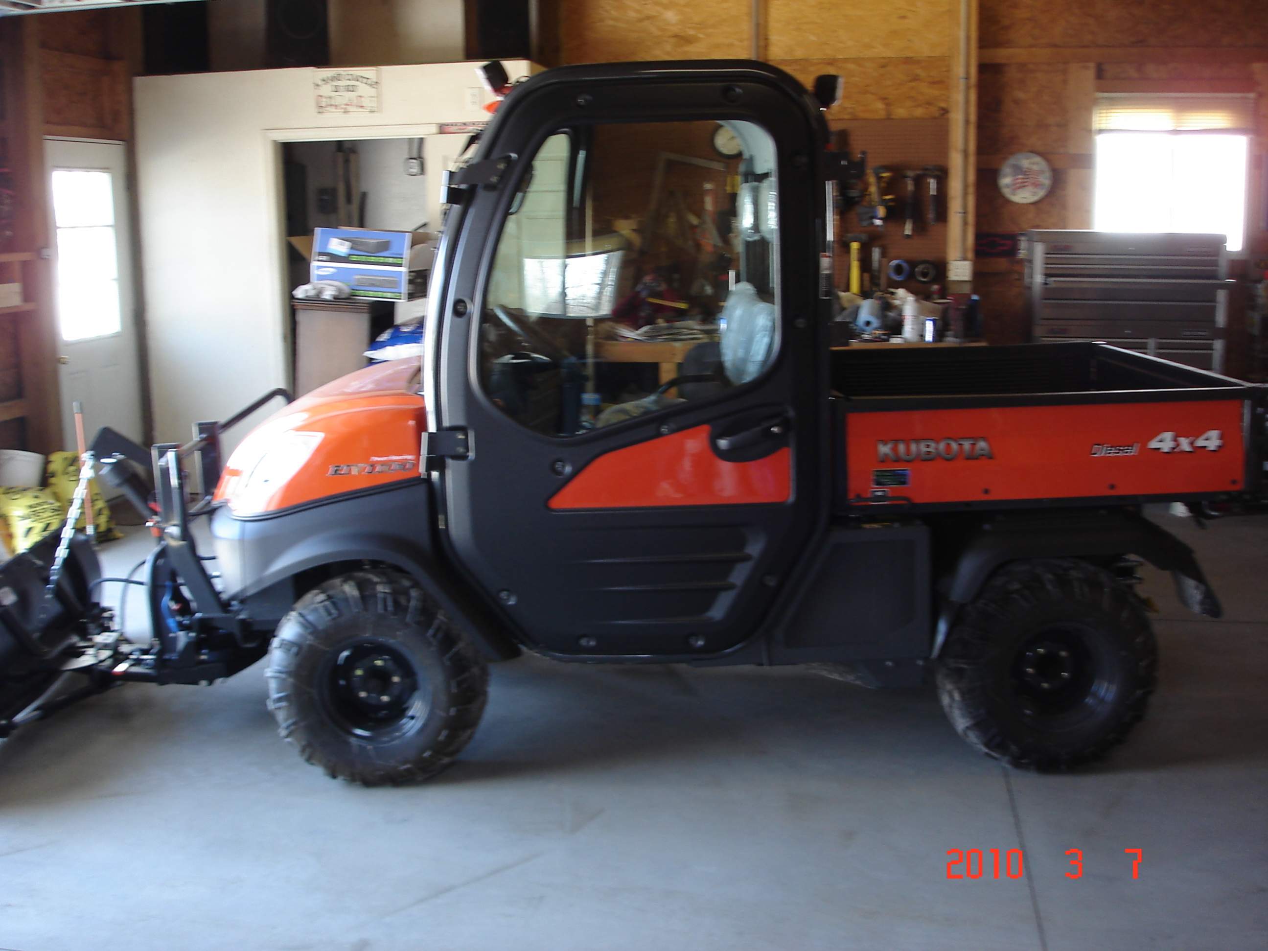

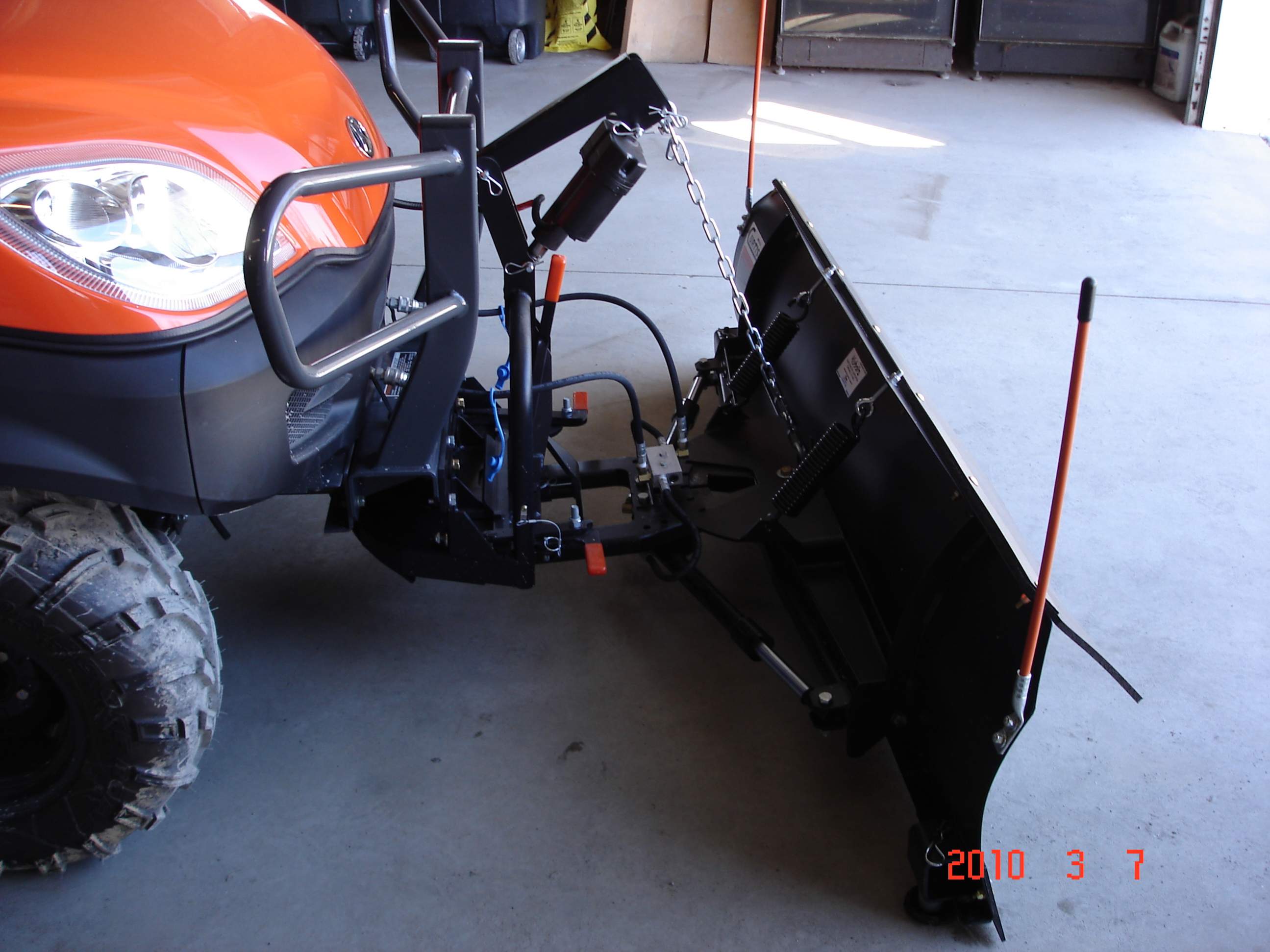

Do you have any pictures of yours? Do you mind sharing them if you have time to upload?
Thanks
Pics from the day I got it--Still looks the same

Thanks for the pics Tim. I really like my open station 900. Most reliable machine I've ever owned.
They are so ugly that they are beautiful. :D
P.S. Wish I had your cab this time of year!!!!

It is ugly, I'll give you that :)...Wish I had an open station for the summer and this for the winter..I don't need AC but without roll-down windows it's a must...A little too spendy to have two of them.
