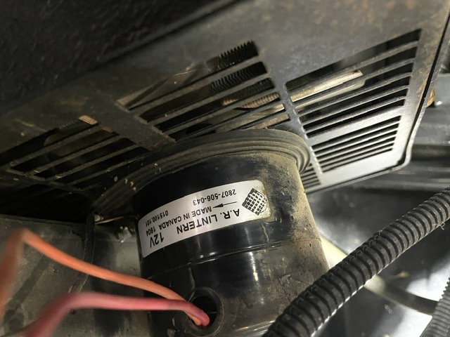

Did some troubleshooting and it looks like an aftermarket heater. Only had ~7-8vdc at the switch. Chased the power wire back to an inline fuse near the battery. Has to spray with WD40 to loosen up the mud and corrosion I found inside. I’ll plan to just replace the inline fuse and reconnect to the battery. Any idea what size fuse to use. This is the blower motor:

Look at the wire size. Circuit fuses are designed to protect the wiring and not the device.

Check the size of the inline fuse, once you remove it, and use the same size, in the new fuse holder.
