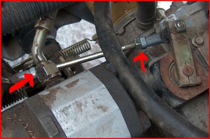

The holdback of the machine, both in forward and reverse is controlled by the same relief valve in the transmission. To adjust this, you have to have some good mechanical knowledge and know what to look for. If you feel confident, I will try to help. What I would suggest is since the unit is so new, you should talk to your dealer and have them adjust it for you.
Hey Matt, My name is Danny and I'am new to this forum so hello to you and hello to all who read this!. Anyway I was checking out this thread becuase my 2010 RTV 1100, which I just got has a couple of issues. Ones that I see you address here. 1st the "holdback" or hst braking is a little harsh and I called my dealer to see if they would adjust it. They say the servo can't be adjusted and that the could install a aftermarket coast valve and bypass the HST braking completely. I don't know if I want to do this as I like the braking action , it's just needs to be cut back abit. Has anyone here had the coast valve installed? If so how do they like it? 2nd I have a heck of the time getting the shifter into the"H" postion. It seems not to lock into gear and looks like it's in postion but when the gas is engaged it's still in Neutral. If I pull the pressure relief a couple of times and it helps but still most of the time I have to wiggle it into shifting a few times beofre it will go into gear. Is the cable adjustment you mentioned something that a shadtree mechanic like me could do? Also can or Can't the Trans servo be adjusted and is this something I could do? Maybe with you're help???
Please let me know and Thank you in advance!
-Danny Navarro , Grand Forks ND

Ok just bought a used Kabota 1140 RTV it lacks power to the wheels... What I mean by that is If im in low and start climbing a hill it does not have anymore power at full throttle than at a 1/4 throttle even though the motor revs higher... seems to me like a transmission issue... PLEASE HELP !
/ Kubota RTV Facts/Fiction... #150
I just got a used 1140 as well. It's a 2009 with 715 hours. It seems to have no lack of power to the wheels. Change the hydro fluid using OEM Kubota filters and Super UDT2 oil. Make sure the air filter is clean and clean the spark arrestor, too.
/ Kubota RTV Facts/Fiction... #151
Ok will try... Mine only has 324 hours on it.... Under load or going up a hill mine sounds like its slipping, doesn't matter if I push the pedal to the floor it dogs out before it spins a tire.
/ Kubota RTV Facts/Fiction... #152
The hdyro in the RTV works like a tractor, you need to LET OFF on the pedal to regain speed (letting off is like downshifting in a truck) so if you mash it to the floor it is like trying to climb a hill in high gear. See if that helps.
/ Kubota RTV Facts/Fiction... #153
Again, this is the correct way to use RTV and all HST equipment. You aren't driving a automobile where putting the pedal to the metal gives more power. On the RTV, this one pedal not only increases engine RPM, but also the angle of the swash plate requiring more power to turn it thus stalling the engine if pedal is held down all the way. When climbing a hill, reduce to about half throttle which gives more power to the hydrostatic transmission so it is effectively putting the RTV in a lower gear while not significantly reducing RPMs or speed. I can climb any hill that I have traction for while in M range and never run out of engine power but I do have to back off the throttle.
/ Kubota RTV Facts/Fiction... #154
Correct, that's exactly why I put no stock in the magazine reviews when they compare UTVs, trying to drive the RTV like a car or a regular UTV will skew the reviews away from the RTV. People who don't know how to drive a hydrostat call them a dog every time.
/ Kubota RTV Facts/Fiction... #155
Thank you... I will try that but mine is gutless in M or H.. Mine will slow to a crawl on just a slight incline on a dirt road..
/ Kubota RTV Facts/Fiction... #156
Does anyone know where I can see a diagram of my Kabota 1140's transmission so I know what to adjust... such as the servo
