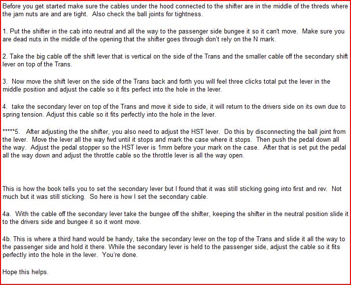

Is the linkage for the throttle supposed to be tight or loose? I can barely move it with my hand.
   / Kubota RTV Facts/Fiction... #82
A proceedure for adjustingthe cable linkage should be attached. If you are referring to the HST link in the previous post, it should be snug.

ok, i finally did the servo and throttle adjustment. It made a good improvement but it still seems to be lacking. I cant get this thing up to 25. In the warmer months it would but now, it will not. I havent done the 50 hr service so im hoping changing the fluids to the Super UDT will help.

I have a coast valve, I took it out and adjusted the thing so it did not send me into the roll cage... There is an adjustment on the valve where the coast valve goes, unscrew it a few turns and problem solved.
Adjusting the servo has nothing to do with the hold back.
