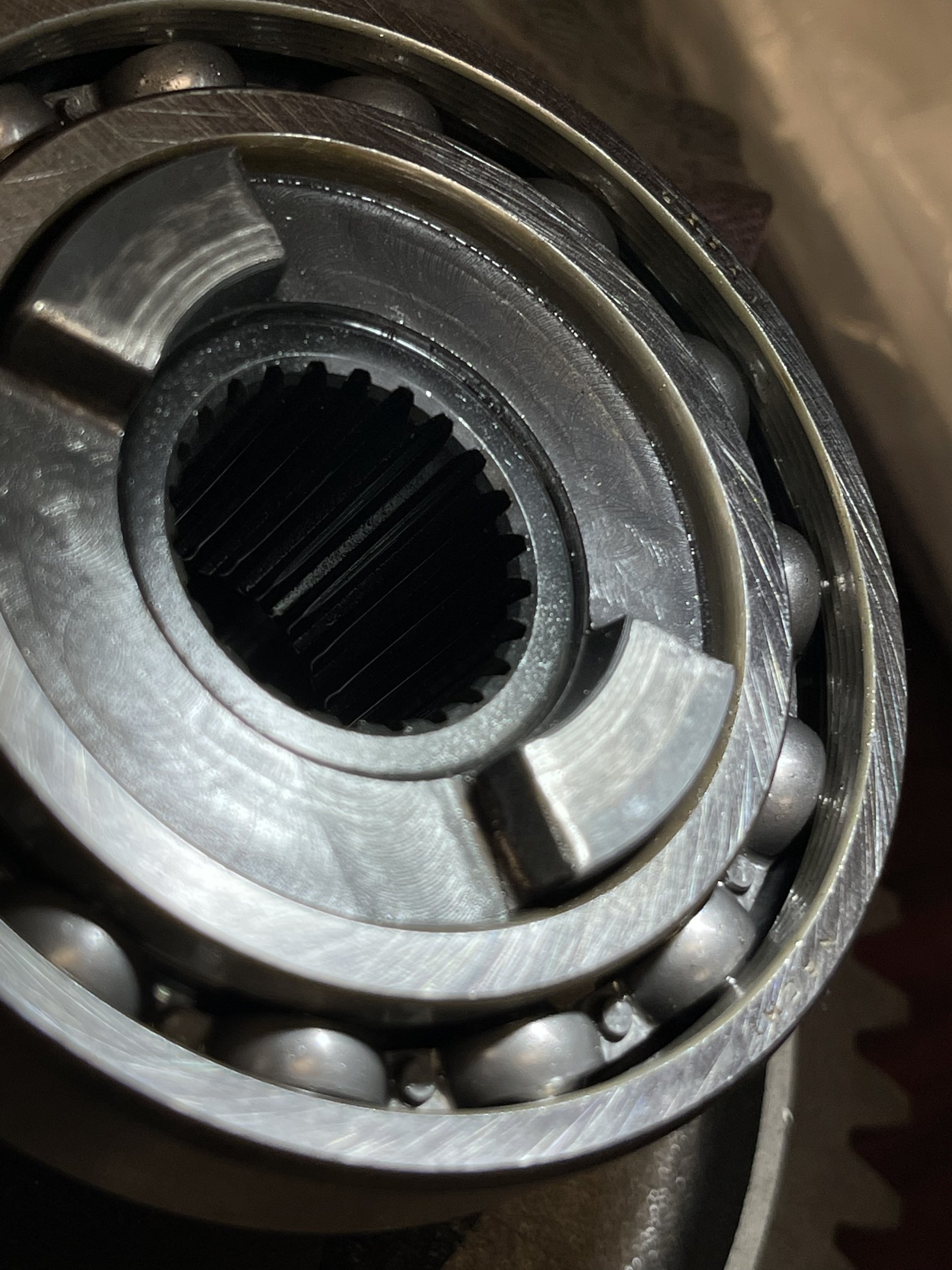

Has anyone had problems with the diff locks not working? I have 3 rtv 500’s all the diff locks failed within first 50 hours. The dealer is denying warranty and quoted 18,000$ to fix

Nope, what was the failure mode? What kind of use did they see?

All three units failed within their first 50 hours while operating on a golf resort in central alberta.
the failure is a hairline crack in the diff Center casting that makes up the contact point for the diff lock.
I haven’t figured out how a hairline crack and surface wear you need a micrometer to measure renders the locker completely inoperable. I also don’t understand how if it was slipping we aren’t able to hear it or feel it contacting every revolution.

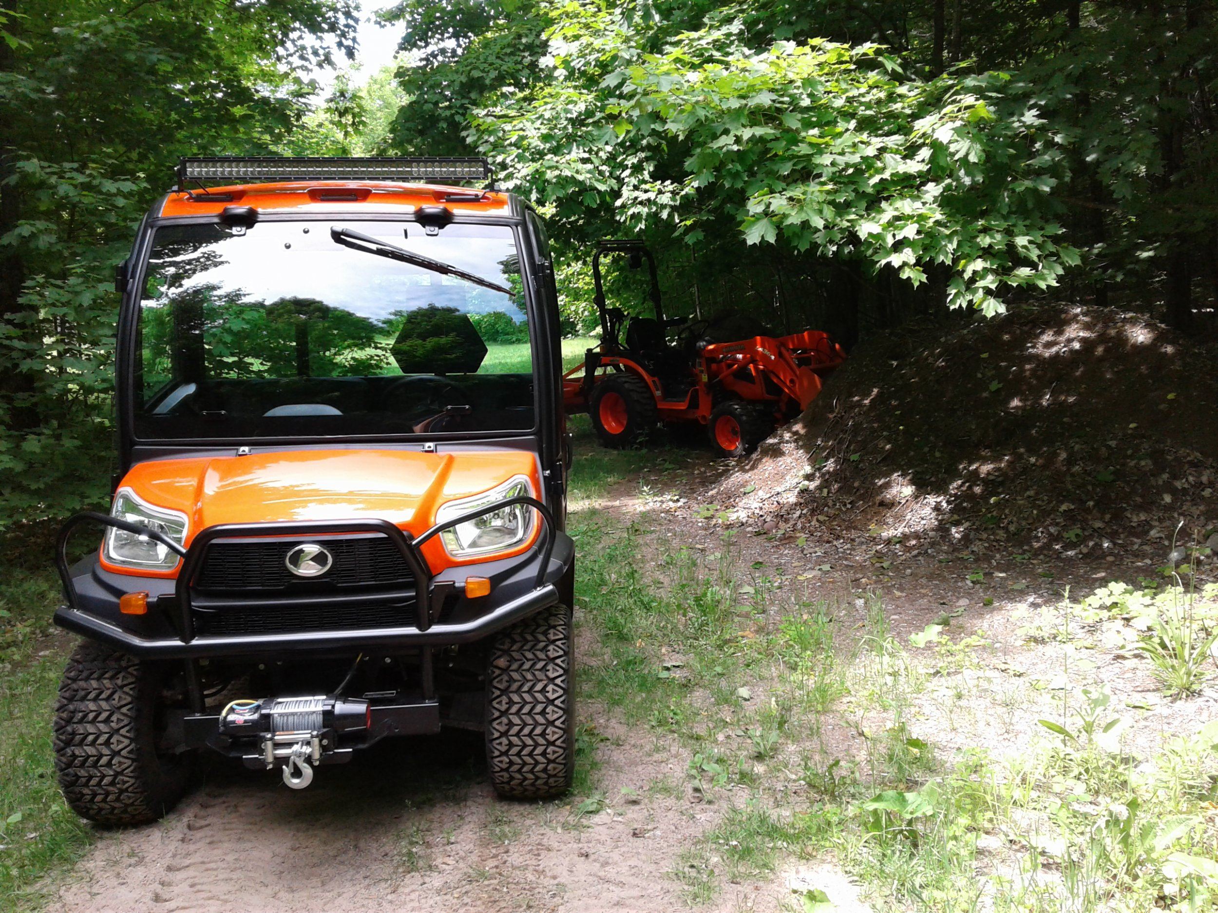

I must have got a good one. I have hauled a 22 tonne dump truck load up my hills into the bush with mine so far. It actually goes 1 MPH faster with a load on climbing the hill. Only time it slows down is if I have the AC on. That sucks a lot of power. But as has been said with AC on when it starts to loose power, let up on the pedal and it will go faster.
Mine shifts good. The odd time it does get sticky if I am on a hill loaded, I just let it start to roll a bit then shift. No problem. Otherwise mine shifts good brakes on or off.
