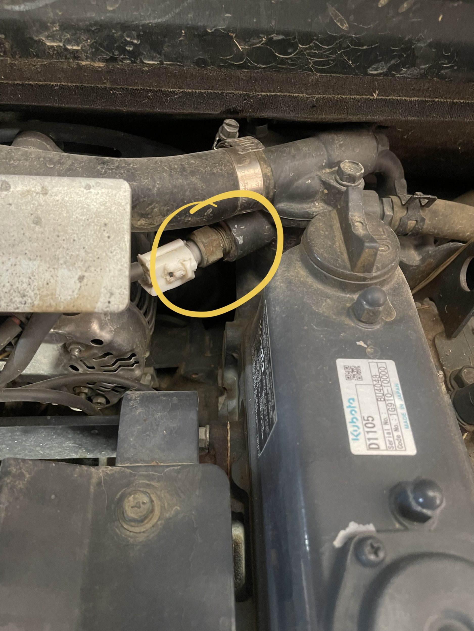

The fan comes on at startup regardless if the fan sensor is good or not, the fan is controlled by a relay the sensor kicks on. I had a boil over when new because the fan sensor was bad. You need to verify fan is operational during use. I have a small sharpie dot on the dash screen over temp guage where the needle gets to when the fan sensor kicks. Your temp guage should never get to halfway mark.Wile using it and you see temp gauge high, simply turn off then restart and as the fan kicks on at startup you will see the needle drop quick. I had to do that until my sensor arrived, dealer mailed it to me under warranty.
Hershey, where is this temp sensor located? Do I need to drain cooling system to change it? Thanks
1120D (diesel)
   / KUBOTA RTV PROBLEMS #62
1120D (diesel)
This is the fan switch. Not much will come out when you change it but the hose above will drain.

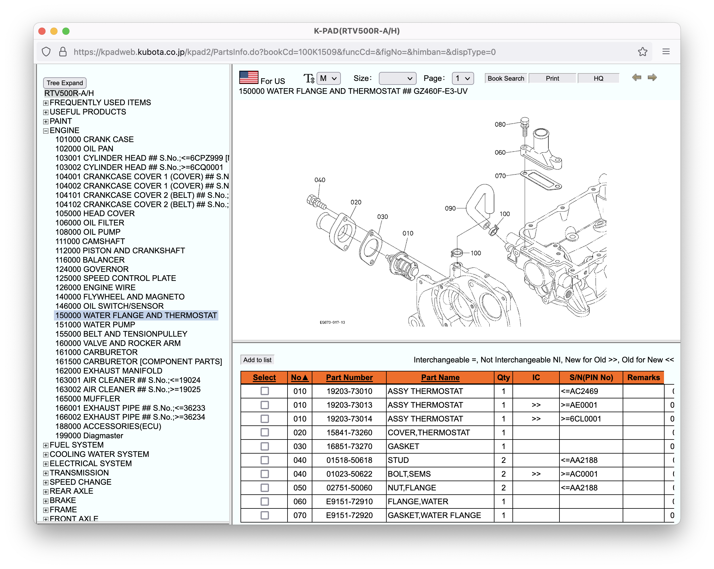

I did have my thermostat fail to open on one occasion.
Coolant in the reserve tank looked a little low, so didn't figure that could be the problem. I went to add a little 50/50 to it anyway, and just as I was there was a sharp "snap" noise from thermostat area, with some gurgling noise following. I just knew that the thermostat had snapped open. Sure enough, I started up and started working it hard again, and the temp never came even close to over heating.
I was/am having an overheat issue also. I had checked the coolant anad the radiator, both OK. After searching for the thermostat I DISCOVERED that there is a SECOND radiator. Yup, belt driven fan on the front of the engine pulling air thru another radiator. Access is thru plastic panel under SEATS. The front radiator has electric fans and is easy to access. BTW.....WHERE is this thermostat????? Thx
   / KUBOTA RTV PROBLEMS #70
HOW do you burp the cooling system? I can't even FIND the thermostat. 😫
It's been a while since you asked this, so you may already have found the answer, but here it is in case.
