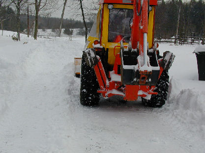

I had vinyl sides, rear and regular auto motive glass for the front,

For some reason I sent a chopper picture that has nothing to do with the subject, If you look close, there is a metal panel on each side with auto glass and a large auto glass windshield within it's own frame and using existing bolts and no drilled holes. I do not have the machine any more to take exacting pictures, but this system worked exceptionally well. For heat, I bought the Curtis branded heater,, Easy to install and operate
