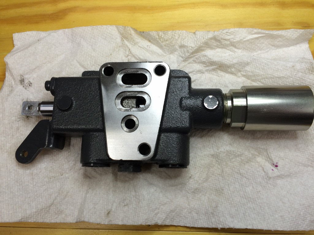

There are actually THREE o-rings in between each valve pair and the supply/termination blocks. Two of them are regular round o-rings, but get squished into oval shaped recesses. Kubota says to stick them to the valves during assembly with heavy grease. If these didn't get seated properly, I'm not sure what all problems would result.
