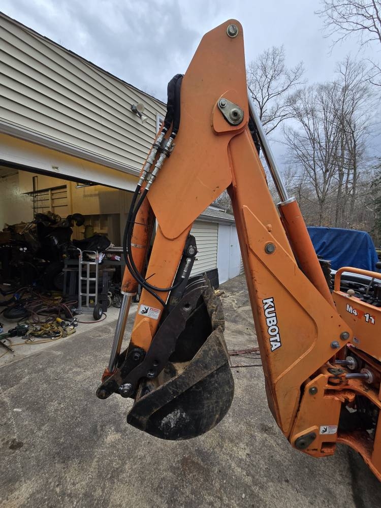

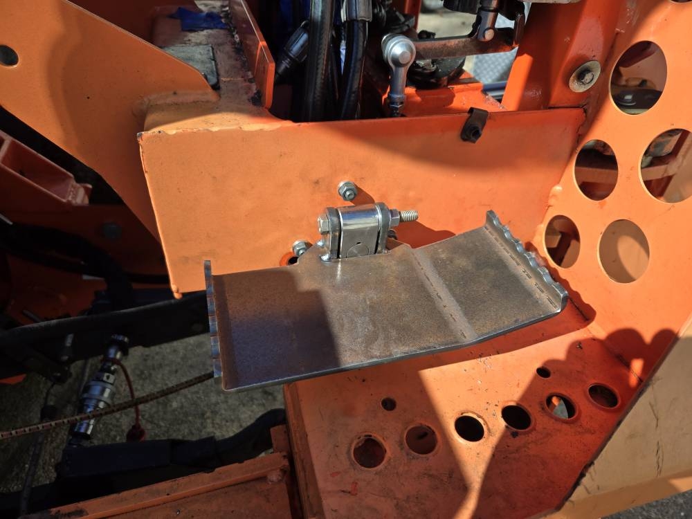

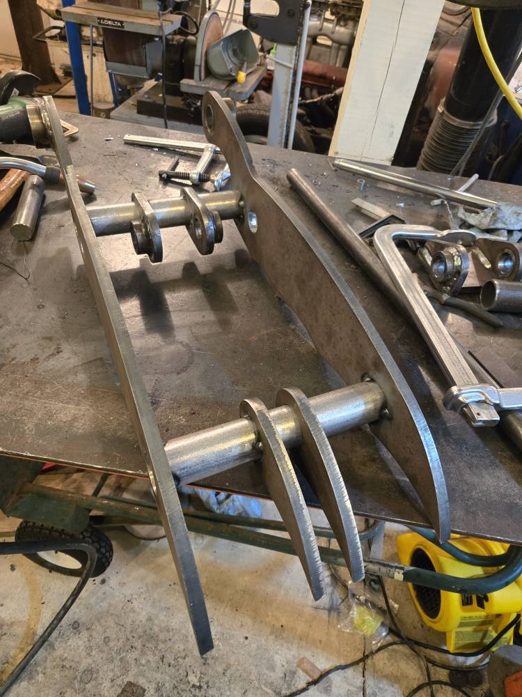

I have the 18" and 24" buckets, being that mine was a M4711 it didn't have provisions for a factory thumb so I had to make my own. Still finishing a few details on it but otherwise works pretty good. I made it work with both buckets which took some effort.
