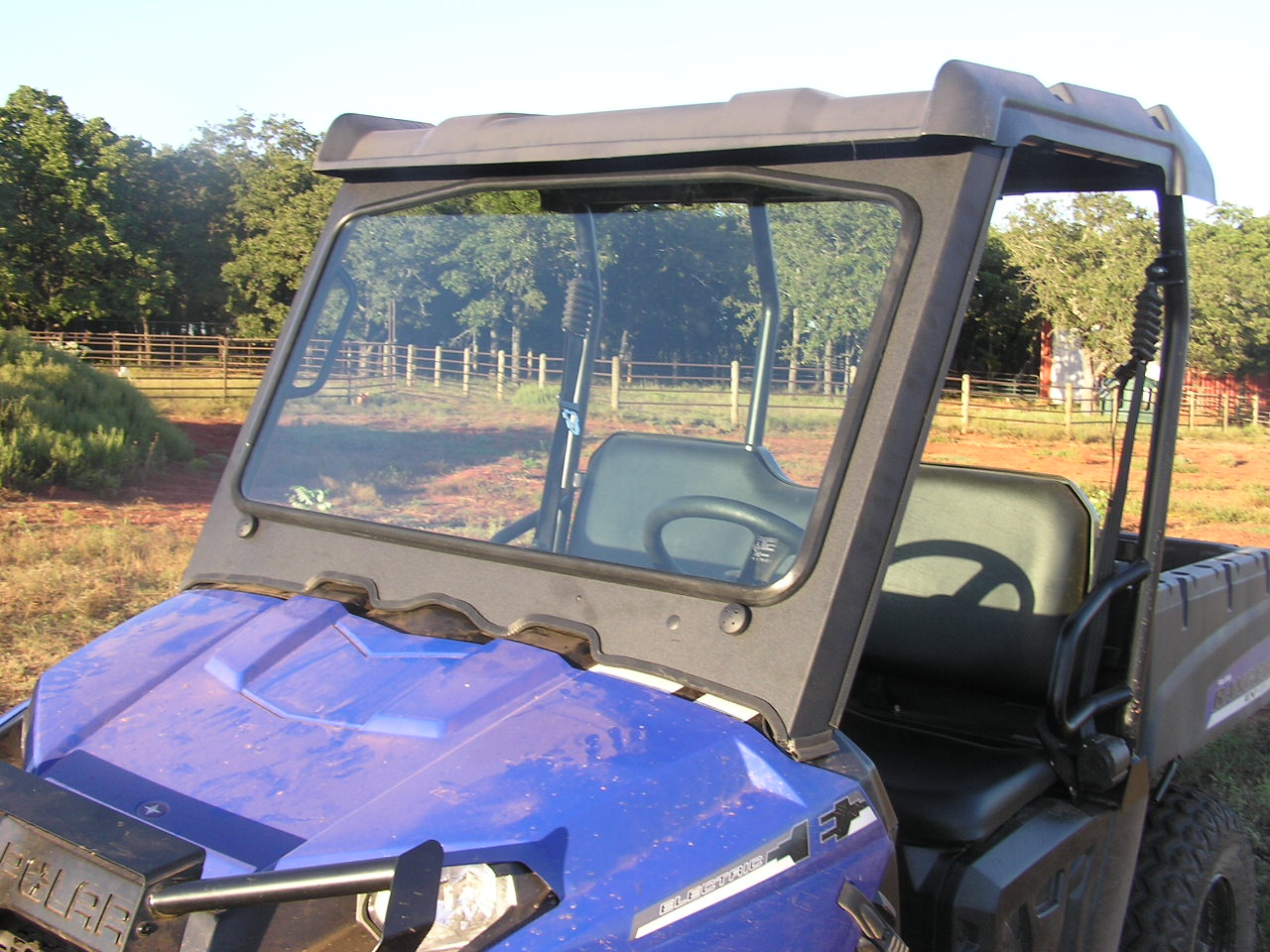

If you are concerned about fuel consumption and can live with 25 mph top speed, go test drive a Polaris EV.
30 hp AC motor and eight 12V deep cycle batteries.
Hard top and glass tilt out windshield
1400 pound tow rating.
500 pound dump bed rating.
Sure glad I don't have to start one of my diesels for this job!
Very stable on side hills.
30 degrees of body lean on this 50% slope.
Good articulation.
More pictures here: http://www.tractorbynet.com/forums/atvs-utility-vehicles/287792-electric-polaris-ranger.html

Man, xfaxman, you are really trying to sell those EV rangers! haha. Not that I mind one bit, I like hearing about your experience with it. Wish you could rate the battery capacity for us in terms of miles/hours though.
When did you switch to those ag-type rear tires?
   / Kubota vs Ranger #28
Man, xfaxman, you are really trying to sell those EV rangers! haha. Yep, just trying to spread the joy of ownership! :D Not that I mind one bit, I like hearing about your experience with it. Wish you could rate the battery capacity for us in terms of miles/hours though. I haven't tried to keep track. It doesn't have an odometer, just the hour meter.
When did you switch to those ag-type rear tires? About a month ago. They don't throw gravel off the driveway like the Carlisles did.
We had a twin cylinder gas engine,
Traded for a 3 cylinder diesel,
Traded for this no cylinder 30hp AC induction motor.
Gonna keep this one! :thumbsup:
   / Kubota vs Ranger #30
What size are those tires on your Ranger and do they rub at all?
Replaced the Carlisle 25-9.5-12, All Trail II, with Interco Interforce 27-7.5-14, 6 ply, 2" narrower, 2" bigger diameter.
The pictures show it with two tires in the ditch and the other two near max travel. No rub so far.
The EV's front and rear tires were the same width.
