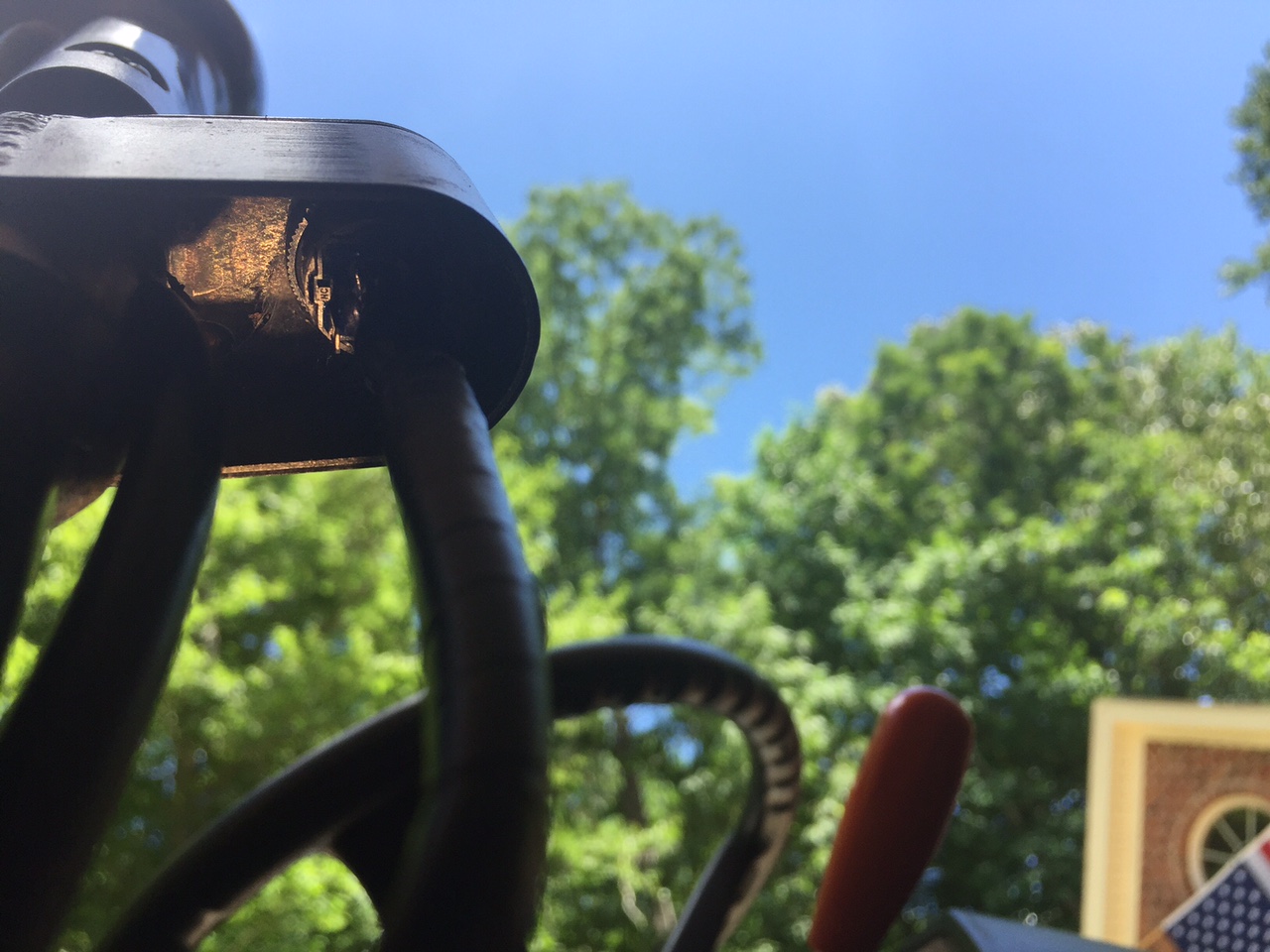

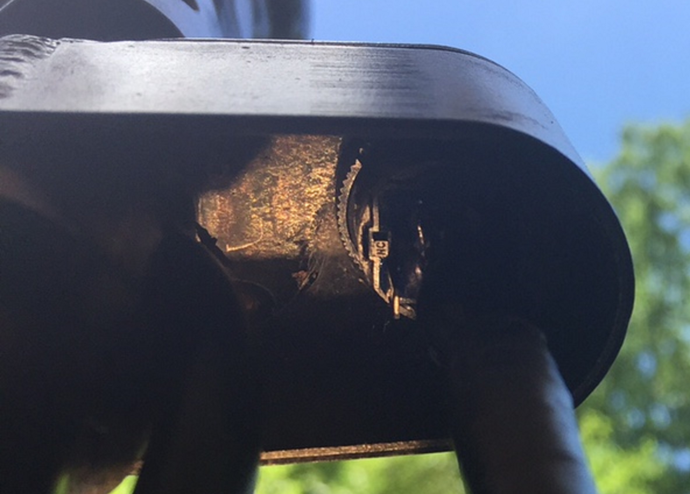

A few months back I had a third function remote value and switch installed on my B2650 tractor and loader. I have yet to use it. A couple weeks back the switch fell apart. It's located ont he loader control stick. The switch fell apart without ANY use. I hav yet to even put quick disconnect couplers on the lines. I called the dealer and sent a few emails and was finally told Kubota will not warranty it since it's past 90 days. 90 days? The friggin system cost me about $900 and it hasn't been used once. The kicker is the switch is $125...Maybe I should have bought a JD?

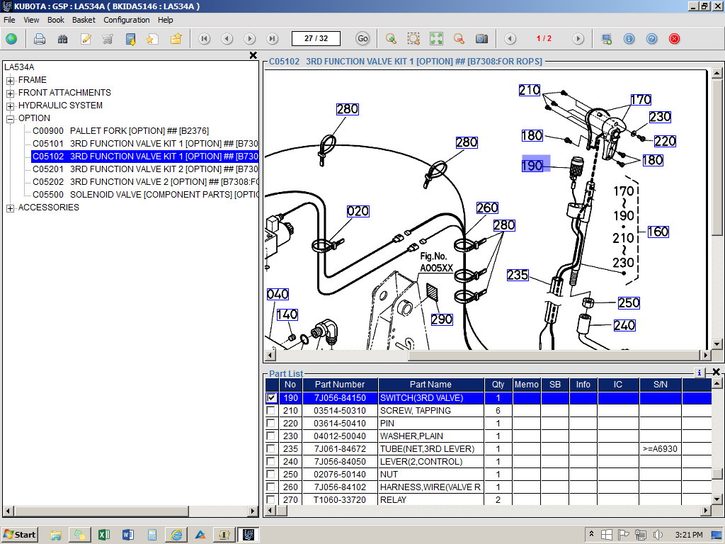

Here's my coorespondance with the dealer. Below are two pics I sent and a diagram he sent me back

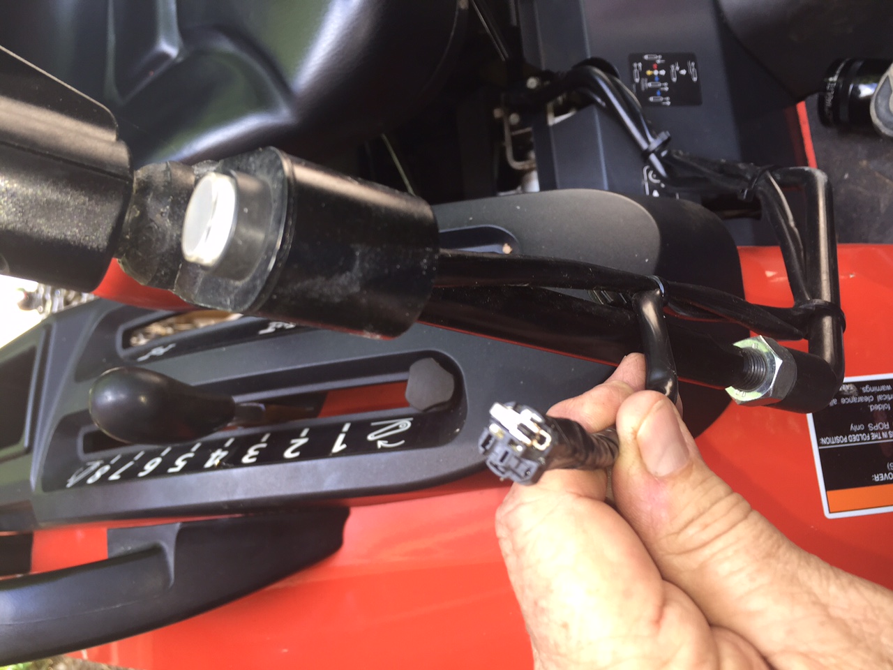

I haven't even used the third function remote yet and the wire has fallen off of the button switch. It's not very robust. I've tried to put it back on and it has fallen off each time. When I have the wire on the switch it's not actuating the valve either. It's probably because it's either busted or I don't have it seated up there correctly.

Here is a breakdown of the 3rd function valve handle assembly. Number 190 is the valve button. I discussed the issue with the Kubota tech representative and sent them the pictures from you. I inquired about sending us a replacement under warranty. They stated that the 3rd function valve kit only has a 90 day parts warranty. I advised that the unit has not had any field use. They would not warranty it but I am going to sell it to you at cost. The part list for $125.37, your cost on the switch will be $94.03.

I think they need a better strain relief system or a wire harness sleeve/grommet over the entire FEL control stick. That would cover up the wiring and prevent snags. I will do that when I fix it.
I would pop the knob off the handle, then put a piece of shrink tube over the lever and the wire (such as Amazon.com: Install Bay Heat Shrink Tubing 3M 1/2 Inch 8G - 4 Feet: Car Electronics for 1/2" or Amazon.com: Install Bay 3MHST34 3M Heat Shrink Tubing 3/4" Diameter 4G 4-Ft: Car Electronics for 3/4")

That might work. I'm not sure it would fit over the nuts on the stick though. Mayve an expandable mesh sleeve or split nylon wire conduit? The wires should definitely go through a GROMMET on both terminations so even if you do happen to snag it (even if it's in a sleeve) , it won't pop out. The design on the existing system sucks. Here's the photo again of the underside of the switch / wire termination - there is NO strain relief to speak of.image1.JPG
