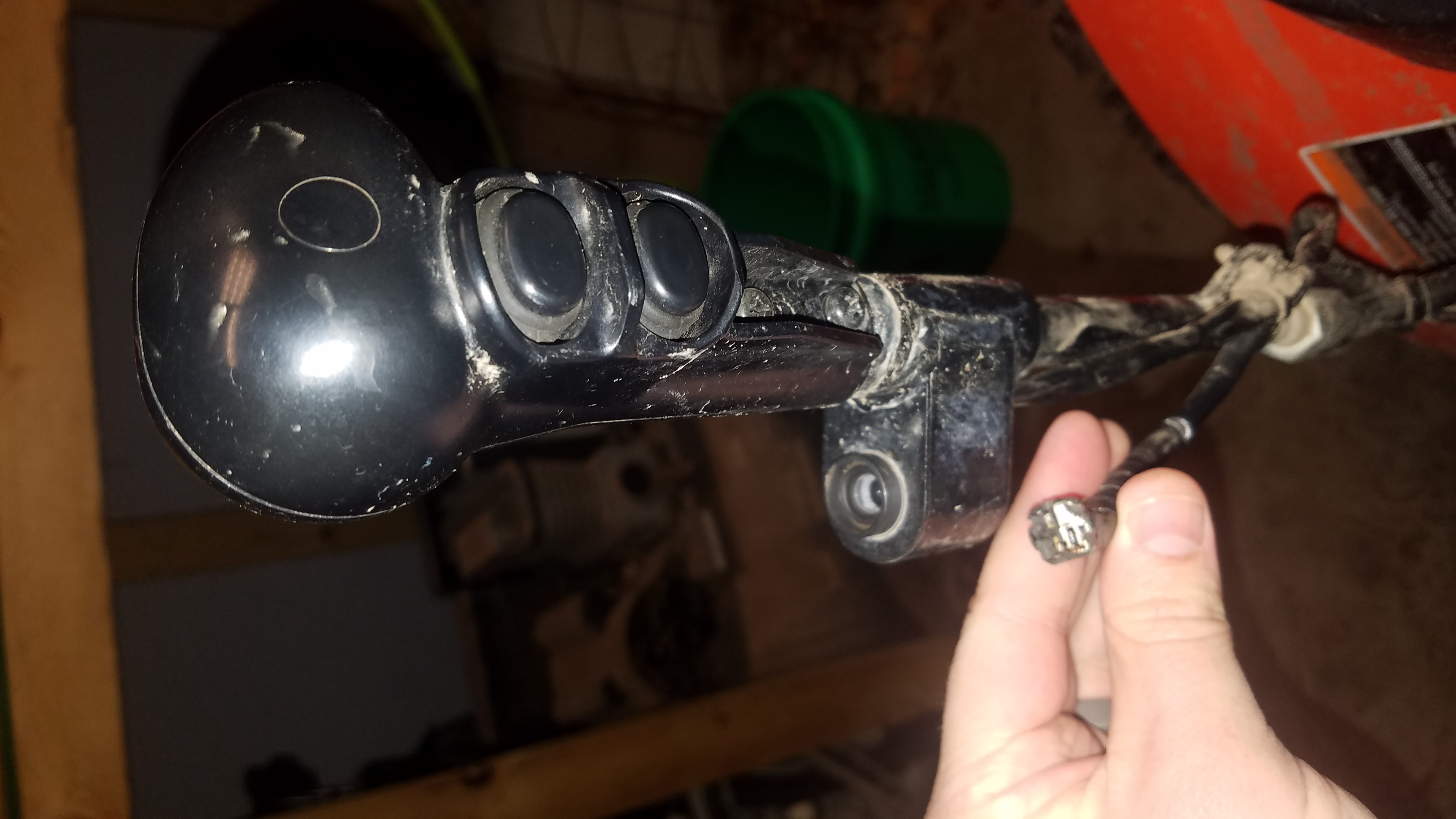

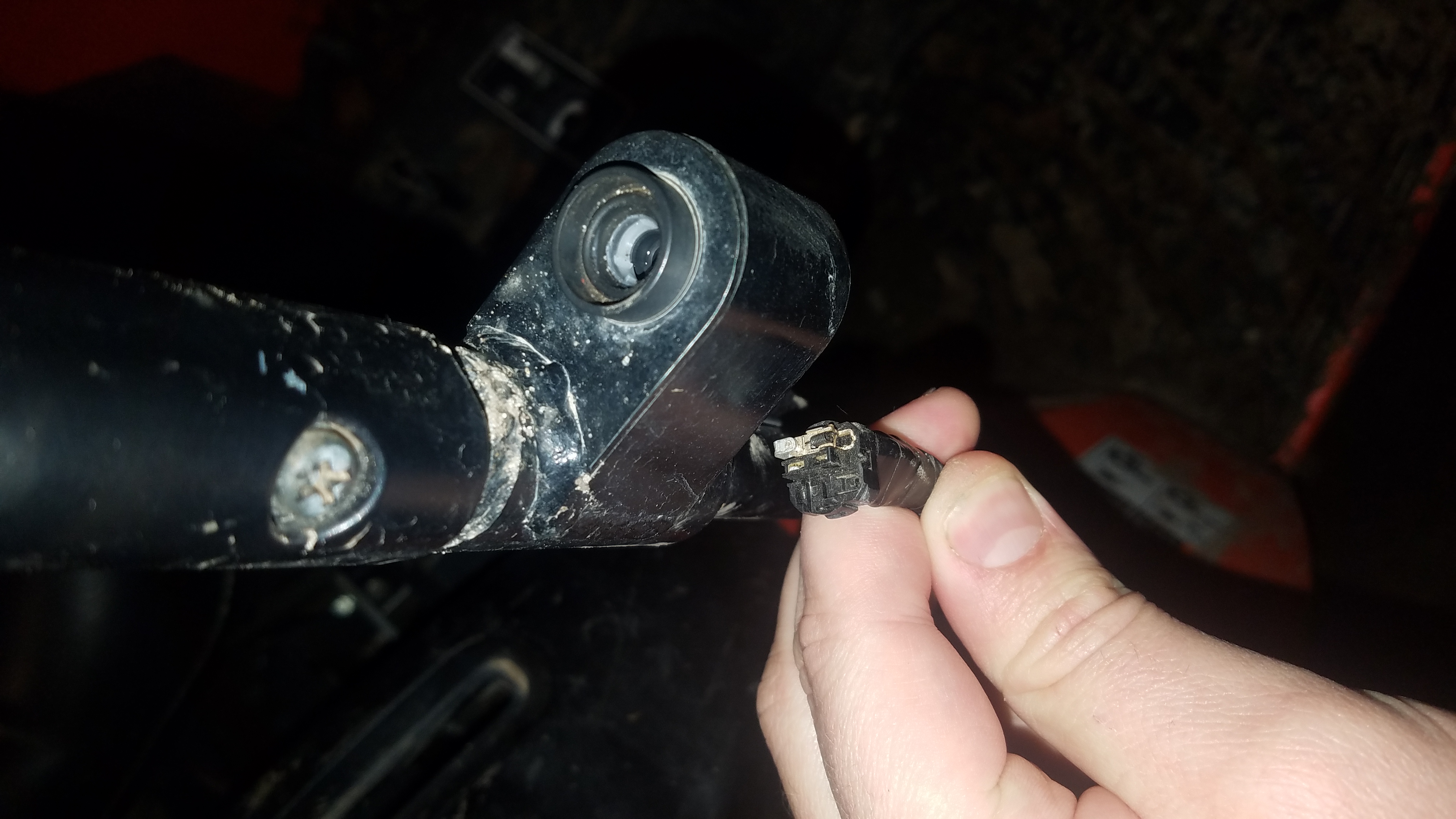

I have the same issue. My b2650 is currently at the dealership for warranty claim. The Dealer told me the same thing. Kubota wont fulfill a warranty claim... Long story short, Ill be picking up my tractor and wiring up my own "Amazon" switch. Very unhappy with Kubota on this whole ordeal, which is unfortunate, because I love my tractor. 20180223_111338.jpg20180223_111408.jpg
   / Kubota Warranty on B2650 3rd Function Remote Switch is really LAME #29
So not quite two years later the second Kubota switch fails. Not paying for another switch and harness at about $170.00. I pulled the switch and found I could buy an OEM NKK switch from Mouser Electronics for $24.00. I went with the bright green light. Soldering it in is a little fiddly since the terminals are small and close together but other than that it's an easy install. You can wire so button up is on vs button down on if you desire
Hope this helps someone
I know an old topic, but one of my buttons is now missing (bottom one) and looking for a replacement, do you have any pictures of your install and how has it held up?
