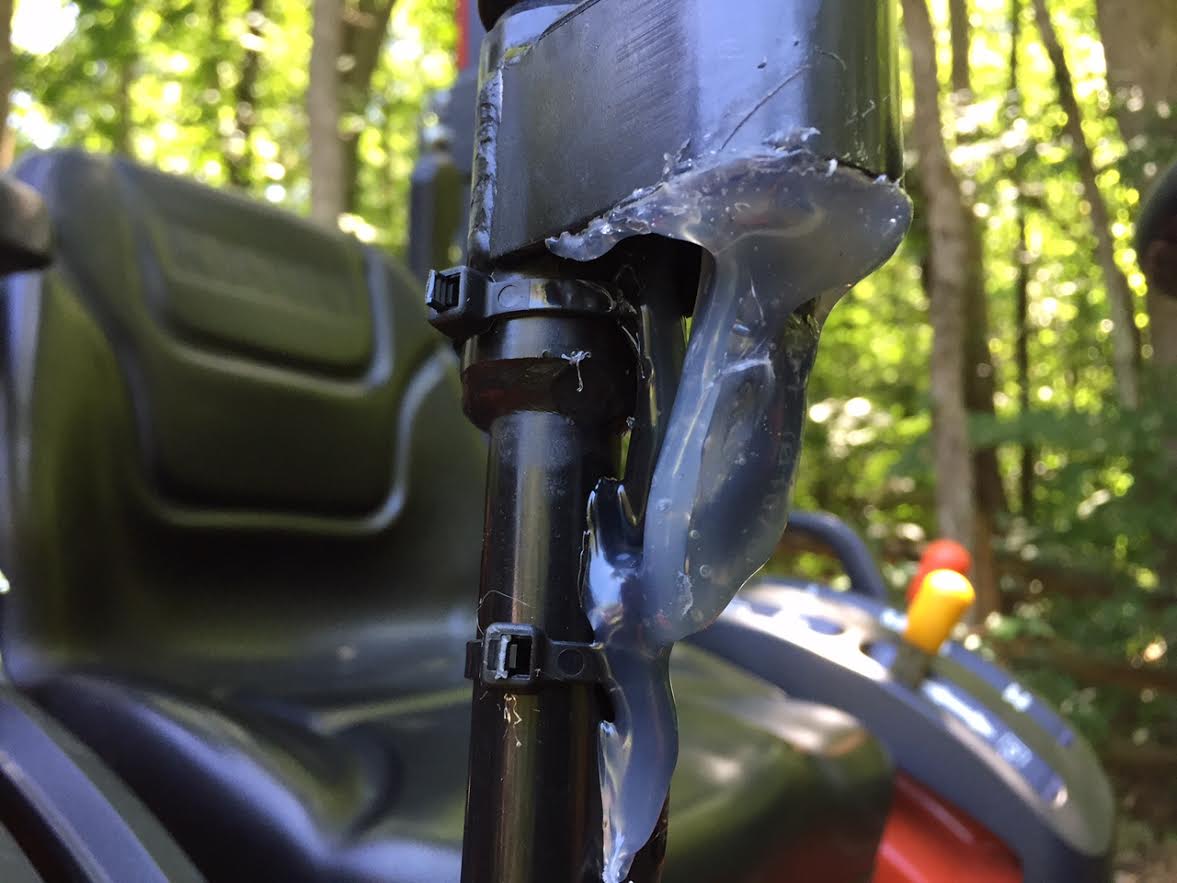

daveinwestmi - let me know how that goes.... I don't know how mine failed - maybe like yours did? I'm in the woods quite a bit. I think they need a better strain relief system or a wire harness sleeve/grommet over the entire FEL control stick. That would cover up the wiring and prevent snags. I will do that when I fix it. I'm going to look at the switch carefully with a voltmeter and O-Scope when I get it back from the other dealer on the Hydro leak and figure out how to actuate the valve correctly. Then I may either try to fix the thing or fabricate another equivalent switch. It can't be that complicated. I'll post whatever I do for it.
To the OP. I talked to the parts manager, he talked to service and the switch was ordered. A couple days later he called to tell me it was in, asked if he needed to send the tech to install it. Nah I can handle it, all he asked was that I bring the old switch back to him so he would have it in case Kubota wanted it sent back for the warranty claim. I'm sure he will let me know if the claim is denied. So far so good. How did it happen? I'm pretty sure I snagged the harness but in my opinion the harness should run internally in the lever or should be shrink wrapped to the lever which I will do.

Several things come to mind on this
1) When you spend nearly $20,000 for a compact tractor plus a few add ons (like the $850 I spent for the 3rd function remote system) , and a simple part breaks without real use 3 months after purchase, the seller should eat the cost - not me. Kubota is not hurting. I won't forget this
2) The switch lterally fell apart. It's not a very robust piece of HW for heavy machinery. They're bound to have quality issues with other customers.
3) The replacement costs of $125 retail for a simple low current switch is insane. It probably cost them less than $5 to manufacture
Anyway - enuf said. Overall I'm happy with the B2650 . Other than this switch issue and a few simple Hydraulic leaks, it's been a huge productivity adder to working around our property

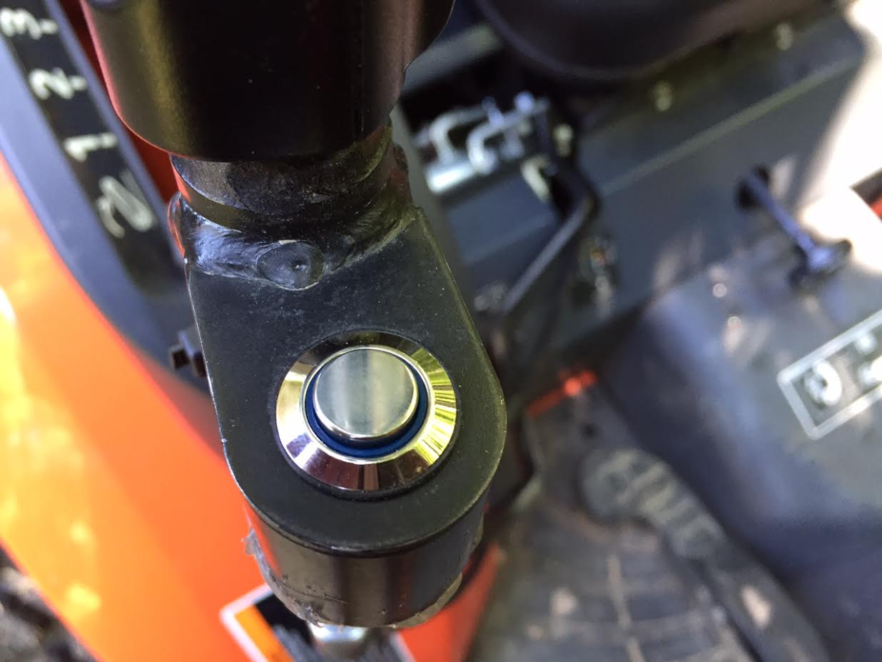

I know this in an old thread but it proved wonderfully helpful to me. First my button fell off then the whole switch went bad and the third function valve is inoperative without it. With the help of this thread, the fix was simple and CHEAP! Thanks

So not quite two years later the second Kubota switch fails. Not paying for another switch and harness at about $170.00. I pulled the switch and found I could buy an OEM NKK switch from Mouser Electronics for $24.00. I went with the bright green light. Soldering it in is a little fiddly since the terminals are small and close together but other than that it's an easy install. You can wire so button up is on vs button down on if you desire
YB16WCKW1-5F5-JF NKK Switches | Mouser
Hope this helps someone

The main power button is holding up fine, no problems. I just had the same problem with my bottom button, fell off who knows where. According to my local dealer the switch is part of the grip assembly 7J056-84030 $213.00, not going to happen. Was going to take it apart to see who the manufacture was and source one but didn't have to. Couple days later it appears on my toolbox, my wife it outside the pole barn in the gravel. It pays to be lucky :D
