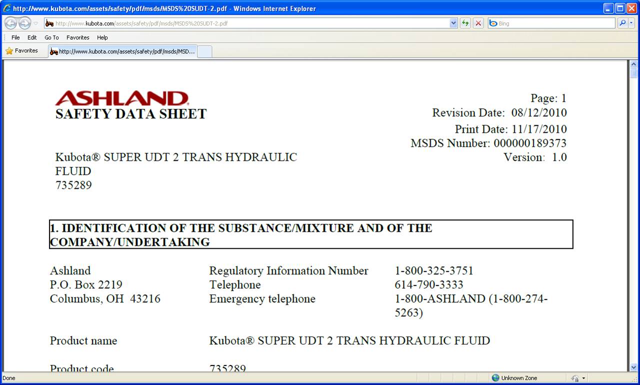

Baldwin has a listing for the Lxx30 and Lxx40 HST filter. It is approximately $25 less in cost and has the billet end cap similar to the Kubota P/N. (Baldwin P/N BT9358)
Super UDT2 seems to be made by Ashland. At least that is what the MSDS posted on Kubota's website implies. (See attachment or link below).
MSDS Link: http://www.kubota.com/assets/safety/pdf/msds/MSDS%20SUDT-2.pdf
