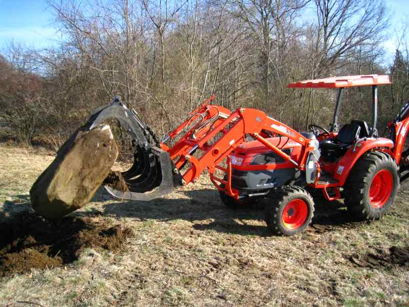

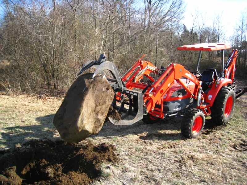

Do non HST plus Kubota's have a stalling problem when operating the loader? I've stalled my Kioti a few times mowing but don't ever recall stalling while using the loader. I set the engine to run at about 1800rpm and just go to work. What does the anti stall do?
Regarding front tires: here is my DK lifting a 2000lb (12cu/ft) granite boulder balanced at the tip of my grapple. Load is centered about 3.5 feet from the pivot pins. Tires look OK to me. 10x16.5/6 R4s on the front.
I dug the rock out of the ground accidentally as I only saw the tip sticking out and was not aware it was so big. I grasped the tip and curled/lifted and this is what came up. I am not sure how much higher I could have lifted it but the seat of my pants told me to stop despite having a backhoe mounted for ballast. I doubt I could have lifted it to full height but probably could have put it in a pickup. Moved it about 100 feet and put it down.
