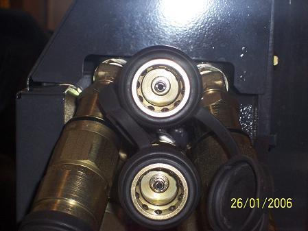

Here's the latest info. I drove up to the dealer, hoping that we could match the proper coupler to a kubota valve on his lot. No luck.
He called the dealer helpline, and I am still waiting for a reply.
No reply to my e-mails to Parker or Kubota yet.
I'll attach some better pictures.
WALT

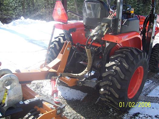

#14
Picture #2, right side view of valve body mounted to rops.

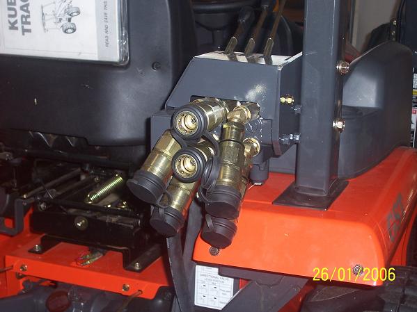

   / L-39 HYDRAULIC COUPLING MYSTERY #15
Good luck Walt, that is the exact same setup that I have on my three rear remotes too, as you can see in the attached pic.
If worse comes to worse, you can always remove the Kubota ones and simply install the normal female Pioneer Quick Connect ones with the slip collar and go from there.
Kinda weird that even the dealer doesn't have any idea what they are when he installed them??? /forums/images/graemlins/confused.gif

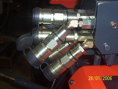

Picture #3
rear view

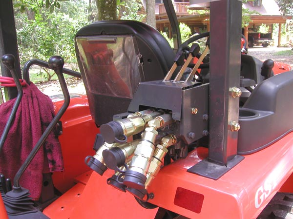

Bad News Then Good News:
TBN'ERs
1st: My dealer was given the KUBOTA part # 7000-02489 for the male coupler. $52.00 each /forums/images/graemlins/blush.gif /forums/images/graemlins/blush.gif /forums/images/graemlins/blush.gif /forums/images/graemlins/blush.gif /forums/images/graemlins/blush.gif /forums/images/graemlins/blush.gif /forums/images/graemlins/blush.gif /forums/images/graemlins/blush.gif /forums/images/graemlins/blush.gif.
As you might imagine, I told him to wait on ordering me any.
I called KUBOTA and after going through numerous administrative people, I talked to a fellow in the parts. dept.
He stated that he had received other calls on this, and was familiar with my question.
PARKER is the vendor of their hydraulic fittings, & the KUBOTA rep. said to use the standard 8010-4 male fitting. /forums/images/graemlins/smile.gif /forums/images/graemlins/smile.gif /forums/images/graemlins/smile.gif /forums/images/graemlins/smile.gif /forums/images/graemlins/smile.gif /forums/images/graemlins/smile.gif /forums/images/graemlins/smile.gif /forums/images/graemlins/smile.gif /forums/images/graemlins/smile.gif /forums/images/graemlins/smile.gif /forums/images/graemlins/smile.gif /forums/images/graemlins/smile.gif /forums/images/graemlins/smile.gif /forums/images/graemlins/smile.gif /forums/images/graemlins/smile.gif /forums/images/graemlins/smile.gif /forums/images/graemlins/smile.gif /forums/images/graemlins/smile.gif /forums/images/graemlins/smile.gif
Somebody could finally tell me the correct male end to use.
I stopped at a local tractor dealer, a purchased the proper connector for $6.00, along with a 1/2" to 3/8" reducer for $1.55.
This is AKA the standard male Pioneer coupler.
The Female couplers that are supplied with the KUBOTA valve body do have a internal slip coupler, vs. the common exterior slip ring.
The Pioneer coupler is a 1/2" female pipe thread to your cylinder hose. I needed 2- 1/2" male to 3/8" female pipe thread reducers to connect to the cylinder hoses.
Once the connections were made, tractor fun was to be had.
Angling the rake/blade without leaving the tractor seat is what the good life is all about.
Attached are some pictures of the completed set up.
WALT
