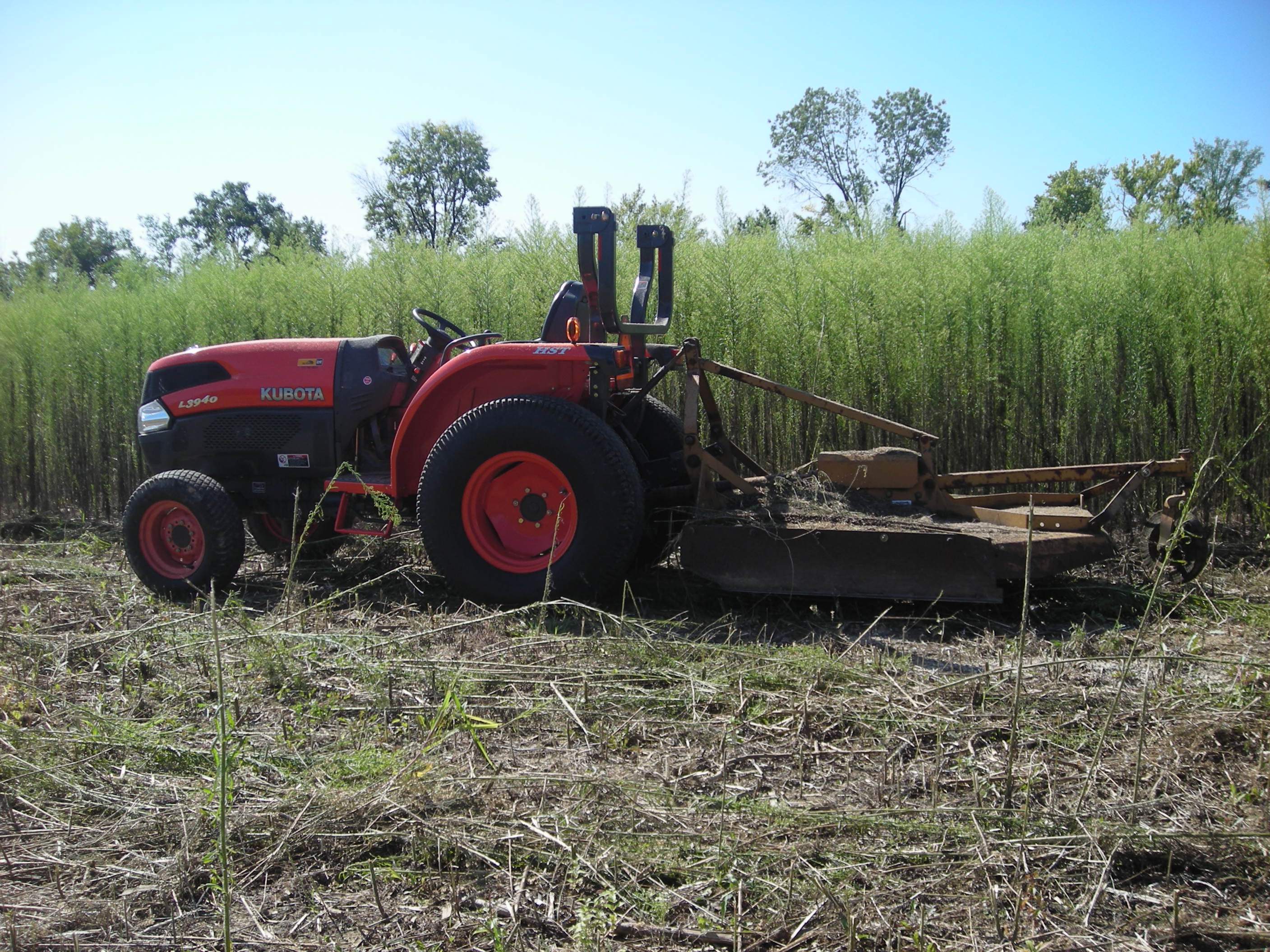

My front end gets a little light with a 6' bush hog, but nothing I am uncomforable with. Steering is fine, no issues. But, I do not deal with hills here in central Indiana. Maybe the Kubota weighs more in the front than the Massy? Philip.
