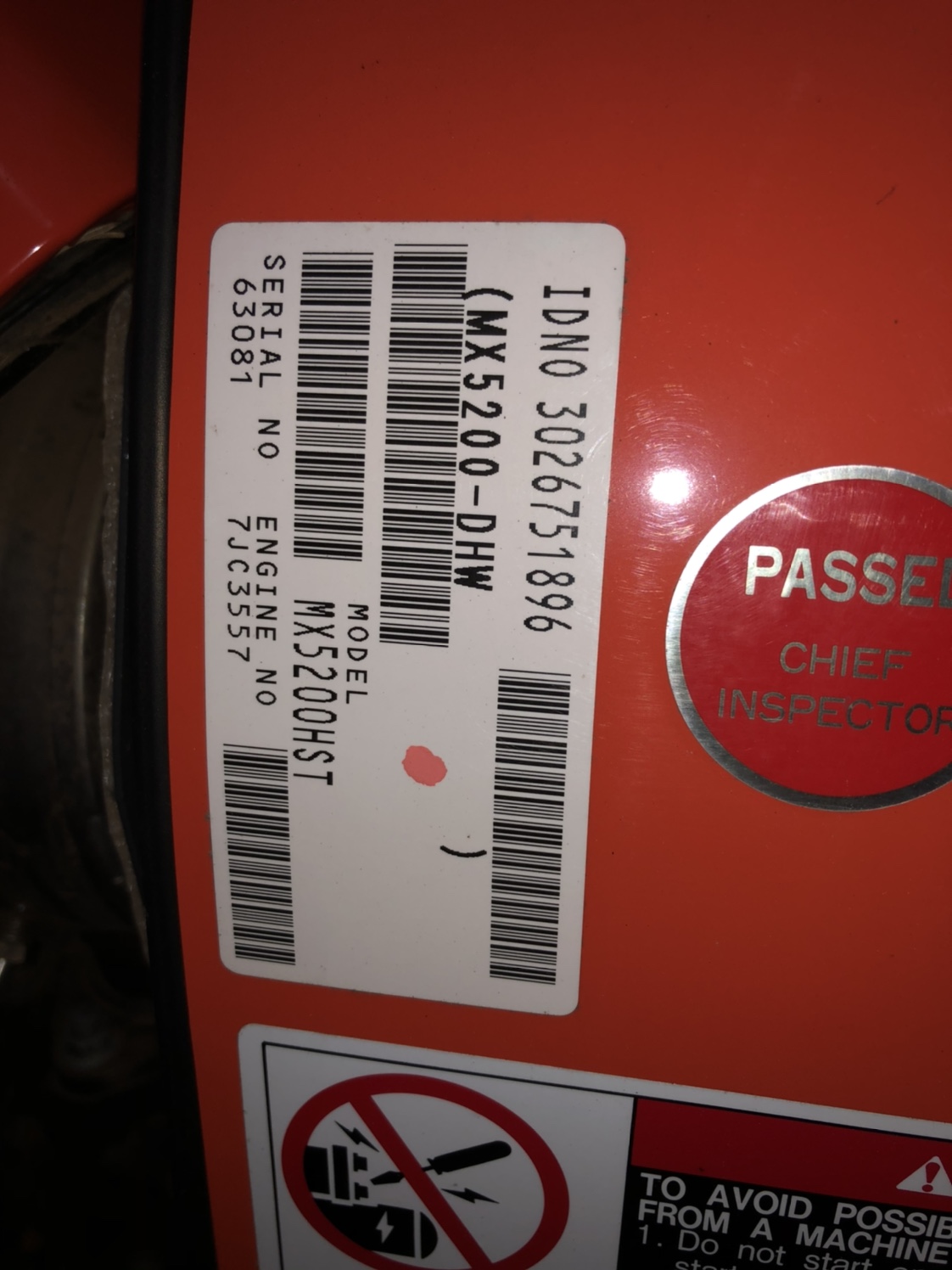

   / L Series HST Recall #17
My 2016 L4060 has a serial number starting with 42, well before that serial number range.
Thanks for posting the info.
