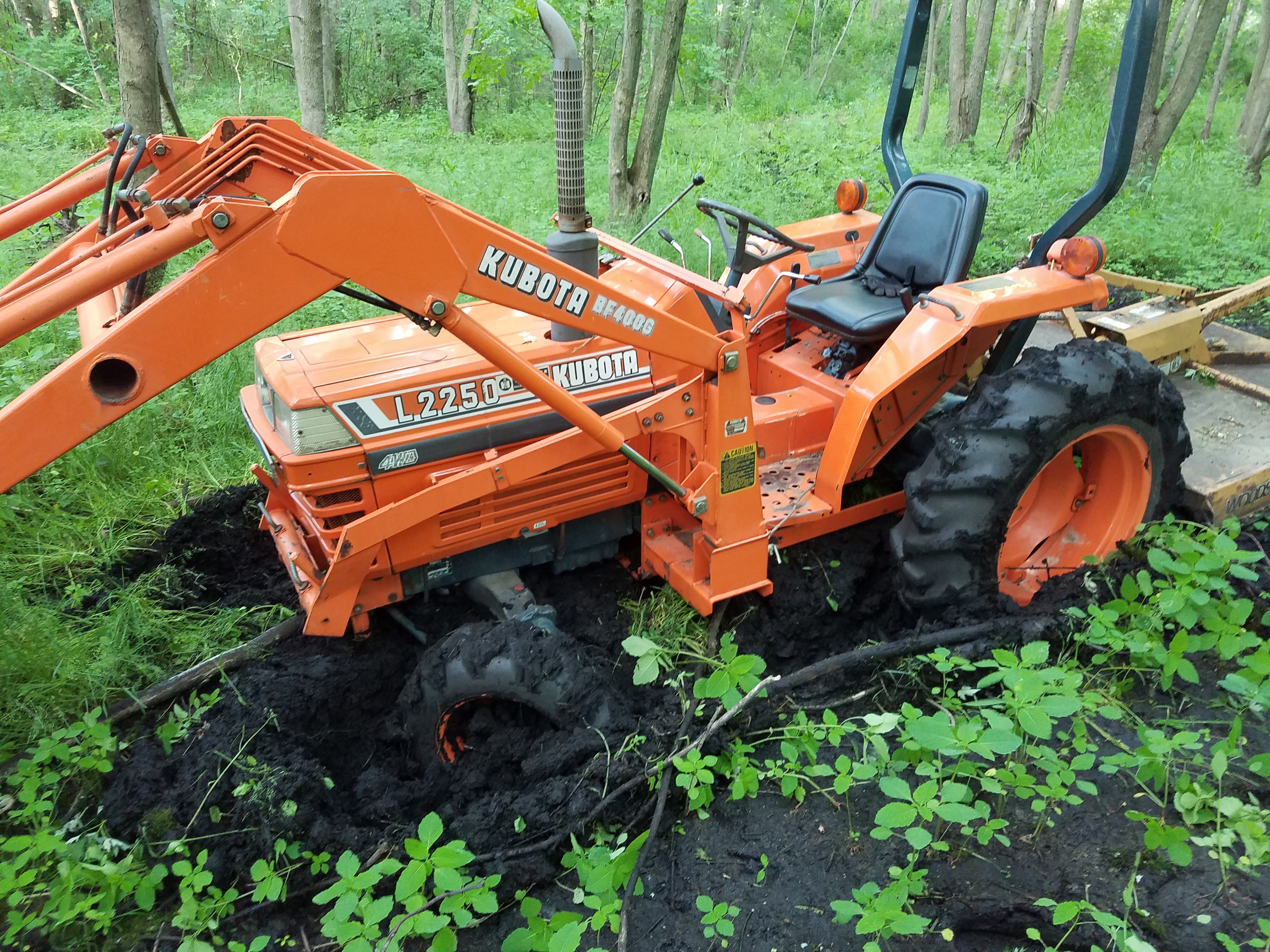

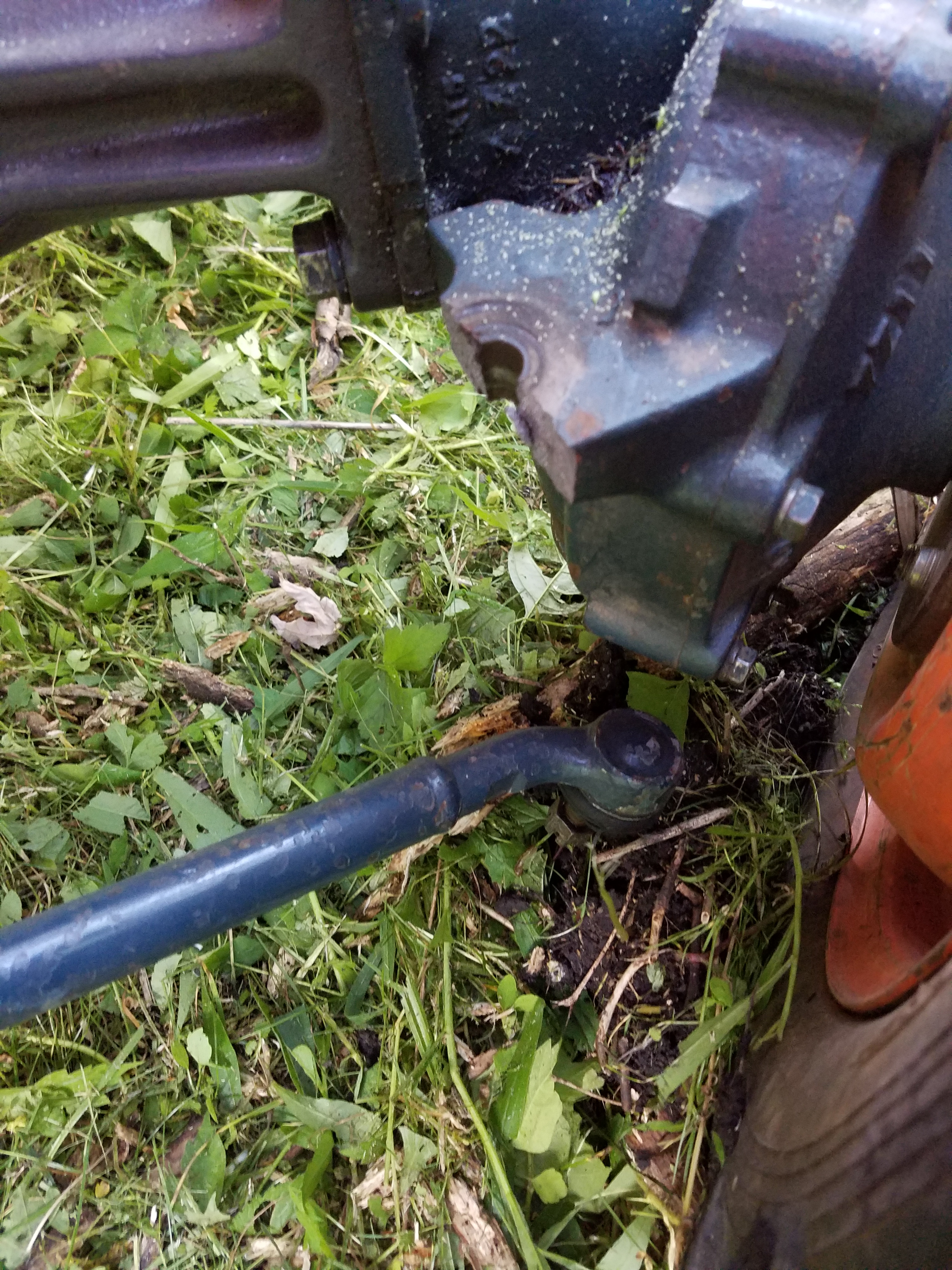

I was brush mowing in the woods on my property today when my left front spindle broke. The ear for the tie rod end is not only broken off, but missing somewhere in the woods. It has MFWD and I'm guessing this isn't gonna be cheap. So I have 2 questions...
1 is it worth renting a metal detector to find the other piece and try to weld it back together? (looks like cast, so not sure how well that would work)
2 where is the best source for a replacement spindle assembly?
On a side note, in the process of trying to get back out of the woods I managed to bury it in the mud... but that's another issue entirely.

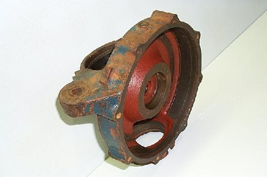

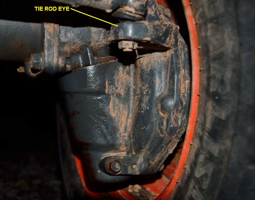

Even if you find the broken piece, it's going to be hard to make a strong enough repair. It's a high-force part, and welded cast iron is usually half-strength or less unless it's reinforced somehow.
Finding the broken off ear piece may not be a must. A sure fix would be to replace the axle case - but a welded and bolted steel reinforcement bracket might be possible that provides a new hole for the tie rod end. It's exact shape and attachment points would depend on the shape at the break. Best of luck, Dick B

My neighbor broke the same piece on his L3450. He took it to a "really good welder" and it broke after a couple of days. He decided to try and weld it back together himself with some cast rod. That was 9 years ago. Still going strong.
I sure would try to find the part and try welding before I shelled out any money.

I agree. I have a friend bringing a metal detector over to help find it. The "really good welders" I speak of are career welders turned welding instructors. If it can be welded, these guys can do it. One of them did work for NASA in the past and is a CWI.

Instead of $700 for a new case (or half that for used), I'm thinking a 1/2" thick flat steel ring could be made that attaches to the 8 cover holes with new longer bolts. A steel bracket welded to the ring would have a hole for the tie rod. The tapered ball joint stem could be mounted with washers to preserve it's pivot function. The bracket would have extra material at the ring, distributing the forces. There isn't much wheel clearance so whoever makes the part will need the tractor handy for fitting.

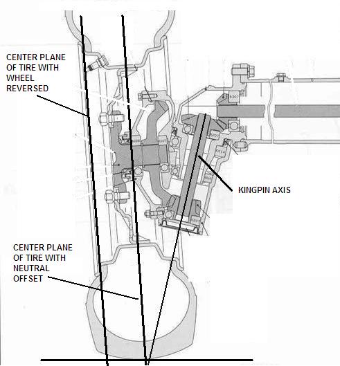

BTW, one drawback of reversing the front wheels is increased loading on the steering linkage, possibly contributing to this breakage. As the center plane of the tire moves outward from the center of kingpin rotation, road bumps directly yank on the tie rod. The attached cutaway drawing shows the normal nearly neutral wheel position - the central plane of the tire nearly intersects the kingpin centerline at the road surface. Road roughness has little effect on the steering. But reversing the wheel moves it out to the left, increasing the twist on the steering whenever the tire hits something.
Good post. In addition it increases the load on the outer wheel bearing and axle housing to reverse the rim. Don't ask how I figured that out twice....

Agree. I like the Rbargeron approach. Cut the 1/2" plate to fit rough and then be sure it clears everything. Then trim the plate as needed and drill the holes. You did not say what exactly broke. From the picture all I could see broken was the ear for the steering knuckle. True? If that is the case there was one heck of a large force on the steering gear to break that casting. I'd be inclined to think that the muck you were down in was such that your trying to move the tractor back and forth broke off the ear rather than "normal" steering forces. I'd look around to see what else was overstressed. By the way, when you go for the longer bolts, take along one of the originals and make sure they both screw easily into a matching nut. I have found Kubota frame, mower mount, and other bolts to sometimes be "non-standard finer threads" besides being metric. Impossible to tell just looking at them.
/ L2250 Broken Spindle
