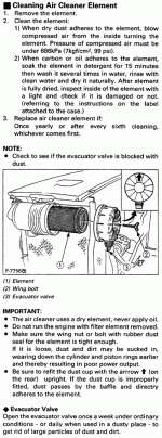

Bird, my manuals "imply" that it's for letting dust out, but the only verbage I can find just says to keep it cleaned out. I now have the operator's manual, the parts list, and the workshop manual, but none of them really shed much light on this subject.
In fact, I've attached the excerpt from the operator's manual which is the only mention I can find on the subject. My new mega-dollar workshop manual has the exact same diagram and text -- a little disappointing. /w3tcompact/icons/frown.gif
I just sent an email to the only local Kubota mechanic I know to see if he can shed any light on this. I'm starting to think that 2500's just hold their breath. /w3tcompact/icons/wink.gif
<font color=red>Hey!!!</font color=red> I just looked at the attached diagram again and noticed something that could be a protuberance sticking out of the bottom of the filter canister. You don't suppose...?<P ID="edit"><FONT SIZE=-1>Edited by Harv on 02/01/01 03:33 AM (server time).</FONT></P>

Except the BOTTOM! There it is... the big round opening under the air filter canister... the air intake!

Harv, I think you're on to something there. Looks like an inlet on the bottom of the main canister. I was going to get real fancy and mark up your .gif but I'm not that talented apparently.

Is this right?

Mystery solved, Harv./w3tcompact/icons/wink.gif Now you can see in the intake on the bottom of the cannister. I do wonder if it doesn't have a hose or tube attached that leads to some place where it can suck relatively clean, cool air in.
