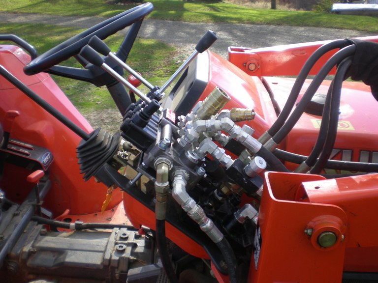

Another question, the L2501 has the power beyond at the rear of the tractor plumbed right back into the tank. What flow path or action would happen if you installed a closed centre valve? Would it be running then maxed out and push fluid through the pressure relief valve?... Just thinking ahead, trying to understand the system as best I can.
/ L2501 3rd function manual vs electric #9
Yeah, a closed center valve is the wrong choice to add to an open center system. You'll force all the pump flow over relief at high pressure when the valve is not stroked. Pump life will be measured in hours instead of the normal decades.
FWIW the stock PB from an L2501 loader valve goes to feed the 3 point hitch valve, not directly to tank. Do you have an optional PB loop intended to feed a backhoe?

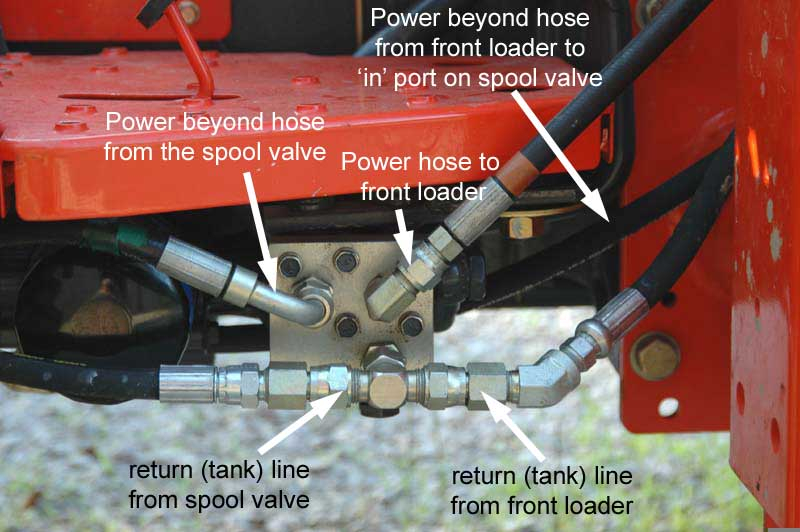

You can do all of your plumbing based on the info in the picture.

I am confused as to why you think/say that the PB is unused on your tractor. If you have a loader.....the PB off the loader is what feeds the 3PH. Look at your loader valve. 4 hoses with quick connects go to the loader. there should be THREE that go to the tractor. Of those three, ONE comes from the pump. The other two go to the manifold below the right floorboard like brian pictured.
The PB hose is what you need to supply your NEW valve. The tank line can be teed also as pictured.

I was referencing installation instruction from an electric setup, but it must have been for another machine. I do have the connections as noted by Brian.
