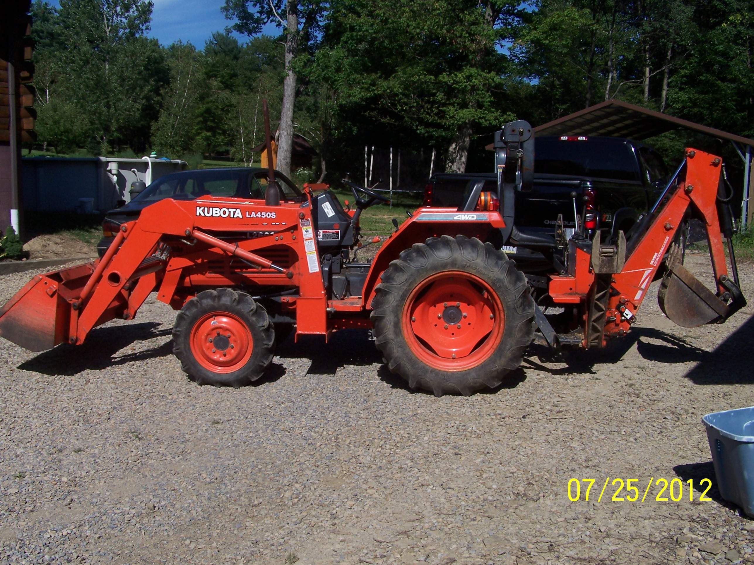

Well, I went ahead and bought it. ($12,500) I think I did pretty well on the price. Seems like a nice machine and only time will tell. Just wanted to thank everyone for their input. kubota 005.jpgkubota 004.jpg

Tundra,
Based on the pics I'd say you did very well - this machine will do a lot of work and not complain. For the price and hours you have nearly twice the lift capacity of the BX (450 x2.2KG = 1000 Lbs Lift in the bucket not at the pins).
Does this have the PTO pump for the BH or is it off the tractor? Also I think the FEL frame goes all the way back and attaches to the rear axle mount so this further strenghtens the BH and rigidity of the tractor. I see you have one in the shed too is that the Mistsubishi? Looks big - more like a ford front end.
Where are you in western PA? I was born in Kane, raised on a farm up there, still have some land in the area.
Thanks for the pictures - I think you made a good buy and have acquired a very nice nice machine.
