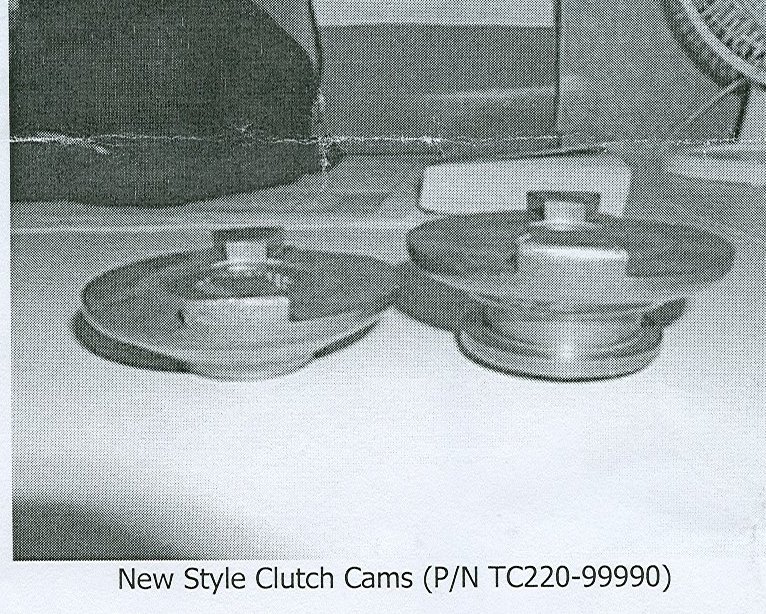

worse part is the dealer put the latest cable on and they didnt addjust it right so the PTO barly turned on and one day a few weeks ago as i backed into snow with the snow blower i was wondering what a very loud clicking sound was and why the snow was only going half as far as it normaly would at the RPM i was at. turns out they put it on so it would just barly engage and a nut loosend off and that was the end of that. now that i have the cable in the right spot so that it engages when the lever is about half way its still making the clicking sound but the PTO is spinning at the right RPM. was something damaged? should i consault the dealer about it? im not much of a person to have other people work on my stuff but part of the offer when the tractor was bought was free servicing at my home for the first 500 hours use of it so thats why they put it on. any ideas on this?
/ L2800 cables #4
You probably have the old style PTO clutch and if it is clicking while engaged I'd be very concerned. I'd call the dealer and tell them that they messed it up. That is a very bad mistake for them to make. If you have to replace the PTO cam make sure you get the new style one.

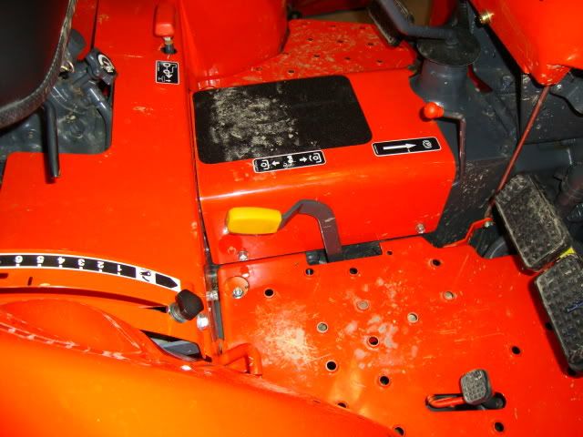

When you go to engineer your lever, if you need photos and measurements let me know. Mine has the lever through the rear of the deck close to the "hump" on the right side. I think the HST models have a flat floor deck? If the shaft going into the tranny is in the same place mine is, fitting a lever shouldn't be hard at all. I think Kubota moved the lever to the left on the HST's to declutter the deck on the right side, I have no HST pedal there to compete for space. I looked at the left side of the tranny last night too, thinking there might be a cross shaft coming through on that side, but there's not.
Do you have a picture of the current arrangement? I imagine the cable comes from the existing lever, through a bracket, to another bracket and another lever on the opposite side of the tranny.. a picture is worth a thousand words.

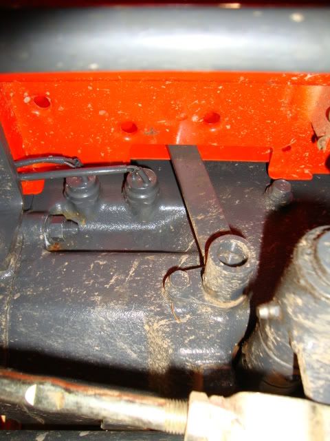

When this rain clears up, I'll see what I can do about a picture. The mention of the lawn mower cables is just what I was thinking of. They worked great with just a little oil every couple of years. I like the idea of a lever, if one could snake it in there. Make it stout and all it would have to do is attach to and actuate the lever on the side of the rear end of the tractor. Nothing like butchering up a nearly new, out of warranty tractor...
/ L2800 cables #15
This is what the gear drive setup looks like. Nothing could be much simpler, a lever (yellow handle) bent at 90 degrees with an end over a shaft...
That fresh out-of-warranty feeling is almost a relief sometimes, you say to yourself, "Finally I can change that thing that's been bothering me the past three years !"
