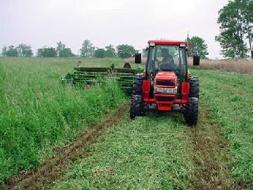

RaT:
It's always been my policy to vary the rpm on a new engine for the first 50 hours to seat the working parts. After that, I tend to run the engine at maximum rated rpm or just a little below that. The 5030 seems to run best about 2300 rpm. Sort of a sweet spot. It's just a seat-of-the pants feeling for me. I've been running the MoCo at that rpm. It equates to about 490-510 pto rpm. The 5030 seems to be right on the high point of it's torque curve there.
I forgot to include that my fuel consumption is better at that rpm than at max rated rpm which tells me that the engine is operating at it's best efficiency.
   / L3130 HST #23
I've added a picture to the above post. It's getting time to give it a bath.
Daryl
