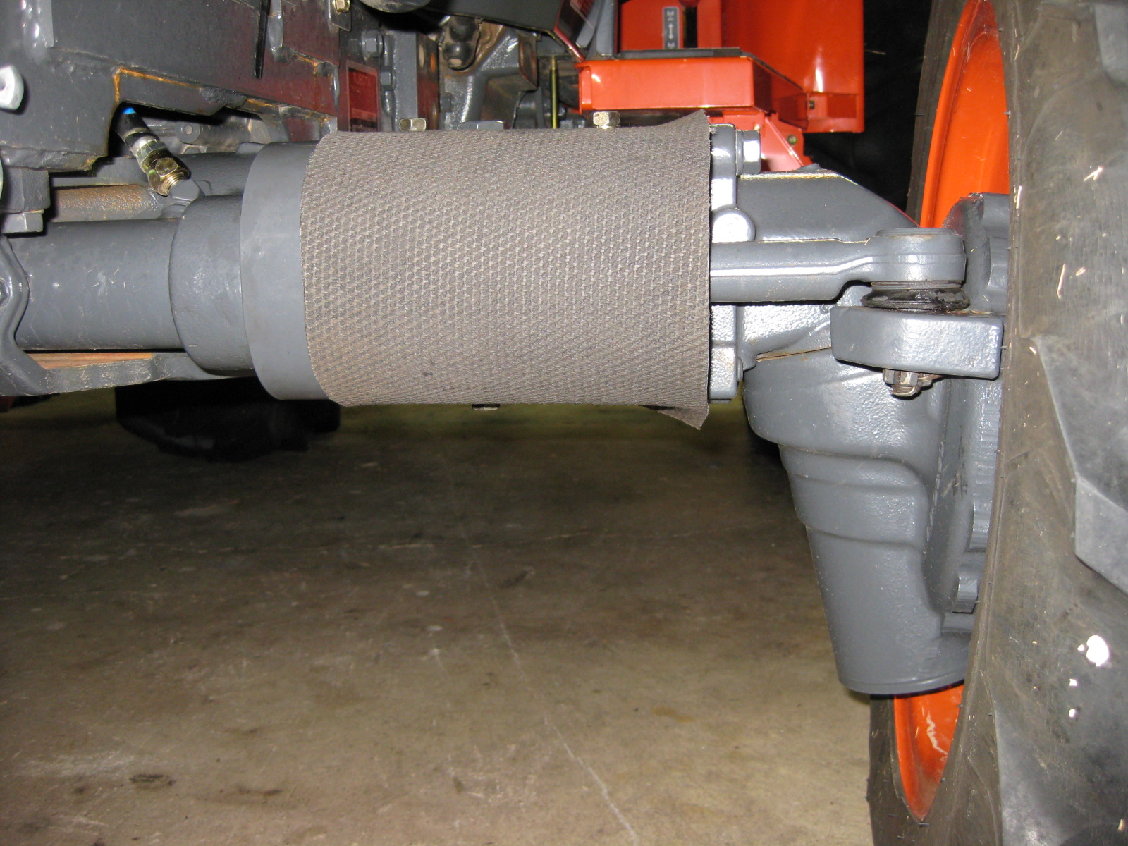

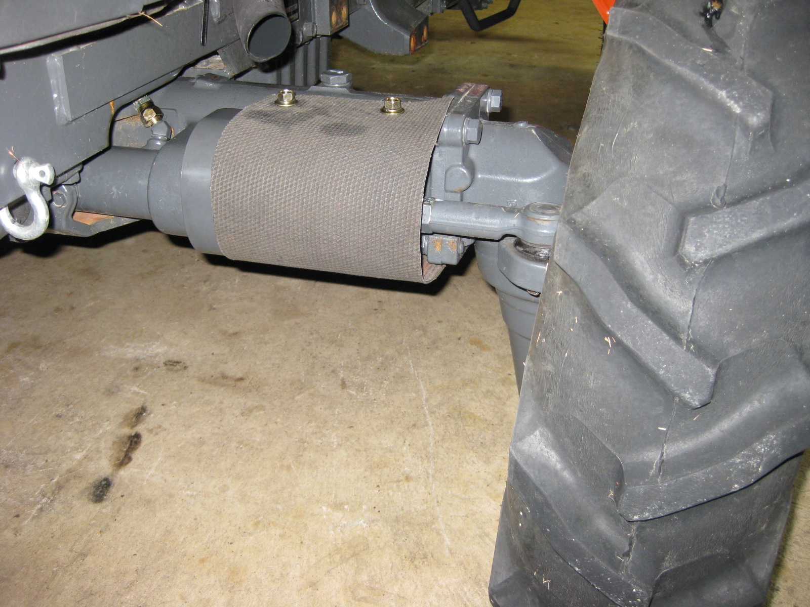

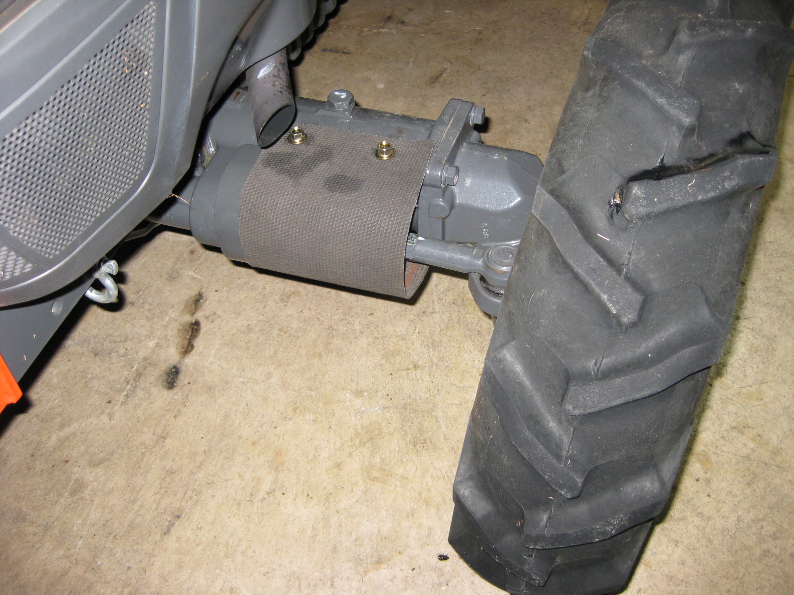

#27
Here is the guard I made tonight.. I will do a little trimming on the cover so it fits a little better. I used the factory bolts and holes. The converyor belt works good.. I will post the final product tomorrow night.. With pictures of the tires turned both ways. Wife said NO to cranking up the tractor at midnight.....:(

   / L3240 rubber boot ripped #28
Nice work - looks like OEM.
Based on my own experience, it probably should be OEM.

Hey Andy...That looks really good! I have messed around with conveyor belt material myself...but did not think to use it as guard material. My mind was stuck on mud flap material. Did you melt the ends to keep them from unraveling?
