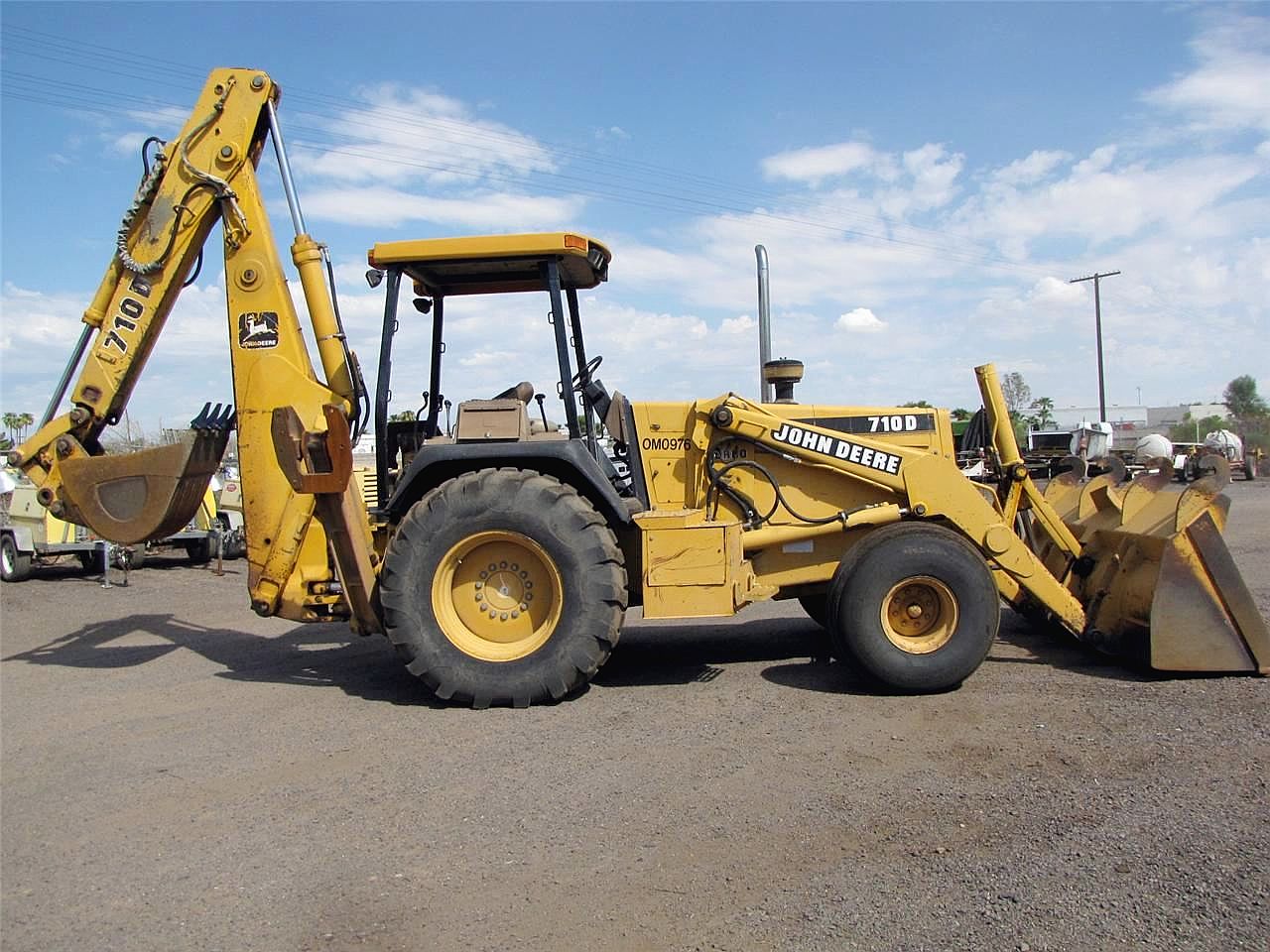

We never did find out how much a pallet of these bricks is supposed to weigh??
Because I am betting the MX and even larger grand L's wont lift one.
I get pallets of landscape bricks at menards. They are even hollow on the underside, so a lot of air space in a full pallet. And even them weigh 2500#
Which means you need a loader capable of about 3300# at the pins where they are commonly rated. That puts you in a pretty large tractor.
If this is a main priority, have you looked into the forklift attachments that go on the back??
LD1 maybe this tractor might lift them.:D
