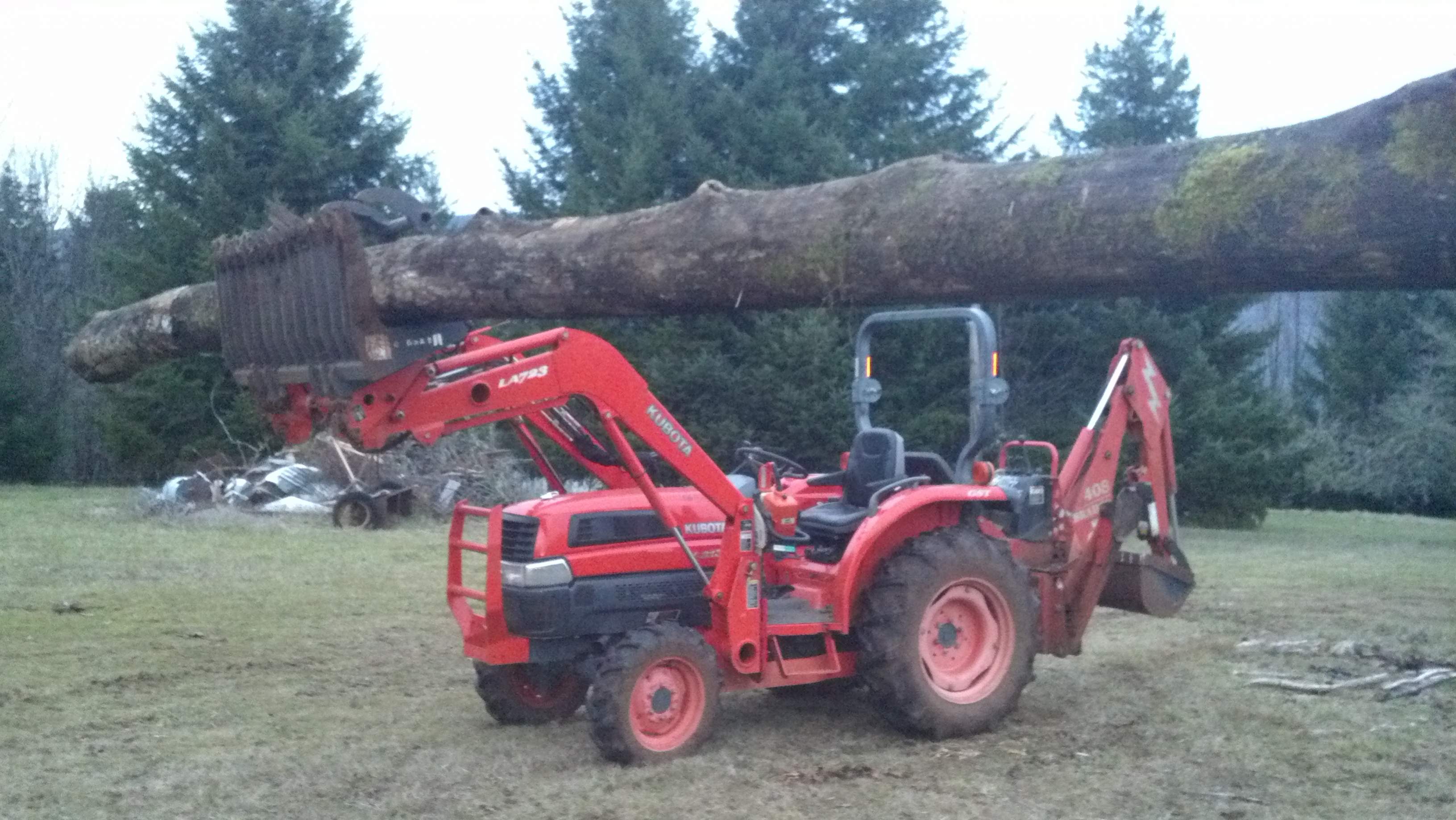

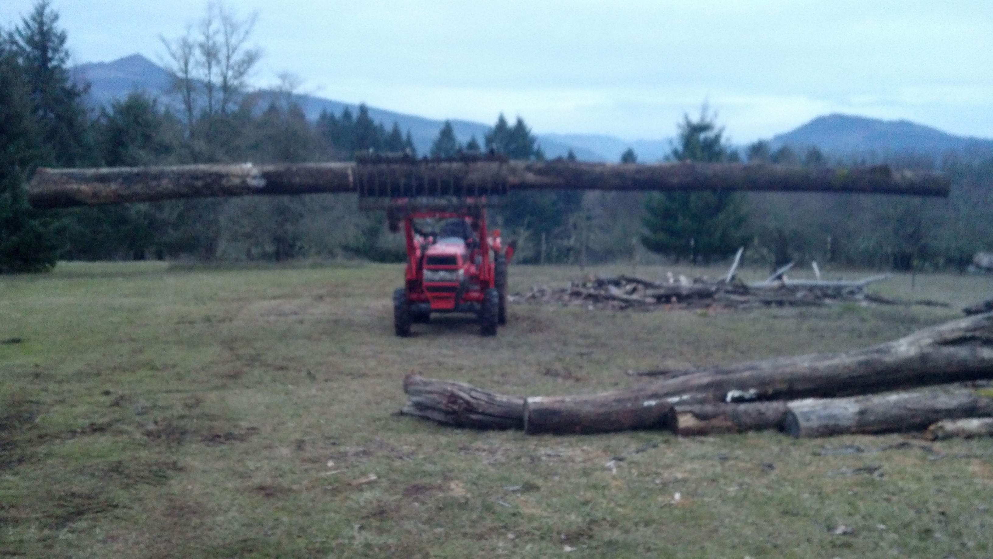

Another thing to consider is the Grand Ls have a better three point lift, heavier front axle and hydrostatic steering. if you want to put a backhoe on the mounting kit requires the 724 loader not sure what kit on the L4400. Also you may want to get the skid steer quick attach and a third function valve. If you are going to spend alot of time on the tractor the Grand Ls have more comfort and power for their size. Sometimes I am supprised on that the L3130GST with the LA723 loader and grapple can do when I move logs around.
