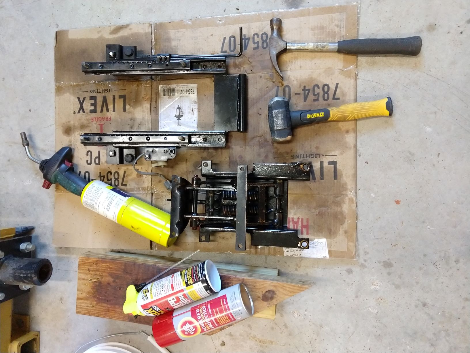

This thread deserves a bump. After reading it a year ago, I realized that my tractor actually HAS a suspension seat! And, theoretically, the ability to slide the seat back and forth. It was frozen up when I got the machine but I never looked at the seat closely enough.
So after reading here, I the removed suspension and slider mechanism. Stood on it. Used a pry bar. Pounded with hammers. Applied PB Blaster penetrating oil. Wash, rinse, repeat. No luck.
After trying everything, I got the bright idea of setting it on fire. A few rounds with a mapp gas torch to all the pins worked wonders (and if you're wondering, no it didn't damage whatever finish is on the metal). Once the heat loosened the pins a bit, the PB was able to work better. When it finally moved freely, I hit all moving parts with Fluid Film and it's been great for 6 months or so. I do keep it garaged so that probably helps.
Maybe someone else out there has a frozen suspension. It makes an ENORMOUS difference how long I can operate without stopping.

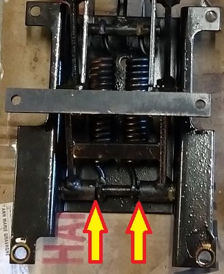

Update on my seat... Last year I had to insert a bolt to replace a metal rod that broke. First it was one side that broke and I had half ass fixed that, then the other side broke. So I put a bolt through it all. Using your photo to show the broken rod location... I guess I should lose weight but it's more fun fixing crap that breaks!! :D
