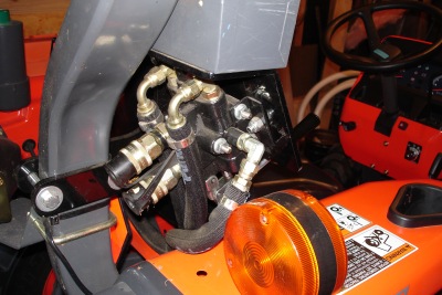

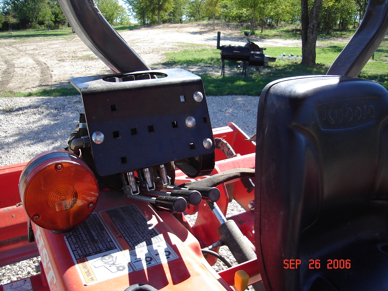

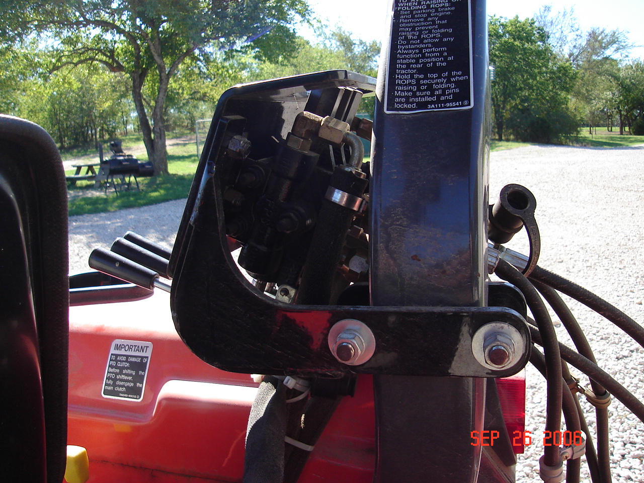

On my B2910 I used a 3 section Prince SV stack valve - cost around $200.00 If you don't want expandability you can use a mono-block valve - either Prince or another brand - with however many work sections you think you will want/need. Surplus Center is a good source:
http://surpluscenter.com/
You need a open-center valve with Power Beyond, designed to control double acting cylinders. Generally folks use a spring-return to center, although some have used worksections which have detented and/or float positions.
For the toplink cylinder I sourced mine from Mark Carter @ CCM, a TBN sponsor:
http://www.ccmachinery.com/TNT.htm
I think it was around $165.
On the side link I got lucky and found a brand new Gannon/Tisco HSL2202 on ebay for cheap - think it was around $65. CCM also carries sidelinks but I don't know what the their stock status is on either top or side links.

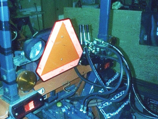

I have my valve mounted on the left side of my ROPS - I'm not including a photo because I'm not happy with where or how it is mounted. I plan on remounting it on the right side, on the ROPS - but with a different orientation. When I get it done I ill upload a pic but it won't be any time soon. For the valve mount bracket it helps if you can weld - If not source it locally.
Adding the remote valve isn't really that daunting of a task - the biggest thing is figuring out what fittings you need and how you are going to route the hoses. With some forethought you can probably cover the fittings pretty well though chances are you will overlook something and need to source a fitting or two locally. These guys are a good source for fittings and hoses:

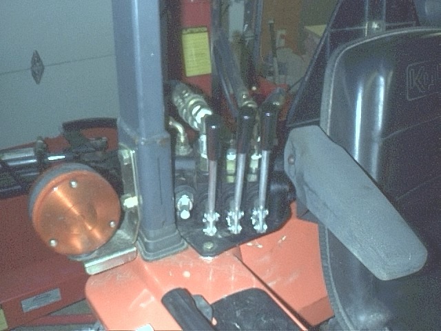

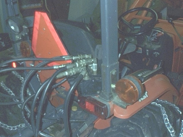

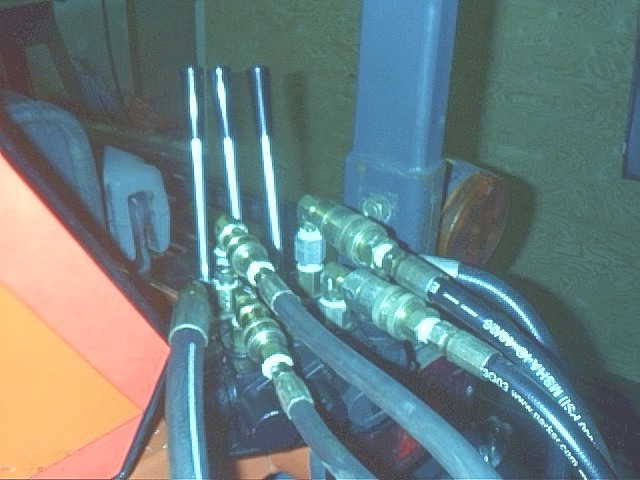

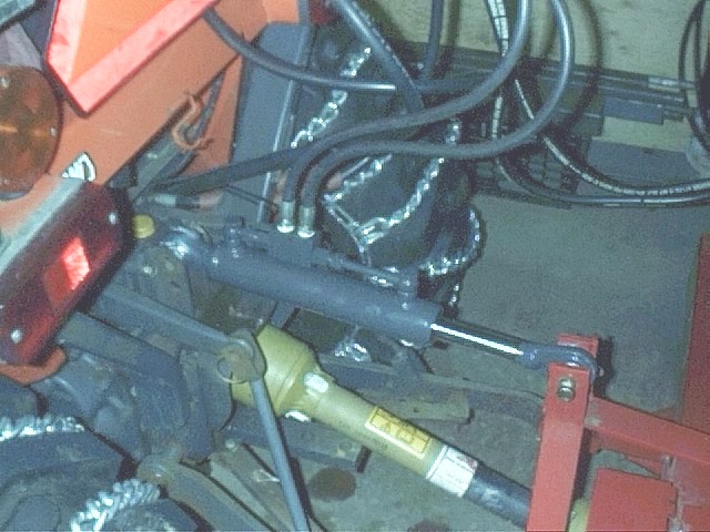

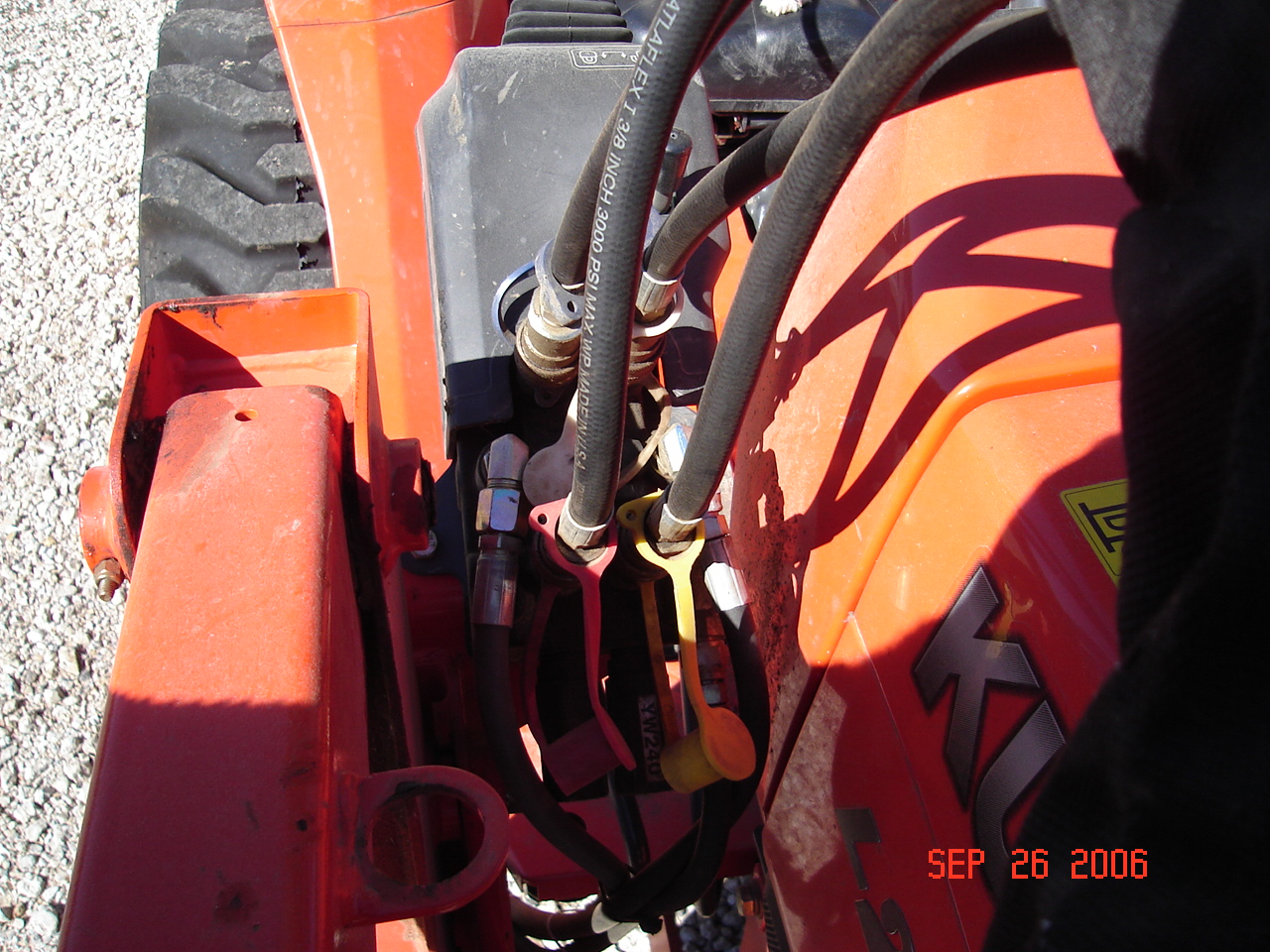

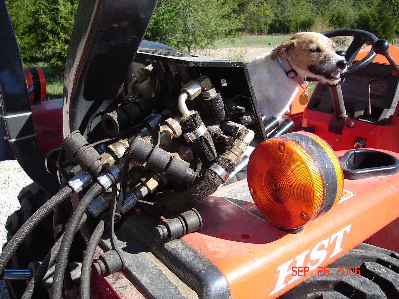

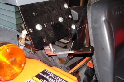

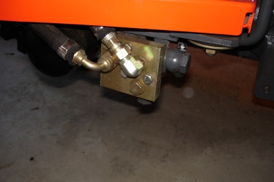

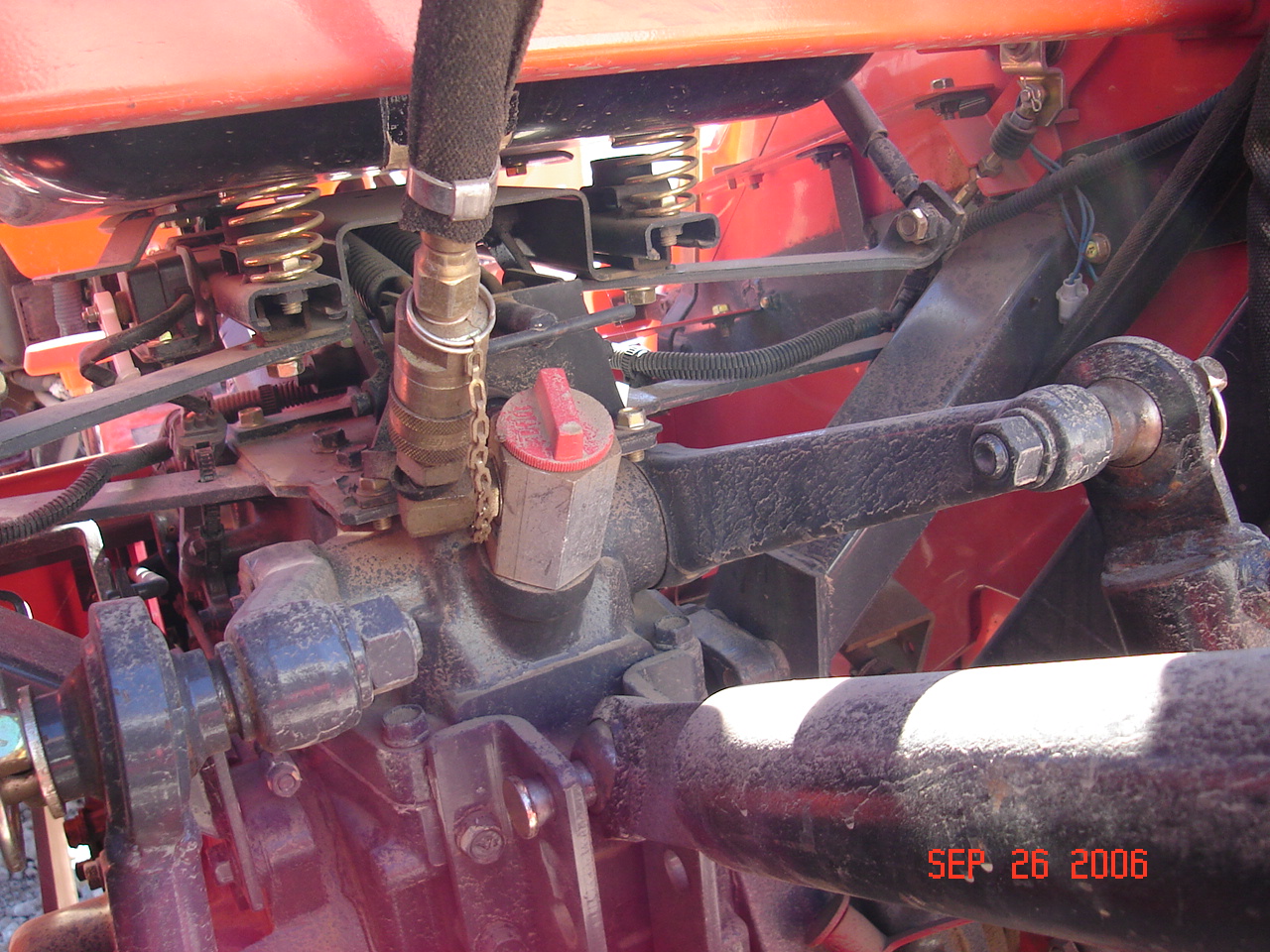

rswyan pretty much summed it up.
Here are some pics of my setup. I used the Prince SV valve with 3 spools. You can read about it HERE.
I will be more than happy to tell you how to plumb the hydraulics. I have posted instructions many times. Anybody with any mechanical skill can do it.

That valve with the power beyond option should work.
Simply stated, a valve with power beyond will have a seperate outlet for return to tank so that neutral pressure fluid that is exhausted from the cylinders via the works ports goes directly to the tank/sump and not put back into the pressure flow. This alows fluid not used by the work port to pass thru the valve and continue on to the next valve in line, thus providing constant flow to the next valve (the one beyond) in line.
canoetrpr said:

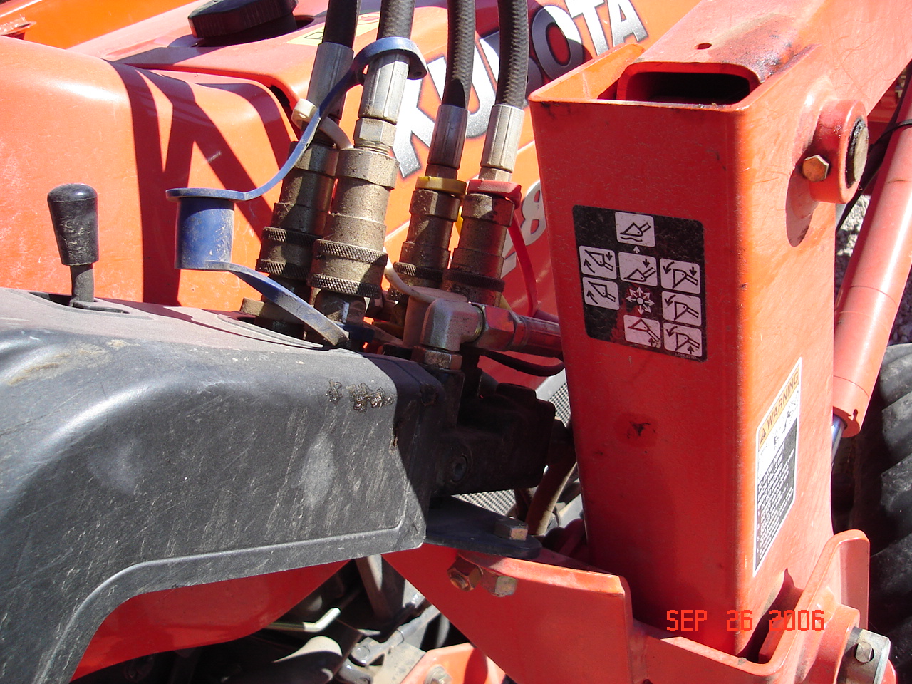

I studied how the hydraulics are routed to the loader valve. I see 3 hoses that tap in to the tractor's hydraulic system that provide fluid to the loader valve. There appear to be 'ports' for more hoses to be connected to the spot that the loader valve gets its hydraulic fluid from. Not sure what this spot is called but I am guessing this is where I would have to tap in for the input of my remote valves and route hoses from there to where the valves will be located (right hand side on the ROPS).
Those are the caps for the load checks. They are NOT ports. There is a poppet and spring under those caps. Once again, valves MUST be connected in SERIES with each other. I just posted in another thread the proper way to hookup an aux valve for remotes. But I will do again here just for you:
  1. disconnect the loader valve's power beyond hose from the tractor hydraulic block. This will most likely be the hose that is on the left nearest to the rear of the tractor (see owners manual).
  2. using a new longer hose or a short hose with a union fitting, connect the just disconnected hose to your aux valve's pressure inlet.
  3. connect the power beyond outlet of your aux valve to the tractor hydraulic block where the loader hose was disconnected.
  4. connect the return to tank outlet of your aux valve to the transmission sump. Use a tee fitting and connect it to the same place where the loader valve's return to tank hose connects to the transmission. This is the only line that may be teed.
  5. your aux valve is now ready to use.

My hoses (Press & return) on my L2800 are on the hyd block on the R/H side just in ft. of the hyd filter.
Mine was set-up initally for my BH, when I use my T&T there is also a bypass hose that comes off the spool valves that dumps into the hyd fill port just behind the seat.

Your naming terminology is slightly off. The two hoses on the hydraulic block are the pressure line form the pump and the power beyond from the valve. The line that dumps into the port just under the seat is the return to tank line. The return to tank line is the only line that can be teed together with another. All Kubota loaders are plumbed this way.
