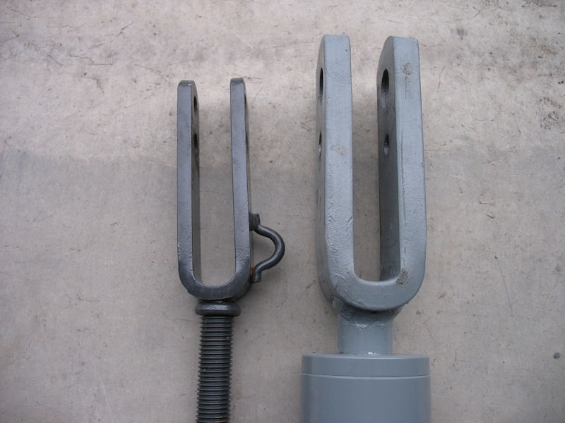

Yup, I talked to Mark @ CCM and I'm going to take some pictures for him and then I'll have to send my side link back to be modified.
If you look at your side link you'll notice the bottom fork on the stock one is angled to line up w/ the lift arm. My side link from CCM does not have this angle so it binds up when connected to the lift arm. Plus, the hole size is not right. It's got like a 3/4" hole instead of 1/2". I'm gonna measure the hole, I think it's actually 13mm so I'll ream it out when I get it back if that is the case. But w/out the fork having the proper angle the geometry is all wrong.

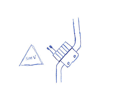

Attached is a napkin drawing of where I'm gonna put my valve. Once I flipped the handle to face towards the back of the tractor I actually liked it up there. Well, I liked it out of the possible places I could think to try it. Flip your handles and place it up there and see what you think. Since I've got to send my side link back nothing is written in stone or welded in place :) That view is from behind the tractor, looking at the SMV sign. Don't laugh at my drawing. Simple to make. It's 3 flat plates welded together and 5 screw holes. KISS method.

StrangeRanger - sounds like a nice setup. I already had a welder over who measured the straight portion of the ROPS to build a bracket for so guess I'll have to stick to that :)

Ya, I liked the straight area section mounting idea too, but when I held the valve there to see what it was like, it obstructed some of my view. Either place will work great though, just personal pref :)

My side link is the 16.5" but I believe you're remembering incorrectly, it has a 4" stroke.
The top hole is 3/4" and I just measured the bottom pins w/ a caliper and they are actually 13.85mm, so just a hair over 1/2". I told Mark I'd like a half inch hole and I'll ream it out the rest of the way. Plus, I've got to source a longer pin or bolt as the fork on the new side link is about 1,000 times beefier than the stock one. See pic below. I just hate waiting, but I'd rather wait and get it done right eh.

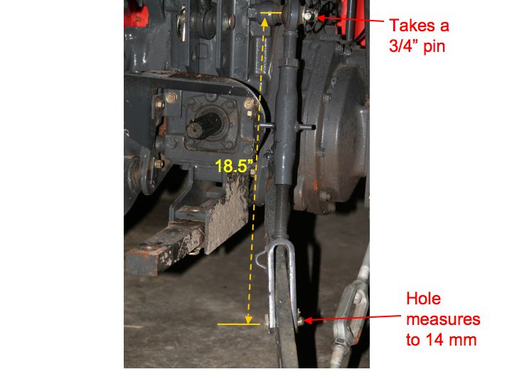

Hi StrangeRanger:
You are right - that was a typo. It is 16.5" with a 4" stroke. You are right - I will need a longer pin too. 1/2" pin should be quite easy to find I would hope.
I've posted a picture of my sidelink that I sent Mark with measurements.
I don't have calipers so I measured with a goodly tape mesure - figure I came pretty close to the real size with 14 mm :)
