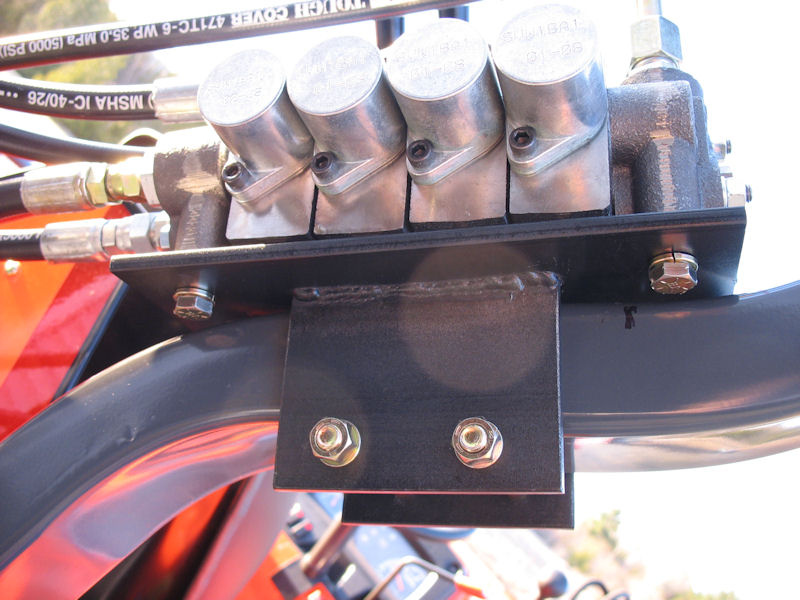

Canoe,
I'll take some pics tonight when I get home. My bracket is very simple, 3 small pieces of 1/4" steel welded together and bolted to the ROPS. The steel cost me $11 (cut to size) and a tin of Skoal to get my buddy to weld it. Literally took him less than 5 min to weld it. The hardest part was drilling the holes so they lined up right w/ the valve assy as my final dimensions were a tad off from what the spec sheet shows. I think that's due to everyone tightening down the valve assy a little differently.
If you don't hear from your guy and like the way mine looks I can send you some drawings and you'll see how simple it is.

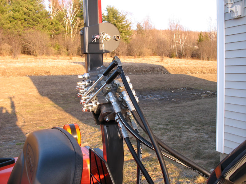

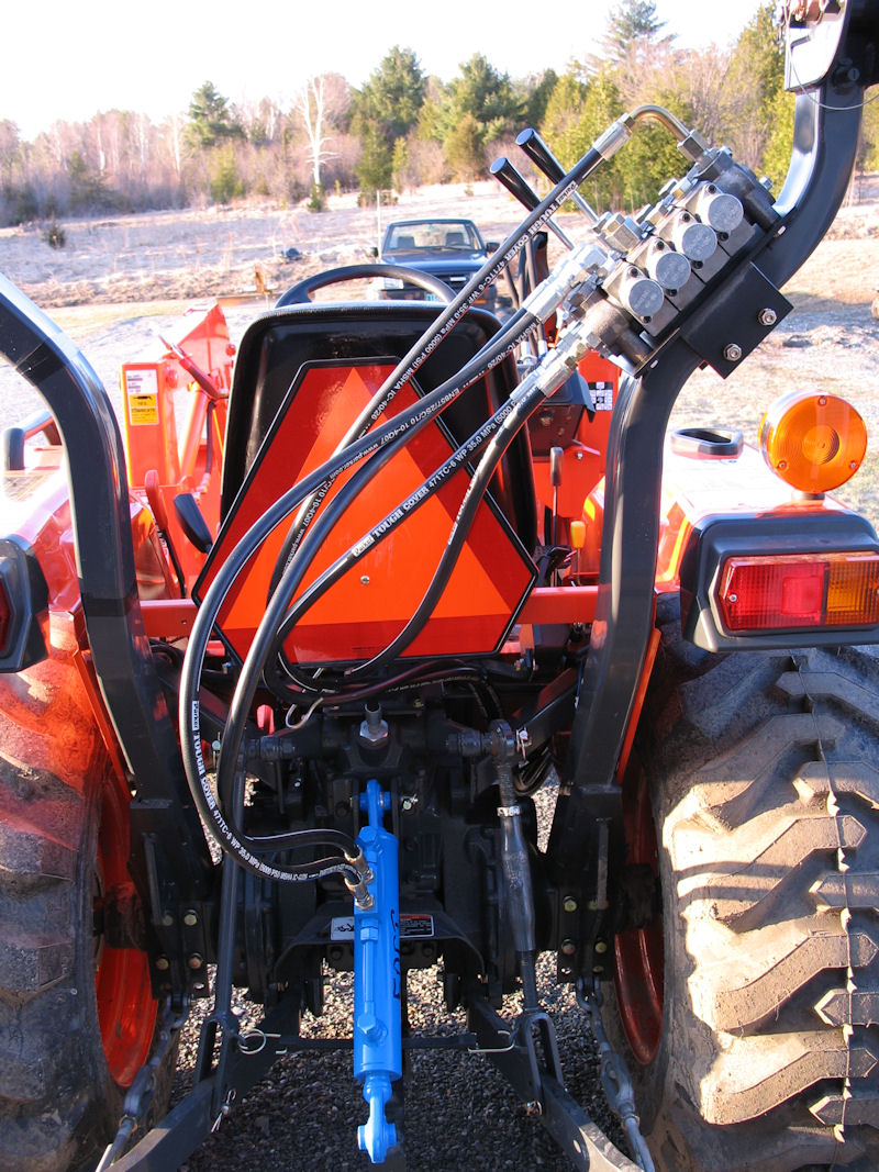

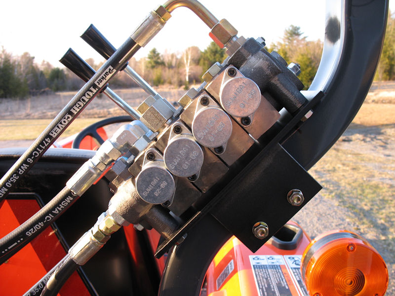

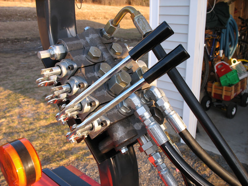

Finally got a chance to snap some pics last night. I know, my hoses are a little long, but I was afraid of getting them too short and then being screwed.
If you look at the valve assy you'll see a set of "risers" next to where the top link goes in. That's where the 90's will go for the side link when I get that back from CCM.
Now I gotta see if I can add a cylinder for my rear blade angle :)

Per your request here's the mounting plates. As I said before, I used the KISS method. Very basic.
The 2 side plates were simply welded to the base plate, I believe they were 78mm apart. Then I used 2 3/8" x 4" bolts w/ lock washers and nuts to secure it to the ROPS.
The long hole spacing distance on the base plate is the "tricky" one. According to Prince's drawings this distance when you have 4 work ports should be 7.187" between the mounting holes. Well, mine wasn't or I didn't drill exactly right :) I had to fudge one of the holes a little bit. Oh, and I used 1/4" plate steel so 1" x 3/8" bolts w/ lock washers worked great for mounting the valve assy to the base plate.
Let me know what you think.

SR:
Really appreciate the photos. You've got me all juiced up now.
Irritated that my mounting plate is taking so long. In hindsight I should have bought a chopsaw and some steel, cut it to size myself and drilled holes myself using my neighbours drill press and then taken it someplace to have it welded.
I like the mount location. Another one I thought about was on the angled part of the ROPS but rotated 90 degrees so that the work ports are along the rear of the tractor. This can be done with your mounting plate as is just by rotating. You will have to move around your handles again so that they are accessible if you do that.
I imagine that whatever my mont plate ends up being, I can get it to fit on that angled part of the ROPS instead of where I had originally planned it (the location of the factory valve).
One thing my mount guy is doing differently from yours is that it is two pieces welded together and the third piece is loose but secured with the pressure of two bolts when mounted on the ROPS - as is the case with the factory one. But no real difference as both work just fine.
