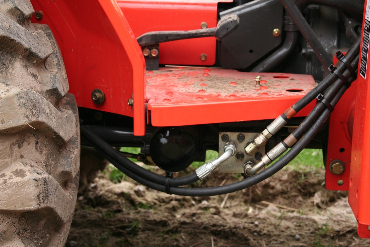

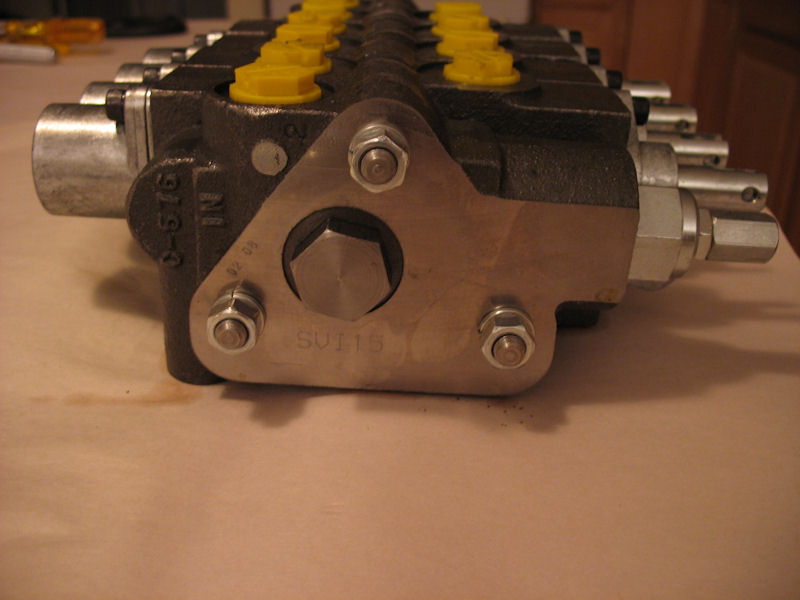

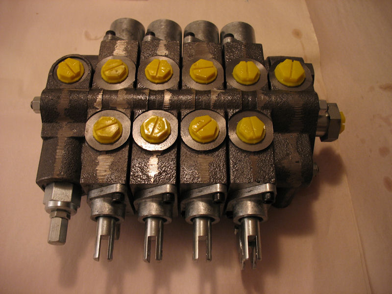

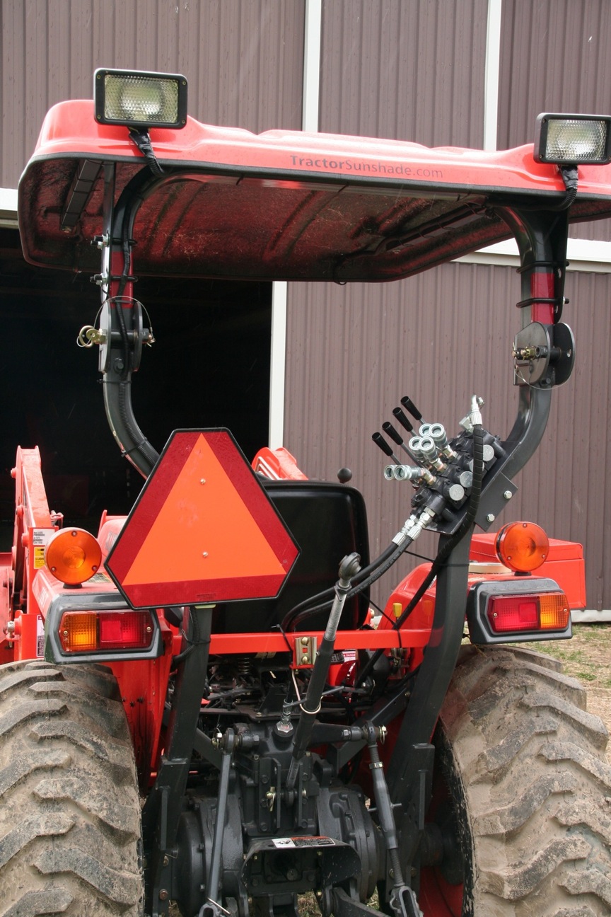

Still waiting on my cylinders but I finally got the fittings I was waiting on for my valve and QDs. :)
Hooked it all up today and fired up the tractor. No leaks whatsoever (yet).
Noticed the hyd fluid level is low - makes sense given the extra valve in the circuit. Hopefully the cylinders will be here next week and I'll get to test the spools out.
Here are some pictures of the valve install and ones that show the plumbing to the hydraulic block.

Hey Canoe, looks awesome! You're more particular about the aesthetic details than I am, I like the way you've painted everything.
I noticed you've got 3 sets of QD's on there, have you found a use for that 3rd port already? :)
Also, just so you know (if you care), the FEL BPY line will fit up over the filter. I had mine like in your pic, but didn't like hoses being down and exposed like that. I'm not sure how or where you use your 3400, but I'm always in the woods and brush and felt those lines were just ripe for the plucking by a stump or log. I ran my FEL BPY line up over the filter and then zip tied that line and the BPY line from the valve assy together. Then I ran a hanger line over the bolt where the fender and floor board attached and hung the lines there. That way they're tucked up inside a bit more.
I have to redo mine b/c it was a test fit and I want to redo all my zip ties w/ some abrasive cloth or something so the ties don't wear the lines.
Sweet looking install you have man!!

SR - I'm pretty much 100% in pasture but I'll see if can't get that hose routed above the filter.
Good idea on using an abrasive cloth. I've got to redo my zip ties anyway. I didn't have big thick ones so I used ones that are a little too skinny for my liking. I like the material they use on the FEL hoses - I think it is called a 'hose sock'. I'll see if the hyd store carries some when I go there for my cylinders.
The only thing I don't like about the setup is that I wish I had routed the return to tank to the hydraulic block and teed the fitting there. I had to top up my hyd fluid and had to undo the port on the tank to do it.

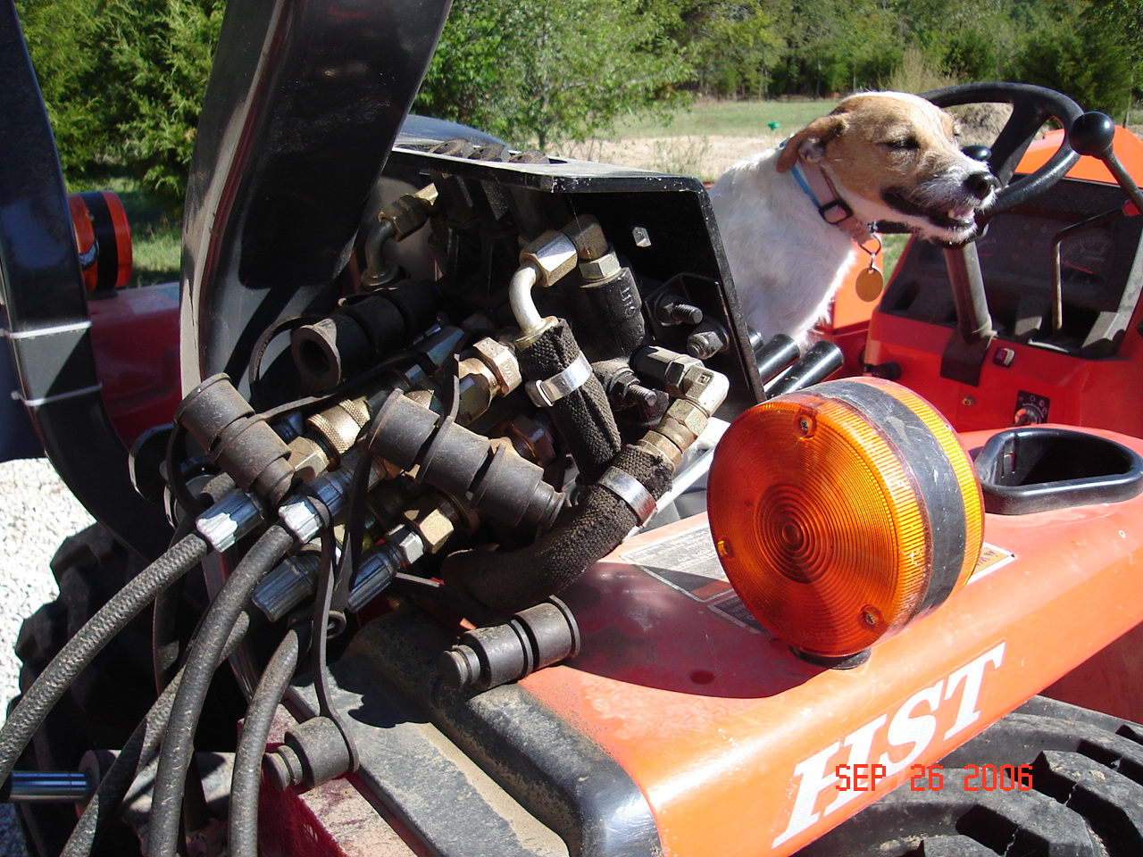

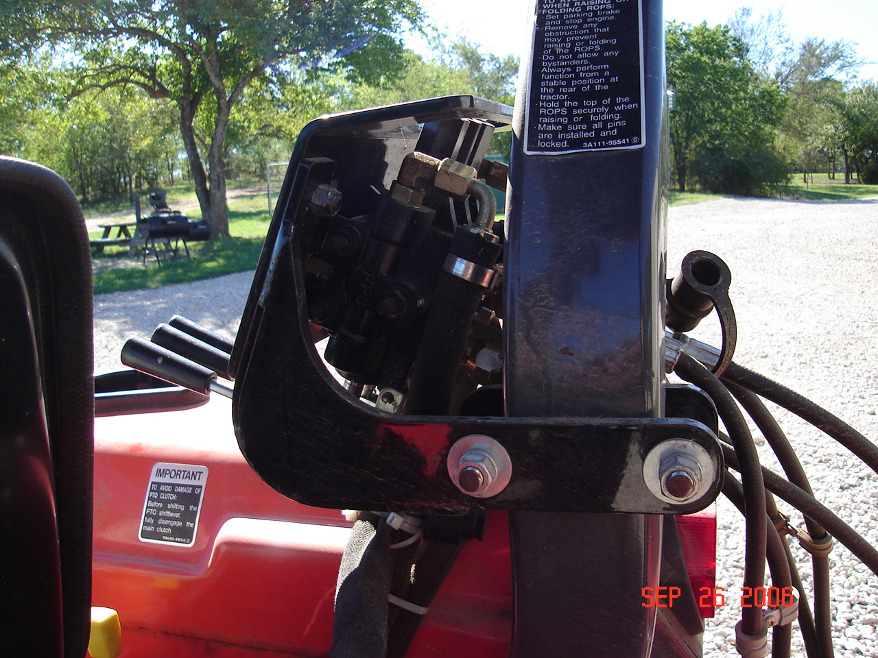

SR - if you have a chance, post up a photo of your setup around the hyd. block. Even if I moved my pb hose from the loader up, I would have to move my return to PB from the valve around as well so it wasn't exposed. Just wanted to see what you had done.
   / L3400 CCM hydraulic top link length #88
I'll try to do that soon Canoe... I've misplaced my camera. No, actually, my son has displaced my camera :)
But basically my pb hose goes over the top of the filter. My return line and pb line are zip tied together and pulled up and back by another zip tie that hangs down from the bolt between the fender and deck. Hmm... let me find that dang camera...

Got the cylinders yesterday and they look fantastic! Got 1/4" hoses and fittings and hooked them up today. I've only tried out the top link so far as I painted the side link and was waiting for it to dry.
Works awesome. No leaks whatsoever. For a first hydraulic project especially for someone who isn't too handy, this has worked out really nicely. Thanks to TBN. I have myself a scare the first time I tried the top link as it didn't move but I could hear the valve trying. Turns out I didn't have one of the QA's in the QD enough. You've really got to push those things in.
Mark even included a larger pin for the side link cylinder since the clevis is beefier than the clevis on the OEM adjustable side link... that was a nice touch.
I also fixed up my hoses around the hydraulic block as per your recommendations SR. Much much better!
Can't wait to try out the side link tomorrow! Will post pictures tomorrow.

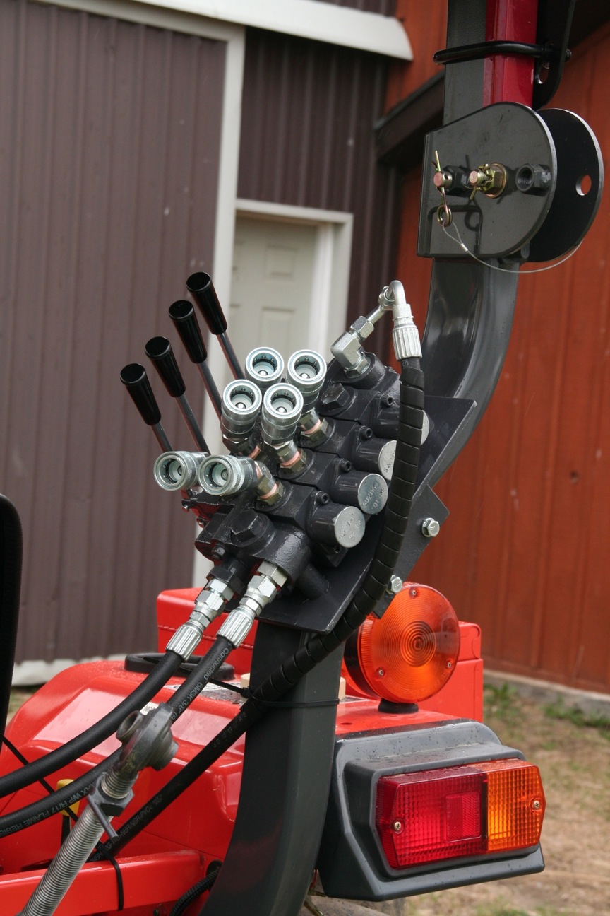

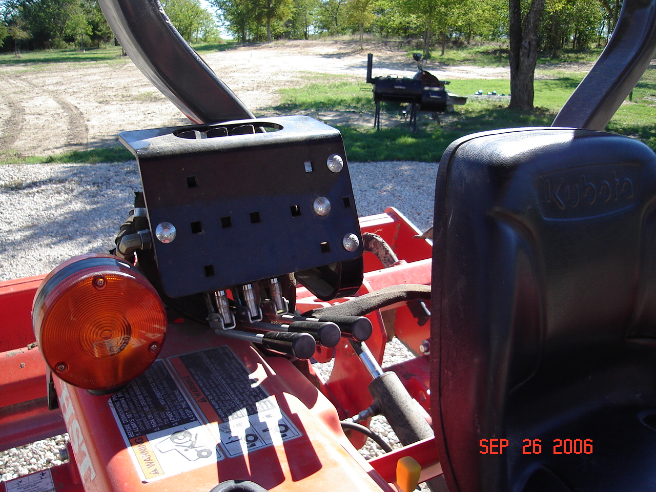

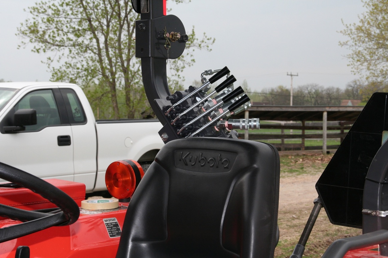

StrangeRanger said:
Finally got a chance to snap some pics last night. I know, my hoses are a little long, but I was afraid of getting them too short and then being screwed.
If you look at the valve assy you'll see a set of "risers" next to where the top link goes in. That's where the 90's will go for the side link when I get that back from CCM.
Now I gotta see if I can add a cylinder for my rear blade angle :)
