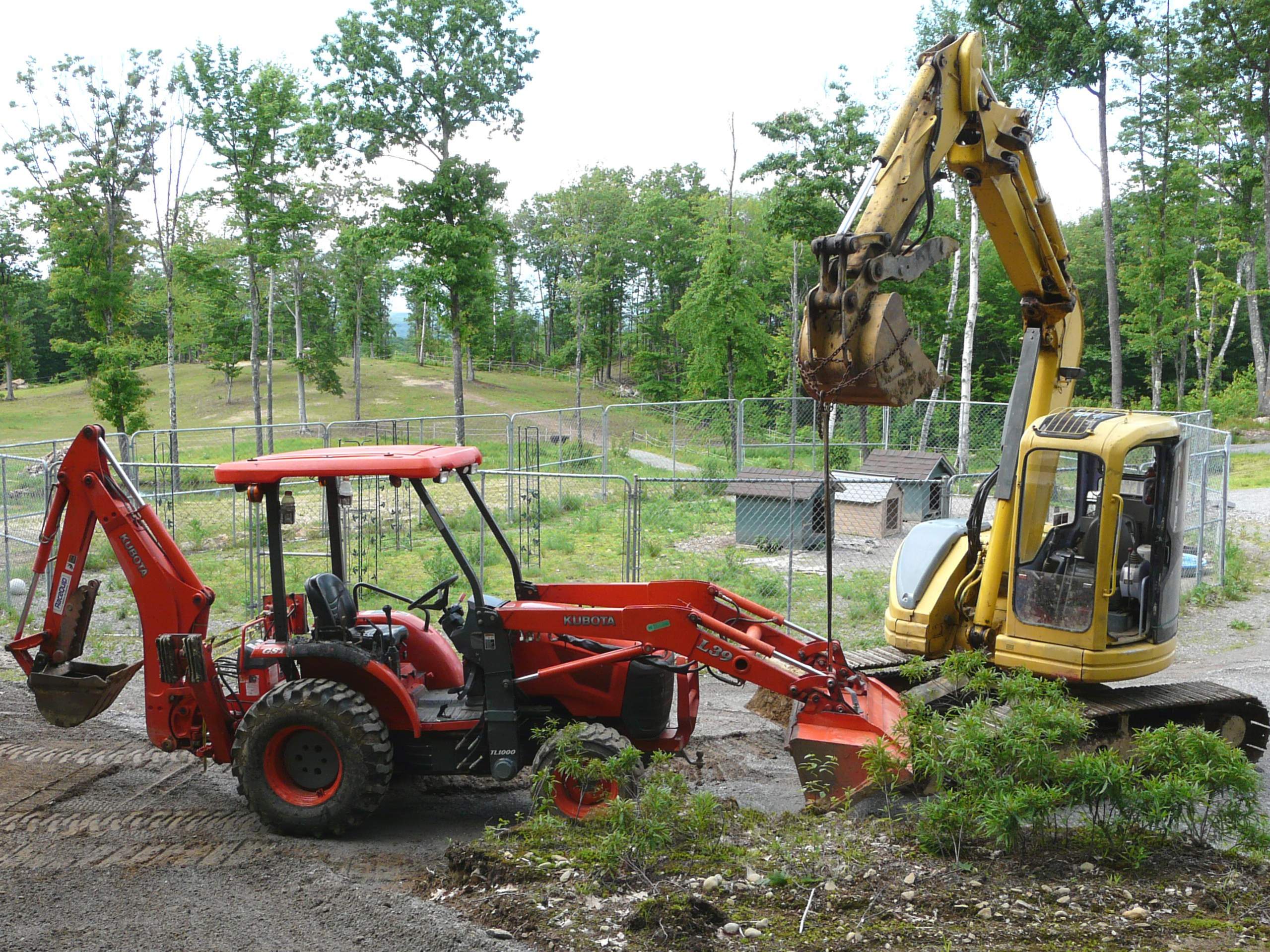

Without my added accessories like a thumb, my PC75 machine is nameplated 8150 KG or 17,962 Lbs. I figure another +500 Lbs for the thumb. Steel tracks and the articulated boom add weight to the 7.5 metric ton designation.
CAT had to change their model 330 to 336 because through the years their (30 ton) machine gained a few pounds, (Like us) Truth in advertising for the guys who didn稚 want to overload their transport. I think CAT came out with a 329.

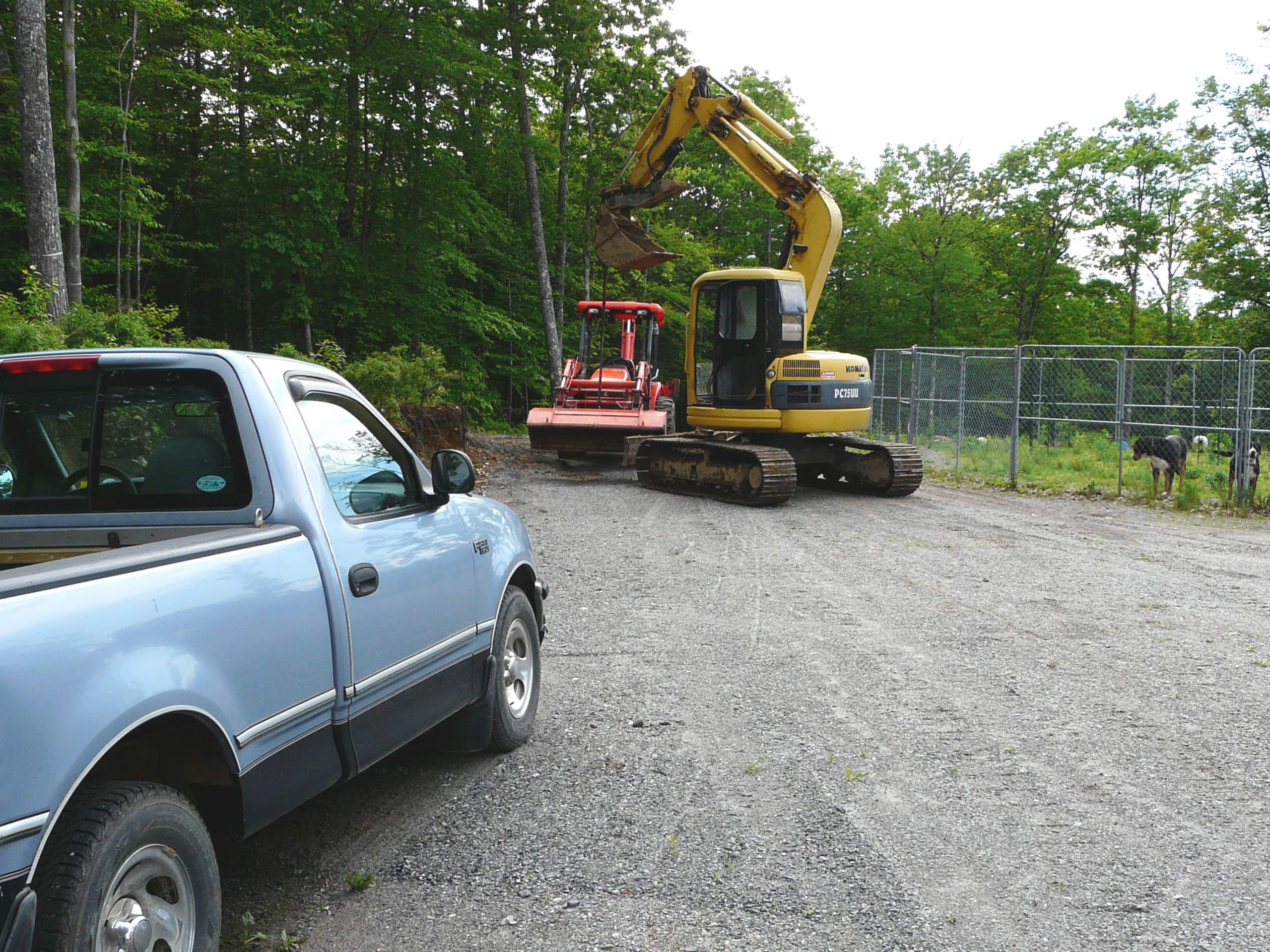

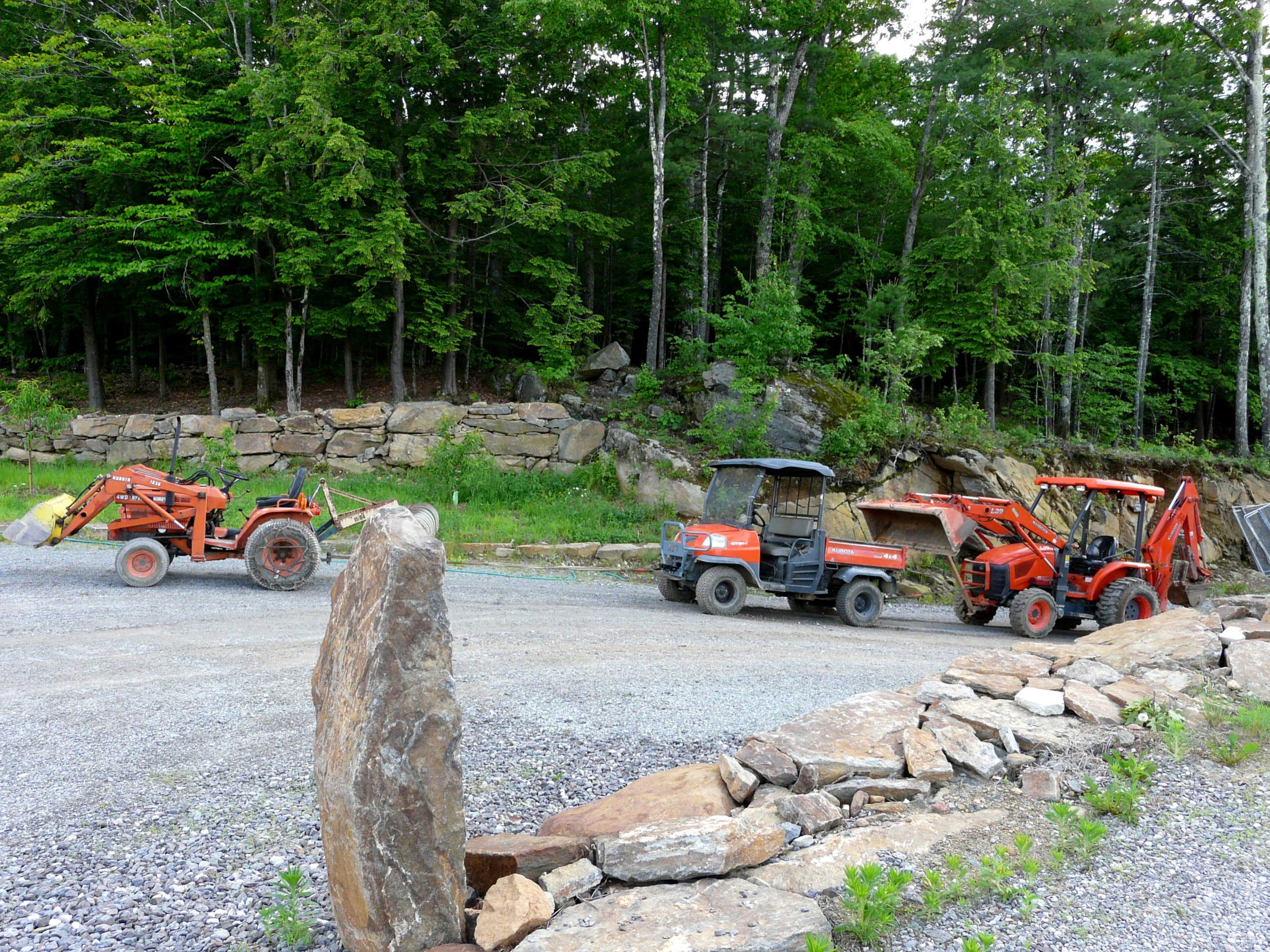

On my L39, I've added inner and outer rear wheel weights, filled the loader tubes with 4" dia. slugs of steel, added front end weight, a thumb, plus lots of bucket I boom reinforcements bring the weight of the machine to just over 8,000lbs.

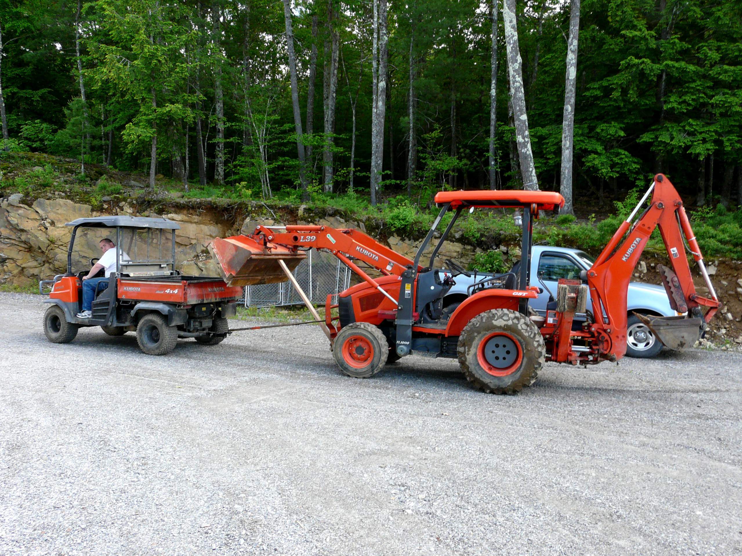

My stepson was disappointed that his RTV 900 just dug a hole in the driveway as he tried to pull it up the hill. I was trying to avoid damaging the drive using my excavator, but he did a good job anyway.
Together with the B7200 (loaded tires and about 300 Lbs of steel bolted to the loader frame, managed to pull my L39 up to my equipment building.

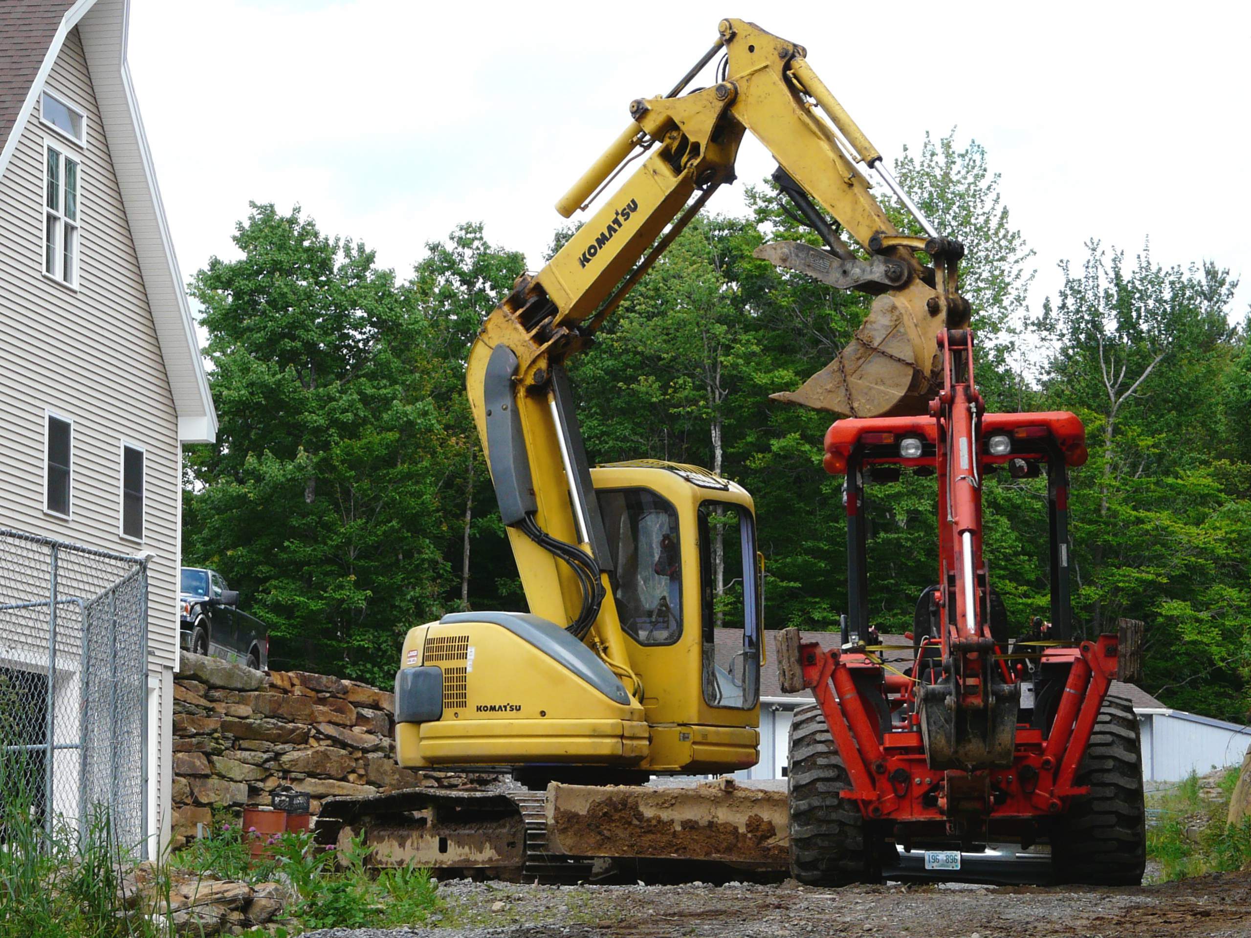

I'll try to get it towed to the dealer tomorrow.

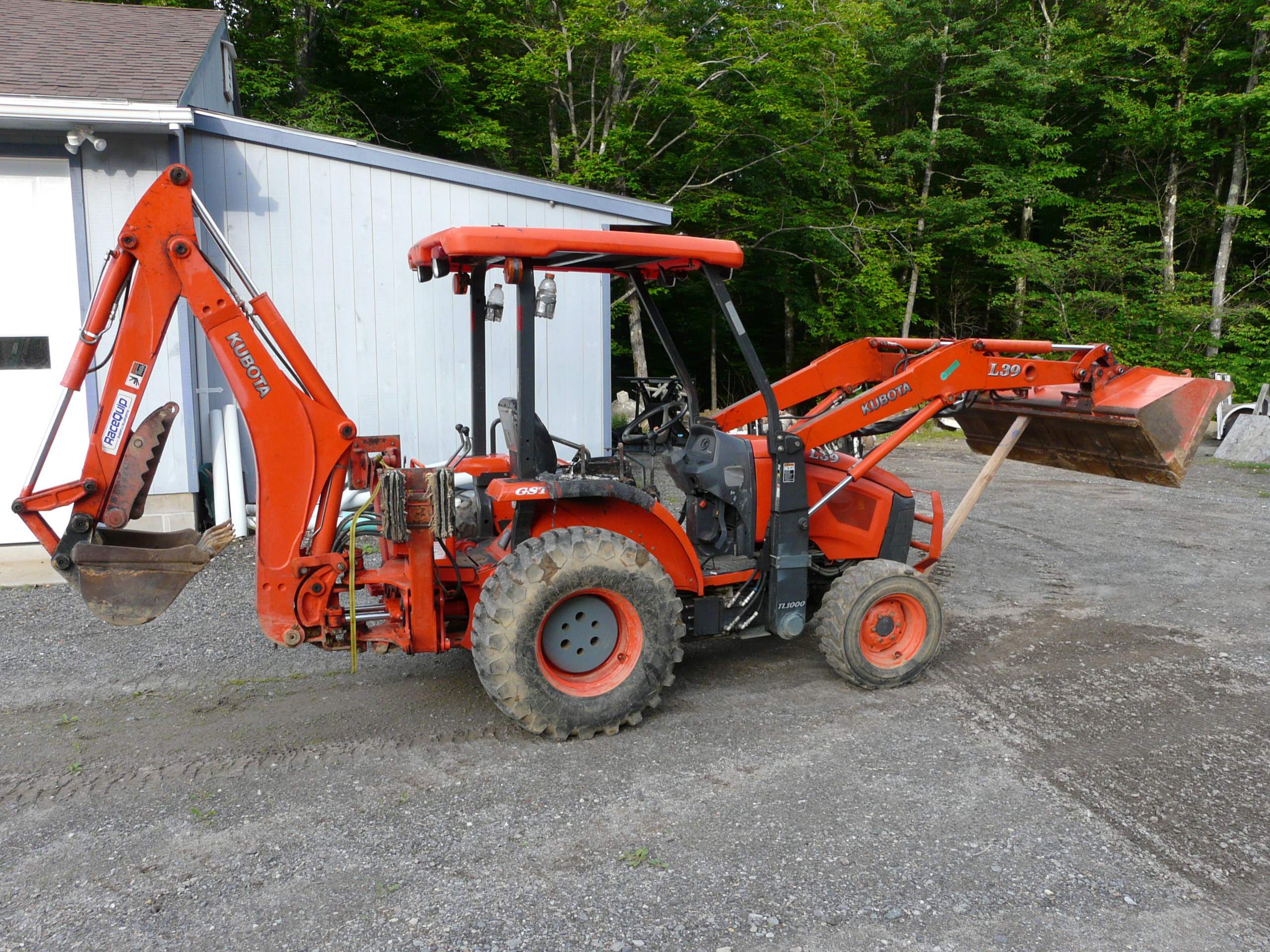

Just a quick update.
We noticed around the house other electrical issues. The TV lost its HDMI board, the Garage door opener circuit board failed. And some florescent lights on sensors burnt out. I've left the tractor outdoors many a night without a problem.
We had a near miss lightening strike that may have caused an electrical pulse resulting in all these items failing and the tractor circuit board catching on fire. The fire sure seemed centered around the control panel.
The computer in the excavator is in a heavy metal shielded box behind the seat. The Kubota control boards are in a plastic enclosure. The garage door opener that failed has plastic end covers where the board mounts, my equipment building has an all metal opener that was not affected. Back of TV is plastic. Maybe plastic vs. metal enclosures had something to do with which boards were damaged and the other electrical issues.
I have $2,500 homeowner deductible, so this is going to hurt. About $6K in damages. Supposedly, dealer was to order the parts.
I want my tractor back.
