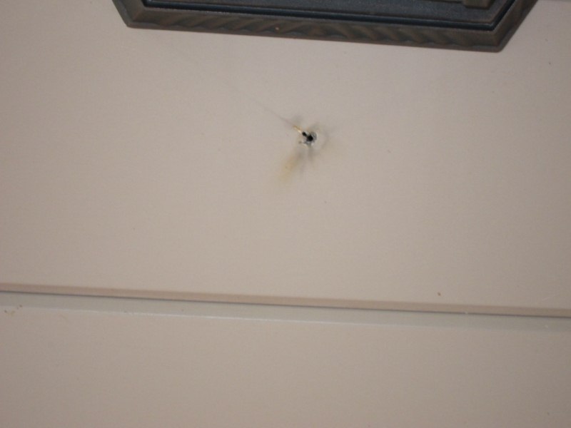

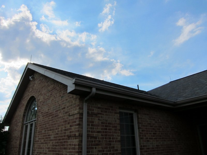

If anyone knows about lightning strikes it's me. This house has been struck 3 times. Once it blew the chimney apart (was before we bought it) and they had to rebuild almost the whole thing. 2nd time it took out the tv, furnace, satellite dish, refrigerator and microwave. 3rd time took out the computer, a couple of routers, the garage door electrical bd (btw, that's a cheap repair look up the part number from the board on google and you'll find a cheap easy replacement) along with the alarm system, and it blew out my X10 light switches too. (see picture attached of the short it took between the light fixture and the ground aluminum soffit of the house) Yes, that's a hole in the aluminum from the lightning arc. It had a different light fixture there and i went to replace it and found the hole and arcing marks. We're lucky, it hasn't burn't the house to the ground. We do have a number of lightning rods to stop it but it's still a problem here. A number of the neighbors have been struck as well. It's lightning alley for sure here.

It was not a direct hit on the tractor or house. Insurance is treating it as one claim. Rodents would have been covered too. Real cause is not 100% certain, but too many coincidences, sure does point to a bolt from the blue. Pictures taken and adjuster saw tractor and is working with Kubota dealer. Garage door opener is fixed with new board installed myself, debating on TV repair as we still have component video. Whole house faraday cage is a good idea!
