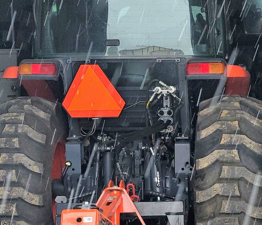

That's the cylinders, not the remote kit. I have a hydraulic top link with the pilot valve hooked to my rear remote (L4060HSTC) and it never moves.
Brian generally doesn't mess with manually actuated valves for cabbed machines I don't believe. He also warned me & I found out that the rear remotes on the Grand Kubotas are crap. It's the least happy aspect on my L4060. I'm on my 3rd tilt valve & my tilt cylinder still leaks down in under an hour. My toplink is ok & only stretches an inch or 2 over a few hours, after they replaced it once. The crap cylinders from the dealer than never fit right & several leaked badly externally had the same issues (mostly relevant on the ones that didn't leak). Those cylinders got replaced by a pair from Brian at Fit Rite, which I have been happy with.
   / L4060 HSTC rear remote, where to buy?? #24
It's leaky valves, not cylinders. If you unplug the cylinders the leakdown stops. It also was an ossue with the 3 TnT cylinders the dealer tried before they gave up on finding ones that fit & or leak badly externally.
I'd more or less given up on getting the leakdown issue fixed. But I had a leaky QD spraying pretty good & was leaving town for a month. So I dropped it off at the dealer again to fix the leak & take another crack at the leakdown issue under warranty.
They put in a DPOV valve on the sidelink. As far as I can tell, it's fixed my sidelink. Toplink wasn't as bad & still has float. Sidelink no longer has float & the valve clunks loudly when activated. Plumbing & mounting is a bit ugly, but it does its job. DPOV is mounted above the 3 stack of QD holders & one of the 3 pairs is now empty. Sidelink no longer has a QD & is hard mounted to the DPOV. My lever operates backwards now. I either need to retrain my brain or swap hoses. Hoses are pretty tight, so not sure if can swap em. Lever is forward/back & motion is left/right so it's not like the lever was in the same plane. I'd be really annoyed if the lever was left/right & motion was right/left. 20201228_142532~3.jpg
