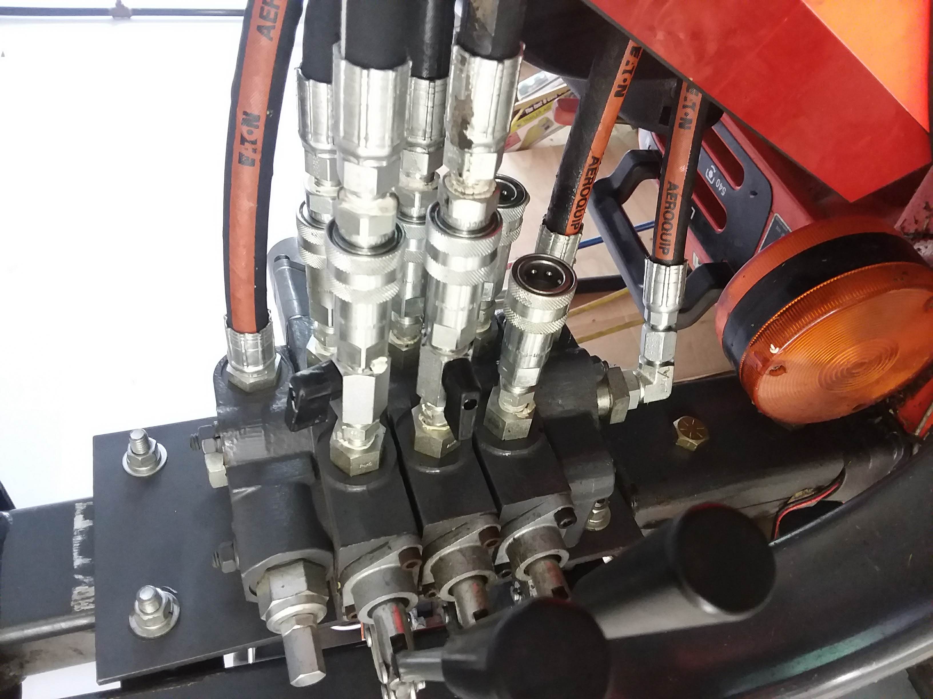

I'm on my 3rd tilt valve & my tilt cylinder still leaks down in under an hour. My toplink is ok & only stretches an inch or 2 over a few hours, after they replaced it once.

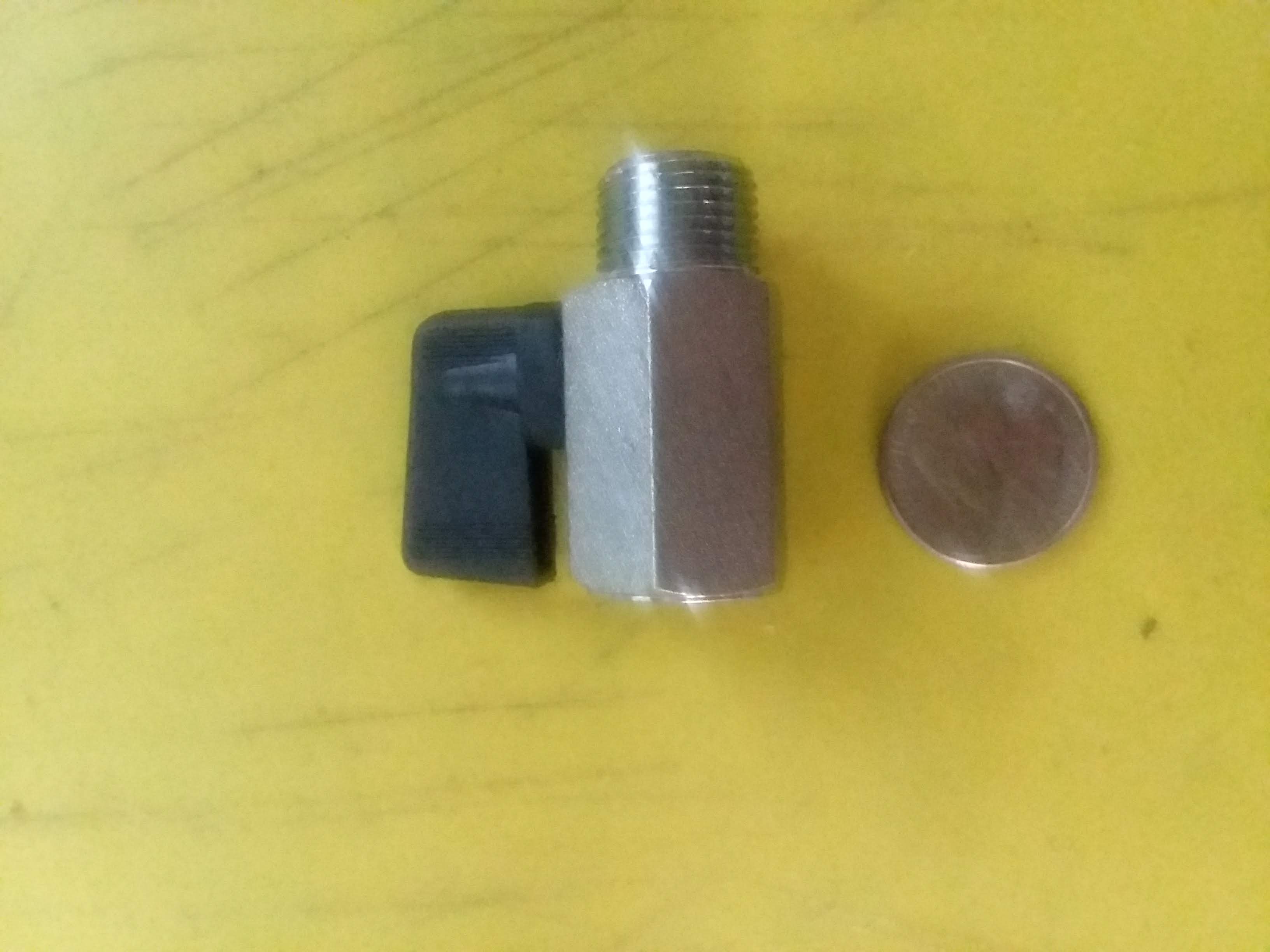

I had the same problem with my tilt cylinder, you can read this thread, post #14 where I calculate expected leak down for a valve. My solution was to put a miniature ball valve inline on the rod side of the valve. When I get the cylinder where I want it, I close the ball valve and then it doesn't matter if the SCV valve leaks or not. The valve is good for 2500psi, which was OK for my system. If you have a bigger tractor it's possible you're running too high a pressure and you'll need a bigger valve.
   / L4060 HSTC rear remote, where to buy?? #16
That is going to be my solution of last resort. The dealer got a decent (not greatl) valve on the toplink, so they do exist. A pilot operated check valve might be an easier option if I can get one. That would kill float though. I love float on my toplink, but dont use it on the sidelink that much.
The pressure would me the same for most any Kubota tractor. They are all rated at 2,500psi give or take. Tiny valve is fine assuming it fits on the hose with no adapters. I think the restrictors FitRite put in the hoses have holes the size of pencil lead or so anyway. My dealer was never able to get an answer from Kubota (or at least that's what he claims) on what their acceptable leakdown rate is. But he agrees the sidelink extending all the way in an hour or 2 is not acceptable. Sadly it's as low as half an hour to go from level to impliment dragging on the right side on hot days.
I came away surprised that even quality brand valves advertise leakdown rates that result in cylinder drops very close to what we've both observed in practice. For the type of valves we use on tractor remotes, the manufacturers claim leakdowns of .3-.8 in*3/min at about 1500psi and 120F. The cylinders we have generally have areas about 2 in*2 on the rod side. So at 1500psi that gives you a leakdown of anywhere from .6-1.6 in/min. If you scale that for the weight of a typical bush hog, you have about 75psi instead of 1500psi, so that gives a leakdown for our situation of .03-.08 in/min. So in an hour that is a range from 1.8 - 4.8 in, which is pretty close to what we both observe. I also think my fluid is hotter than 120F, I can barely hold my hand on the valve fittings, so that would make the leakdown even faster. I was convinced by a couple other guys on the forum that this kind of leakdown is just an unfortunate fact of life for cylinders with very small volumes of fluid being connected to normal service valves.
I find float on sidelink useful for back blade dragging snow or gravel, harrowing manure in pasture, landscape rake cleaning up branches. I did not think of all the reasons I could use it before I had it.
I mounted mine on the valve body.
Yes, it's very hard to get this data because they don't want you to be able to figure out what "normal" is. I'm not sure why the dealer feels that kind of extension is not acceptable in the absence of any information about leakdown rate. It's impossible to draw any conclusions in the absence of any data.
