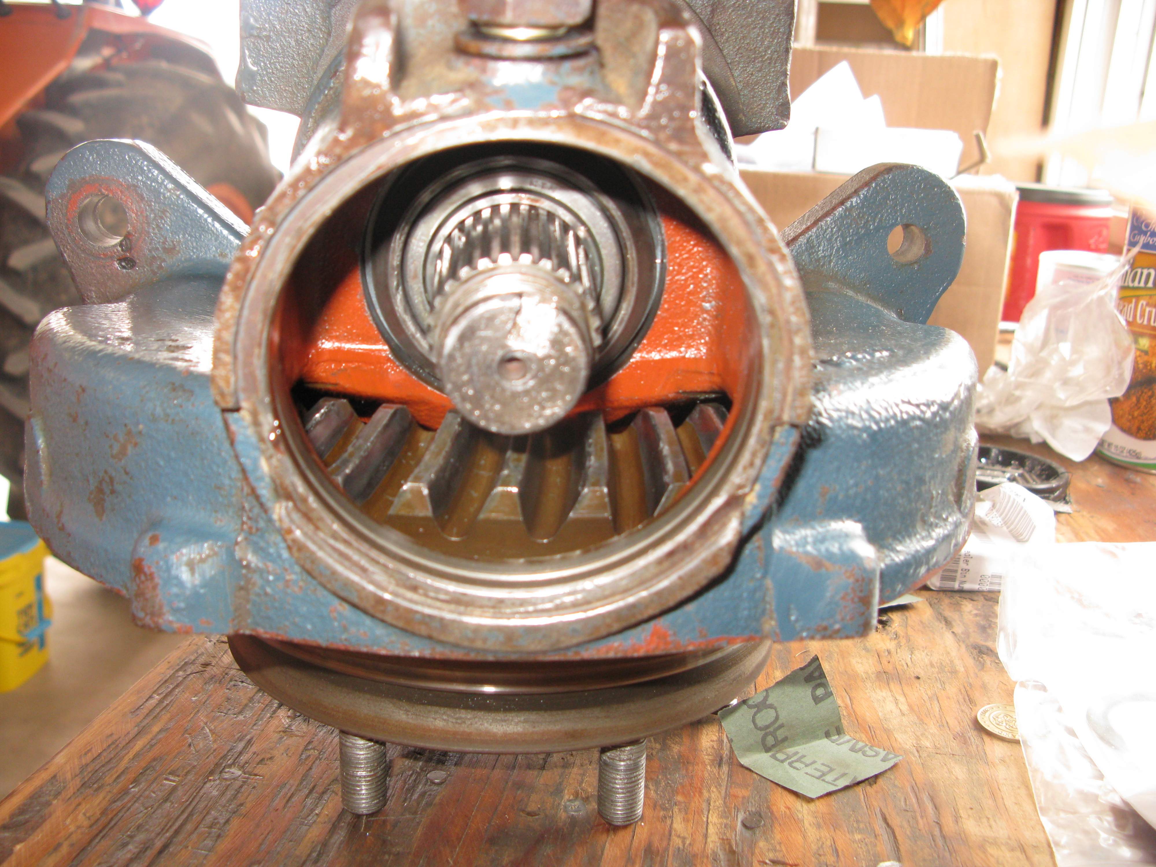

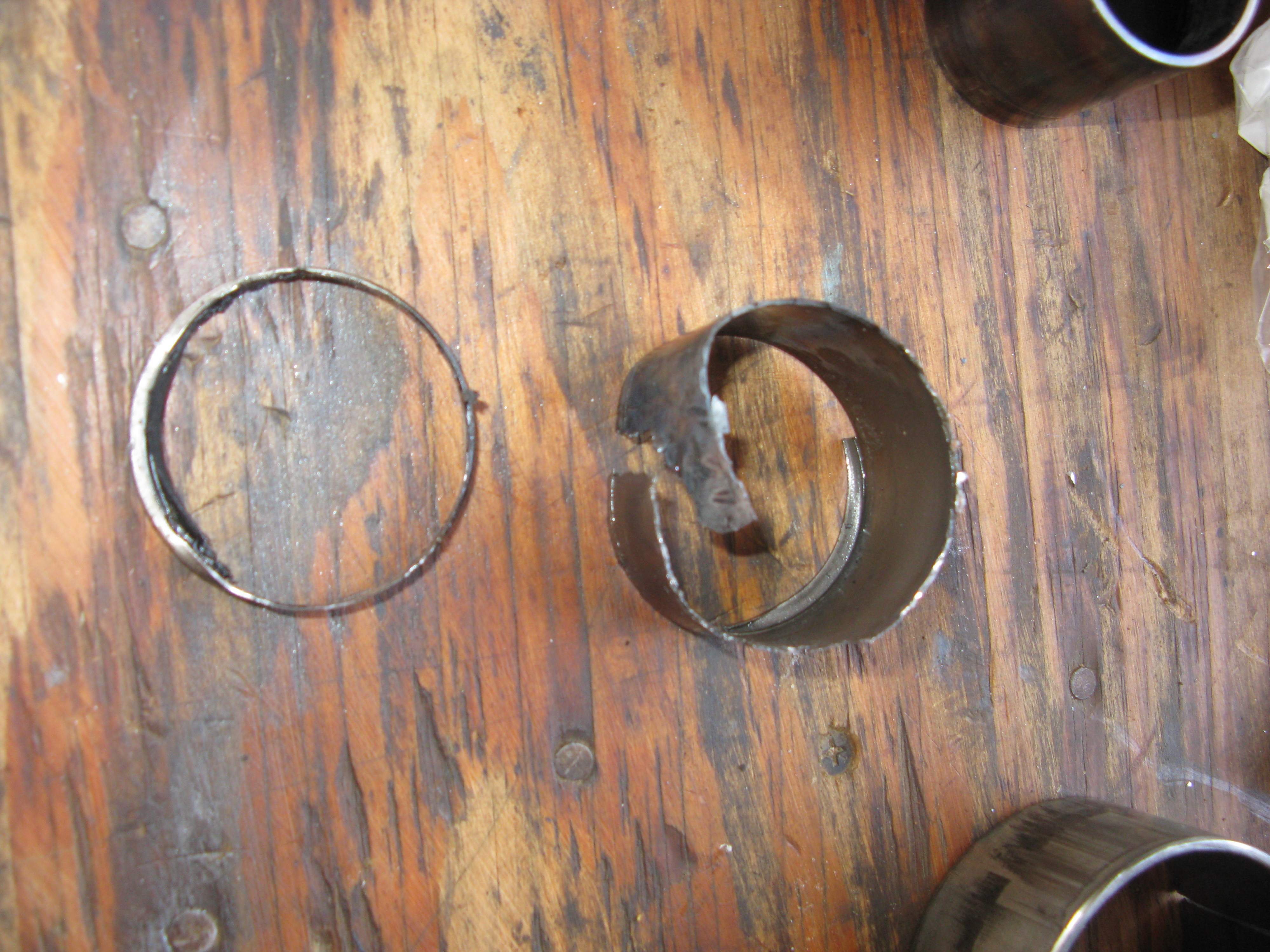

#27
:thumbsup:Got my parts in middle of last week and dove right in. Pressed out the broken/worn parts. Look what is left of the spindle bearing and bevel shaft oil seal!:confused2:Looks as it was caught just in the nick of time!
The second pic is the bevel shaft in place seated into new bearing and prepared for thrust washer and staking nut to be torqued. I torqued staking nuts on both ends of bevel shaft at 50lbs. My workshop manual didn't list a torque?:confused:50 is a good round number and it placed nothing in a bind when it was together. What a difference the new parts made. Shaft had NO side to side play and approximately .2MM play (up and down). It really went together well. Workshop manual called for gear oil pre-installed into needle bearing. I put a light coat of gear on entire shaft and massaged it together:thumbsup:

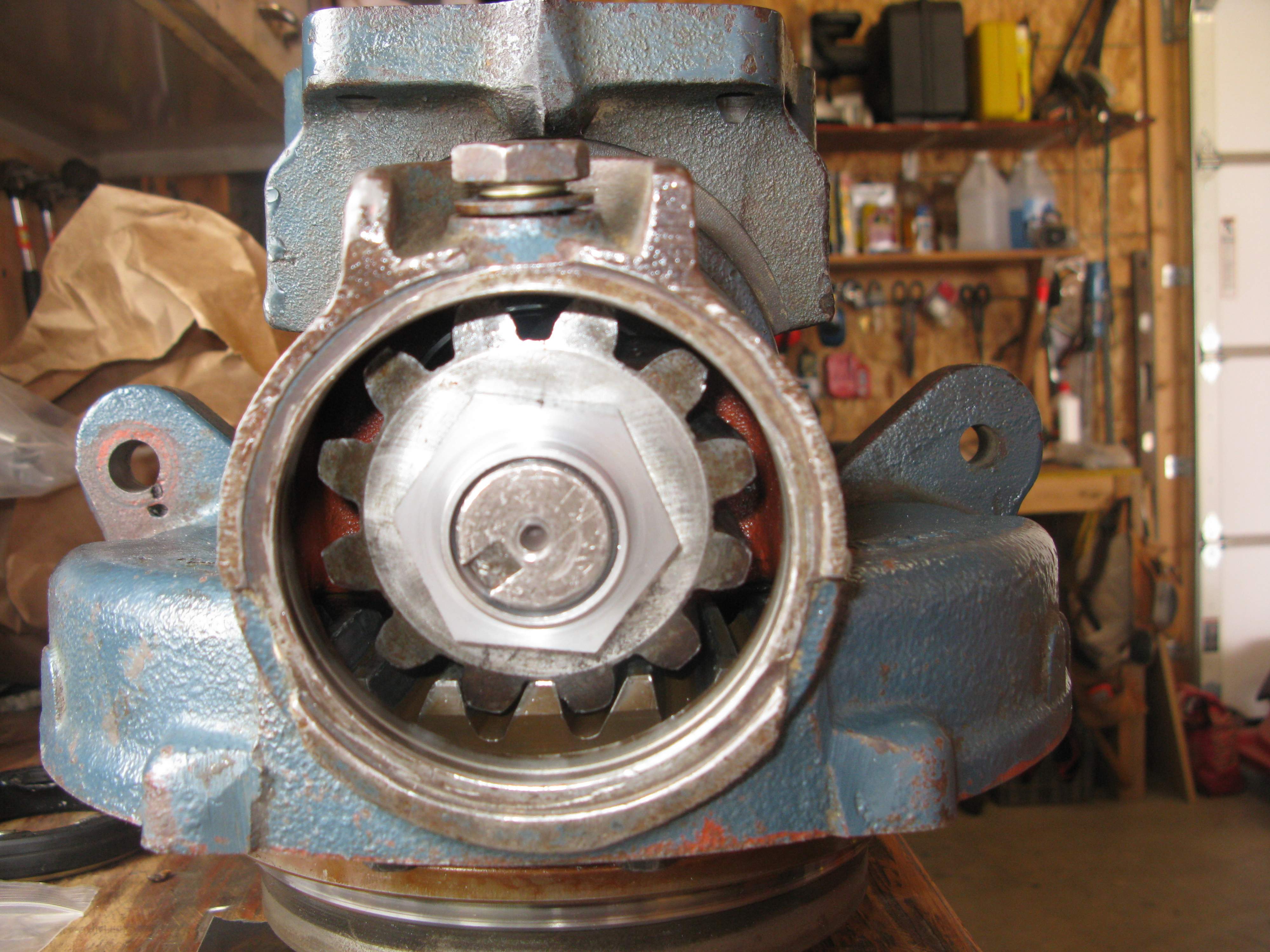

#28
Following is a pic of staking nut on top and bottom with snap ring in place. After placing snap ring in place I placed NEW cap on bottom of bevel gear housing. This part is now all together and extremely heavy to handle. After putting light permatex coating on all jointed parts to help out the O-rings. I stuck together pretty darn simple. JUST TOOK PATIENCE AND PUSHING IN THE RIGHT PLACES!:thumbsup::licking: And whalla, installed with rebuilt bevel internals:D Of course I will be patient with break in and drain oil after about 25 hours to inspect for break-in metal and replace oil. Something interesting about my oil. I used $$$$ Lucas $$$$ Hub oil cut 50% 80W. Since I'm draining in short time I will see how it held up?
Cannot wait for those 70degree temps and some tractor work!

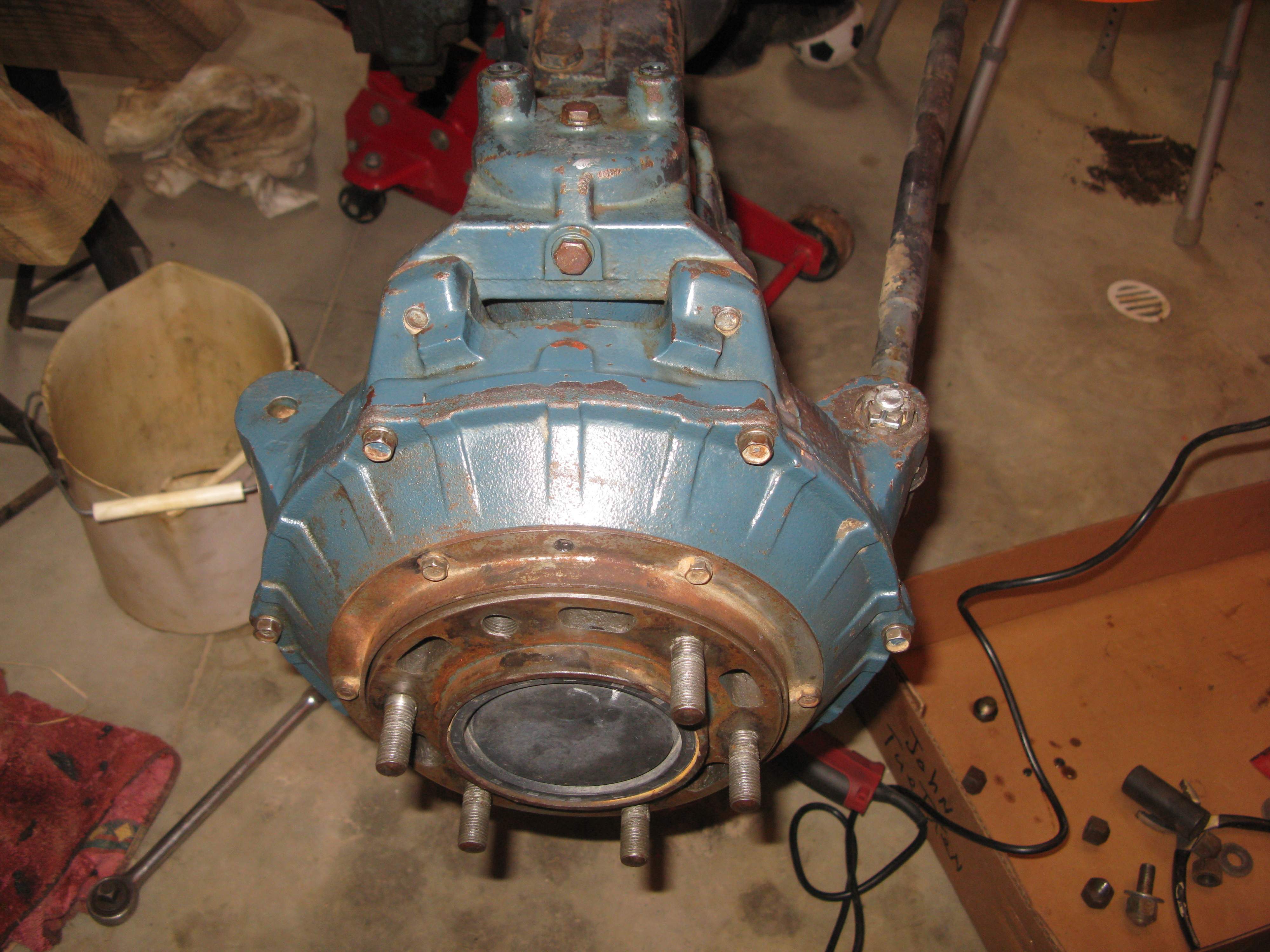

#30
Almost sick engineering. I made a shim the same diameter of the bevel casing and tried a puller. Pullers are about as dumb as a bag of hammers, when they don't work. After fighting it I took a small chain and put it around the bevel planetary housing 'hub' with a 8 ton jack on my heavier now shim. Put the chain around the jack and (made) a portable press :confused2:You cannot imagine how much pressure it took, mind you, this part should "fall" off. As mentioned prior, it had to come off! It did, it pulled the oil seal out of it's fitted area (was getting new one anyway). The hang up was simple, there is the peiced together bearing ? and the top of it had changed 'integrity' hanging the whole thing up. Probably from the heat and wear. A new complete bearing set is on the way as well. I am replacing almost everything in that bevel houseing pdf I posted earlier. I will quote someone from earlier, the smaller the part the cheaper, usually" so why skimp now with it all apart. It had been failing for quite some time. I reccommend to all, change that bevel oil in your Botas, oil is cheap and this is 'catchable earlier'. THAT BEVEL 'SPINDLE' PART IS A CAST SECTION AND IT'S $500 WITHOUT BEARING AND ALL THE INTERNALS.
I know this is long winded but it was a heckofa day.......
THE PIECED TOGETHER BEARING IS ACTUALLY THE TIGHT END OF THE THRUST BEARING! I LEARNED THAT ALONG THE WAY!;) IT HAD NOT CHANGED INTEGRITY, IT IS A PRESSED PART.
