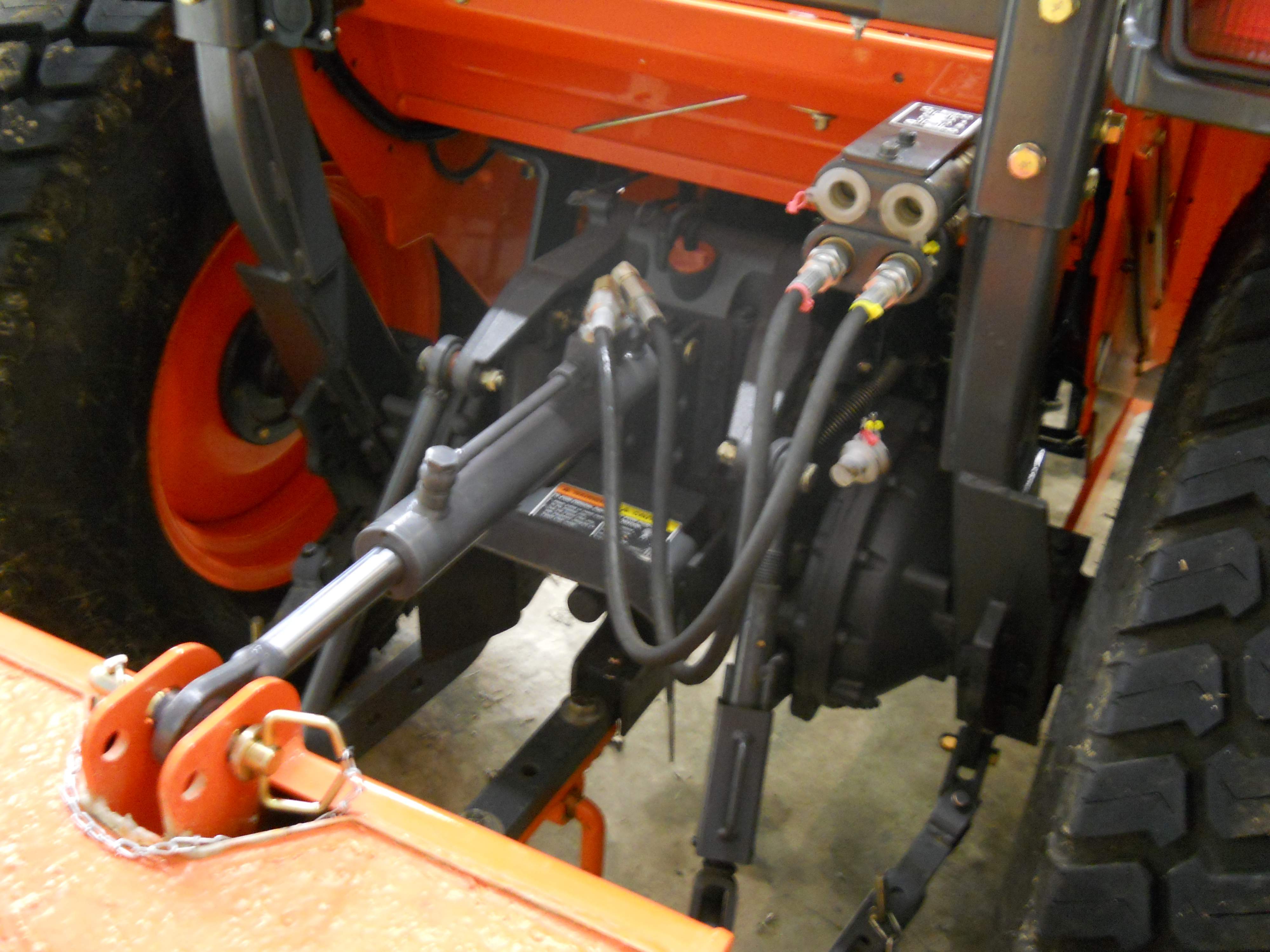

Sounds logical. I was curious because the non adjustable link has three pin holes while the adjustable one only has two.
There are some out there that have the 3 pin locations on the stationary link and only have 1 pin location on the adjustable link.
I almost always try to match the stationary link clevis for the side links that I build. ;)

I made the 12 volt power port so it is on all the time, before it would only work with the key on. Now I can hook a battery maintainer through it.
I removed the 20 amp fuse from the fuse box that said "cigar lighter." I got a fuse holder and put the 20 amp fuse in it. I used a scotch lock connector and tapped into the yellow wire(in the back of the fuse box) that went into the cigar lighter hole in the fuse box and the one side of the fuse holder. I used another scotch lock connector to tap into the big red main wire going into the back fuse box and the other side of the fuse holder.
Here is a pic of the back of the fuse box.
