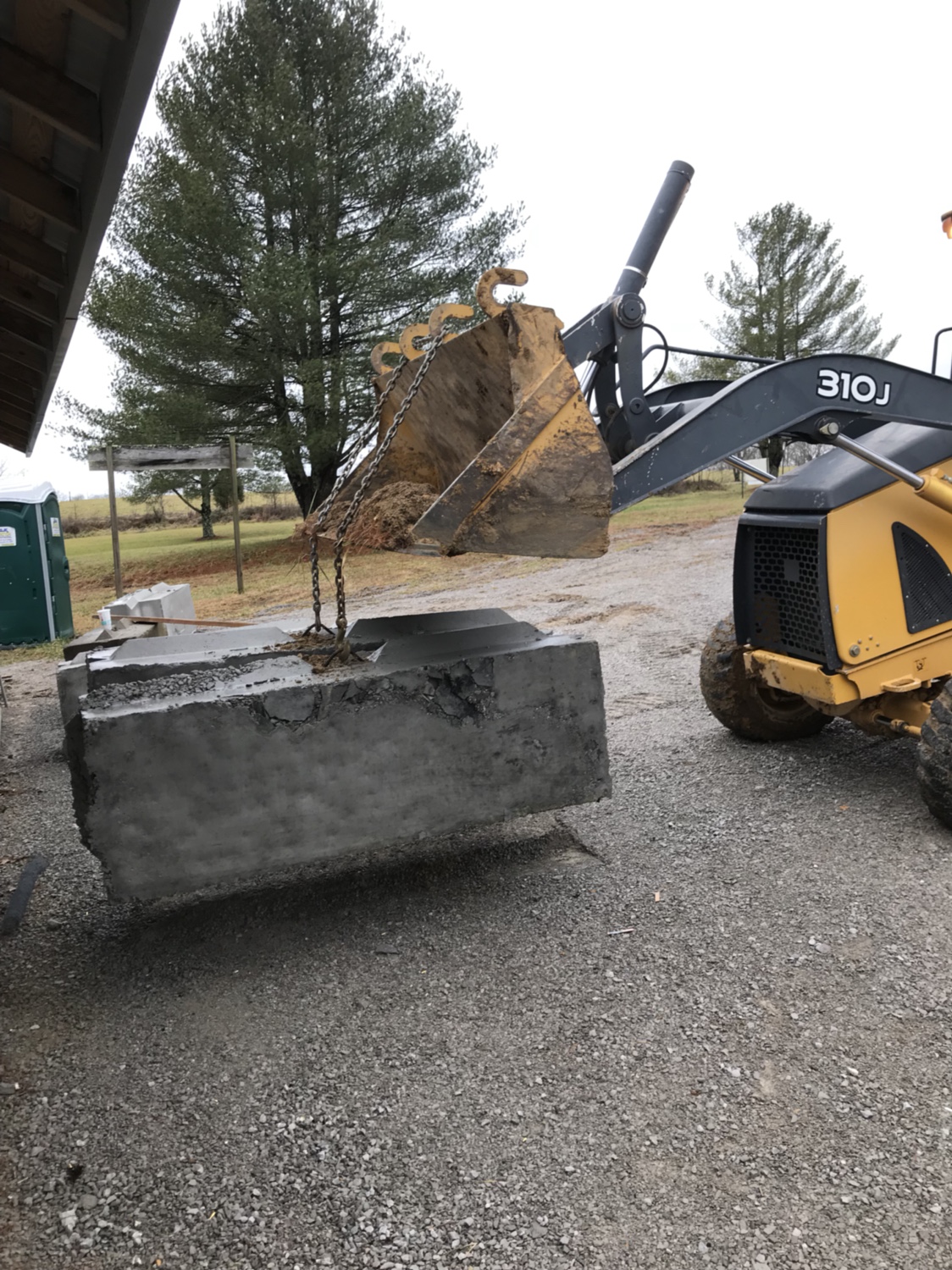

My 310 is rated for 9,300 pound breakout force at the bucket edge and 6,600 full full height lift at the pin. These blocks are 24 cubic feet of concrete each so that’s about 7500 pounds. It would lift them but I didn’t have the stability to handle them on that downgrade. I think it would easily beat the 6,600 pound lift on level ground. IMG_1040.JPG
