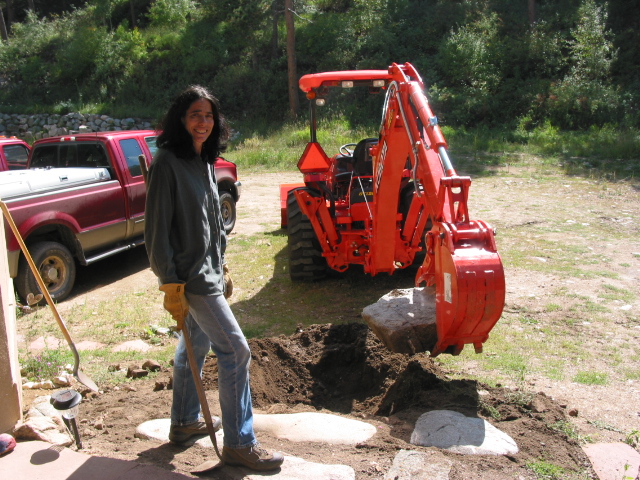

Here are some some things to think about for the first time tractor buyer:
Rear remotes for top and tilt. Very nice to have, but certainly not necessary. I'd put it on the bottom of the list. T&T is an an expensive option and still not common. That is because in in use, rear implements are traditionally adjusted for tilt manually and then the 3pt hitch control is worked to raise and lower them as needed for depth of soil engagement. That is sufficient, and manual adjustment works just fine. Put that money elsewhere. Into a grapple and thumb perhaps.
A front end loader should have a SSQA adapter for the bucket and front remotes. Then you can hook up anything that a Skid Steer can operate - which opens up a world of rental and borrowed equipment that you can try before or instead of buying. Front remotes are more useful than rear remotes and you are more likely to find them already installed on a used machine. Keep in mind that with hoses you can pipe pressure anywhere. Get a clip-on root rake for the front of the bucket for clearing brush. Inexpensive and handy. Keep your eyes open for a basic grapple that fits your existing bucket & plan to get it someday.... sooner if you have poison ivy.
Horsepower & transmission : For your land, go larger than 35 HP and get HST with as many speeds as possible. Both the L45 and M59 have plenty of power and weight. With the low gearing and 4wd, you will rarely use the full power of either one, but the weight is nice to have. I don't know what tranny the L45 has, but the HST+ on the M59 is fantastic. As you follow threads on TBN you may notice that experienced owners who are replacing tractors tend to go larger, rarely smaller. To me it seems that more are looking for features, comfort, stability and clearance than are needing more horsepower.
Tire size, ground, mud & snow clearance, & sidehill stability. You don't know how important these are yet, but you certainly are going to find out.
For clearing new land, these are the things that are going to limit the tractor more than any other one thing. The L45 is good in that department; but the M59 is better simply because it is larger and higher. More comfortable, too.
Cab - I wouldn't recommend it for a first time buyer doing the type of work you are looking at. You can always add it. Most owners do not.
Backhoe - a lot of people don't do much backhoe work recommend avoiding it, or getting a 3pt style, or subframe mount, or suggest renting rather than a dedicated backhoe.
Fine, but for what you are describing, you will be using the backhoe as a primary too. It will be used as much as the tractor will & possibly more. That's why I like the idea of the L45 and M59 for your use. Be SURE to get the 3pt kit. If the machine you buy doesn't have it, then order the specific 3pt kit for that model the day you get the tractor. Those kinds of specific kits aren't always available in later years.
The thumb? Well, if you have a use for a backhoe then you probably have a use for a thumb as well. I'll always have one. But you can get by without it by squeezing big loads of brush, or big rocks, or tree trunks between the bucket and the inside of the outer backhoe arm. In fact, that is exactly what everyone without a thumb does. You'll see that many backhoes have a wear plate on that arm and some even have teeth there. That technique works great for picking up things to move on the ground, but is quite limiting when it comes to deliberately putting the load somewhere. Especially when trying to place the load up and out at any distance - like building a rock wall or loading a truck.
Once you try a thumb it sure is handy. Mother Nature definitely got that one right.
Implements: start with a good back blade. It cannot be too heavy, they never wear out, so used is fine. Mine is heavily built - an old "Land Pride Rhino" with adjustable offset, tilt, and angle which came with end plates. It cost 3x what a lightweight blade does and worth it. The end plates turn it into a box blade. Your next tool after the back blade will be either a box blade with scarifier teeth for moving dirt or a 3pt rotary mower - the type that is PTO driven with a trailing wheel. Sometimes called a "slasher", it is used for for weeds & brush - not for the lawn. Your choice between the box blade or mower?but you'll probably end up with both someday.
Used machines: You often end up choosing between an ex-rental and a homeowner machine. I'd lean toward the homeowner myself, dealer second, rental last.
I am particularly impressed when there is at least an attempt at keeping maintenance records. I like to see OEM filters and oils used at a minimum. My feeling is that a tractor for a lifetime ought to come with some history and manuals. Unless you are a mechanic yourself, get a second opinion. Maybe even if you are.
And lastly, when you find the right machine, don't mess around. By now you have put in enough study to know a good deal when you see it. So when you do, make a deal and buy it. That's when the fun really begins.
Good Luck, rScotty

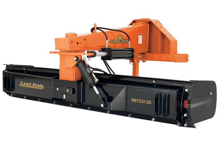

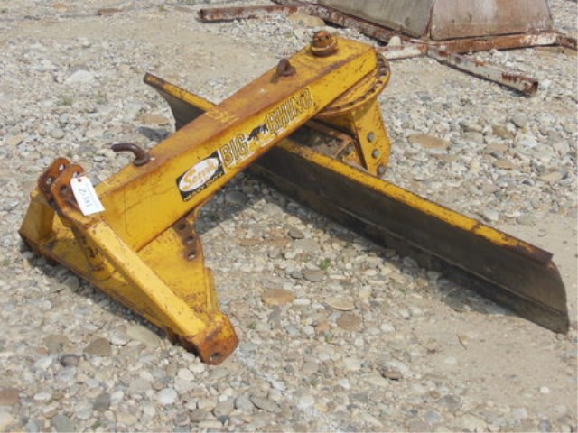

Does a box blade or land leveler make the back blade redundant?
I'm going to get a flail mower with a hydraulic offset. I need to mow along the sides of the driveway and the neighbors have a bunch of horses and I don't want to risk tossing anything into their fields.

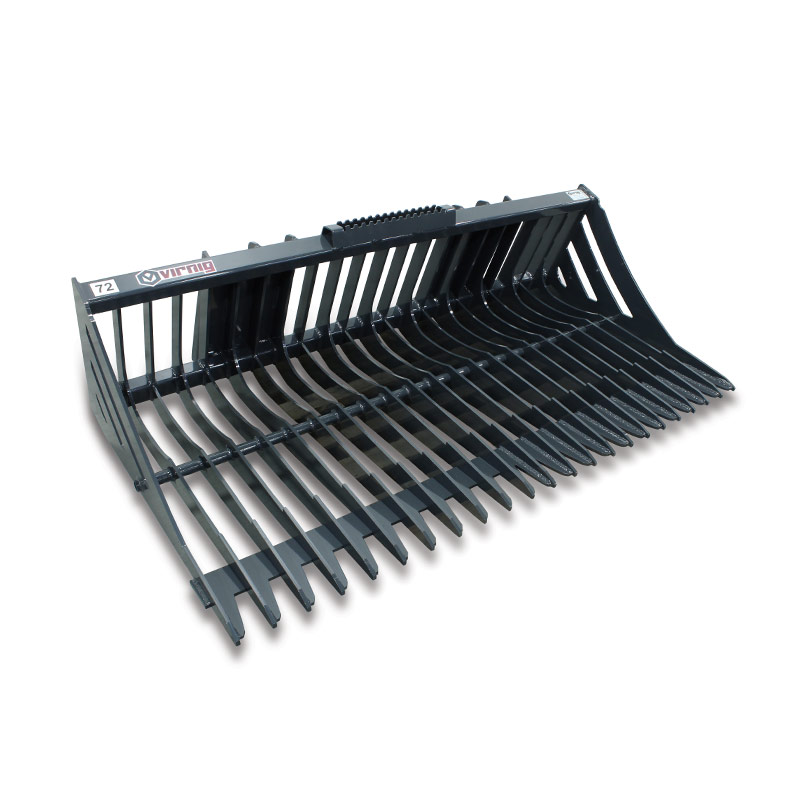

Do not get just any grapple. I got whatever the dealer had on the lot and regret it every time I use it. Get the EA Wicked Grapple
Yikes, that looks like something out of Mad Max.

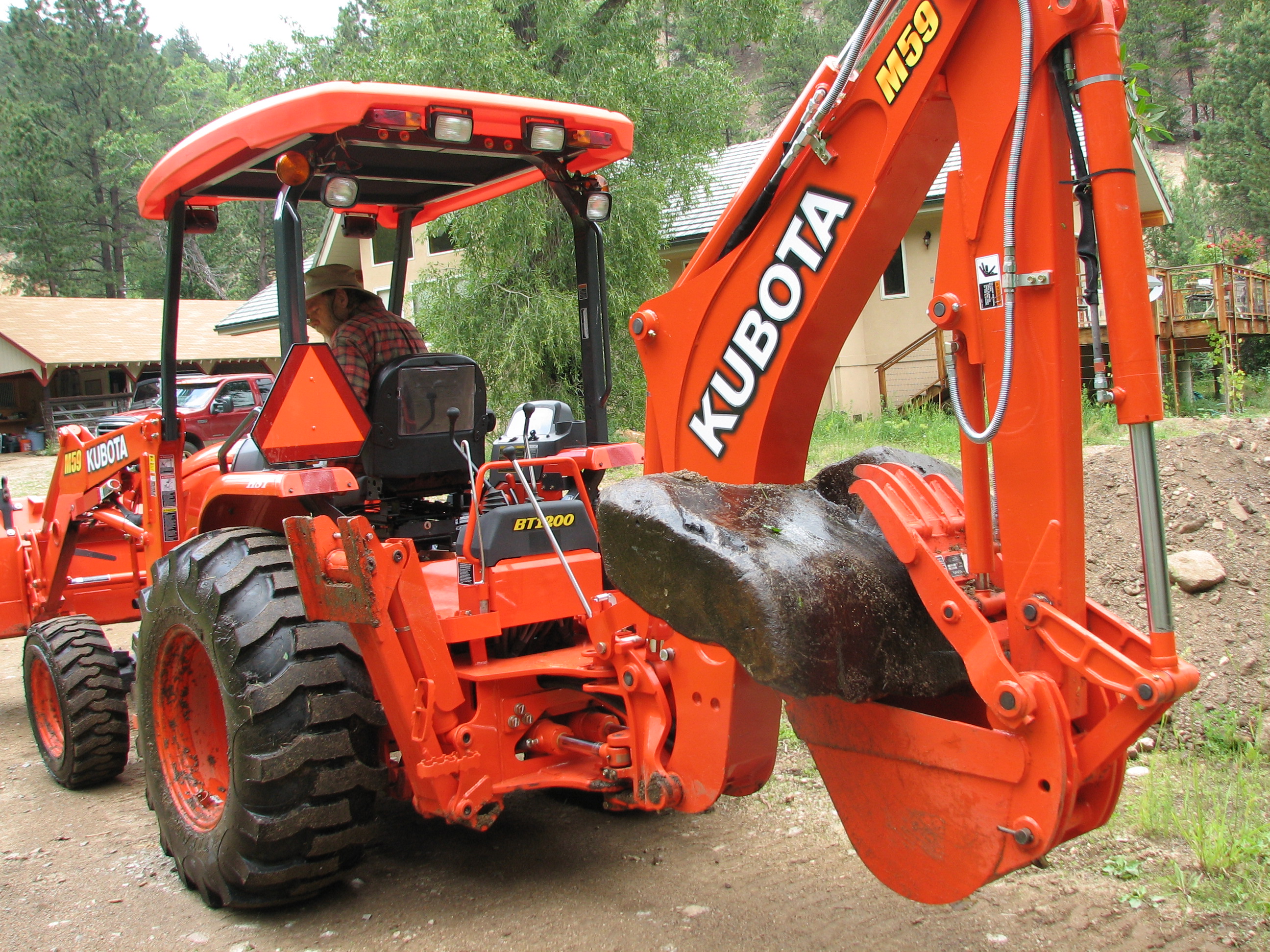

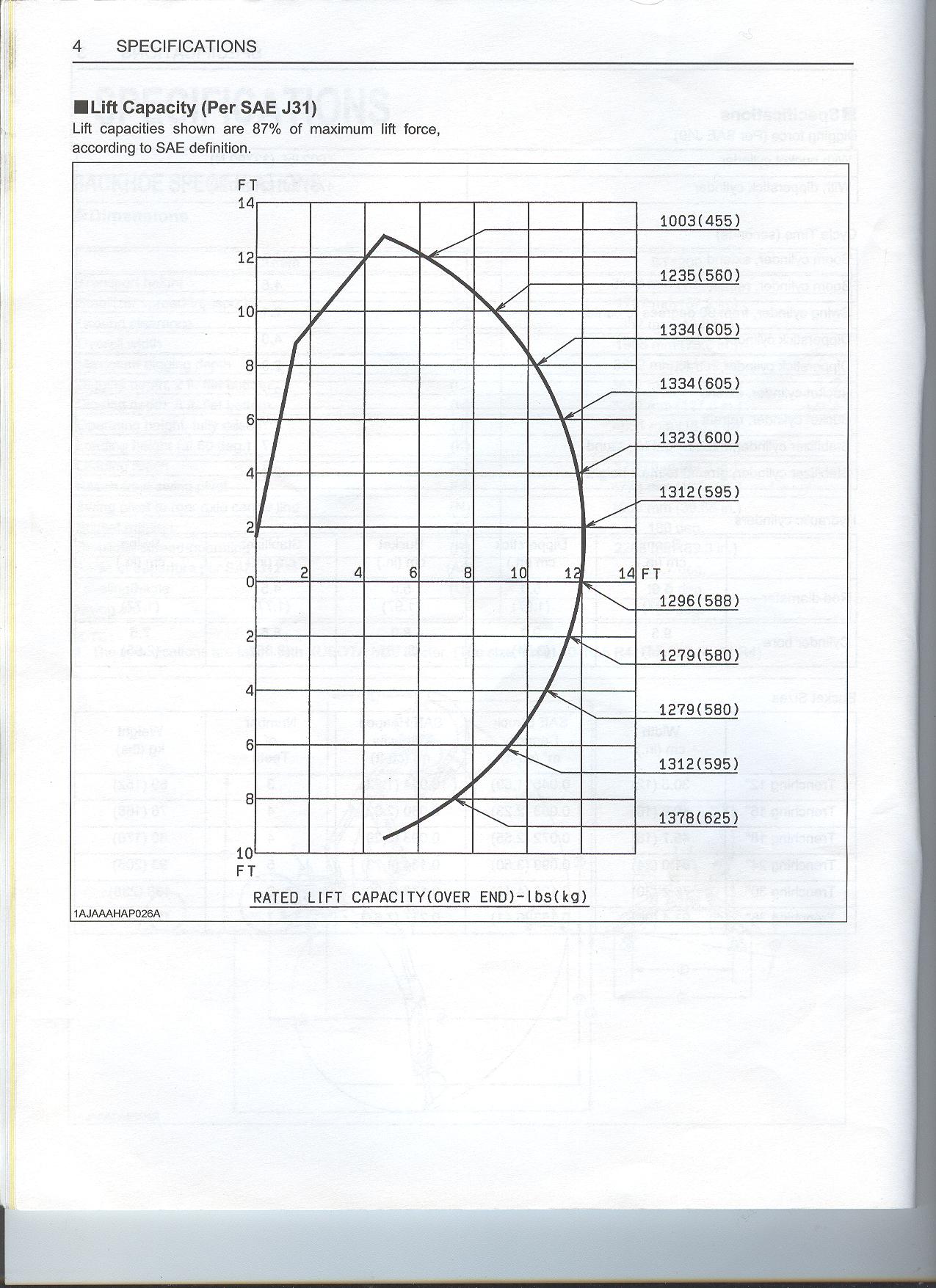

The loader will lift far more than the backhoe. The M59 loader will lift 4000 lbs at the bucket pins, 3000# at the midpoint of the bucket, and 2000# at the bucket lip. The M59 bucket holds about a cubic yard of material - which will vary from 2000 lbs for dry dirt to about 3000 # for wet sand. The smaller L45 bucket should be sized for it's lift, but I don't have the specs. I'll attach a graph of the backhoe capacity for the M59; it will lift about 1300 lbs. Digging downforce is much higher, and the backhoe has no problem lifting the entire tractor while pivoting on the bucket lip.
T&T is nice, but I still say not essential. Where I would want it is if I were doing a lot of work scarifying or box grading. A mower or snow blower is usually just a set and use adjustment....not something you constantly adjust angle or tilt. Remember, the geometry of a standard 3pt keeps the implement level when you lift and lower it. If it were me, I'd get the rear remotes over the T&T.
Box blades and the land levelers do not normally have any provision for tilt, offset, or angle. Basic lightweight back blades will angle, but not tilt or offset. A heavier duty back blade has those adjustments and the best ones do it hydraulically - if you have rear remotes. A really nice back blade with rear remotes working the hydraulic adjusters will do far more. It is a real road builder which will build the crown and ditch as well. Add the removeable pin-on end caps that are options on the better back blades and it will also do the job of a box blade or land leveler. But those nice back blades are as pricy as they are nice to have. I'll attach some pictures. Used implements are just as good as new ones - and sometimes half the price. They don't drop below that price very often. The M59 can just barely handle an 8 foot Big Rhino.

Stumps are time-consuming even with the M59. In fact, they aren't any more fun with the bigger JD310 with AC, 95hp, and a cab with music. A two foot trunk may require a hole ten feet across and 5 feet deep. I've never done a 36" one. Breaking through the roots is hard on the machine and operator as the tractor bounces around. If there is a taproot below the root ball then things get even worse. Resist the impulse to pound on the stump - they rarely split & really abuses the hoe. Just chew away. You have to dig an astonishing hole before the hoe will lift the root ball. Wish I had better news, but I just haven't found a better way than simply going slow and digging them out.
Pros sometimes excavate on one side of a tree and then push it over - popping the root ball free of the ground. That takes a dozer....., and it doesn't help if you've already got stumps. I've got a few dozen stumps yet to go and not looking forward to them.
